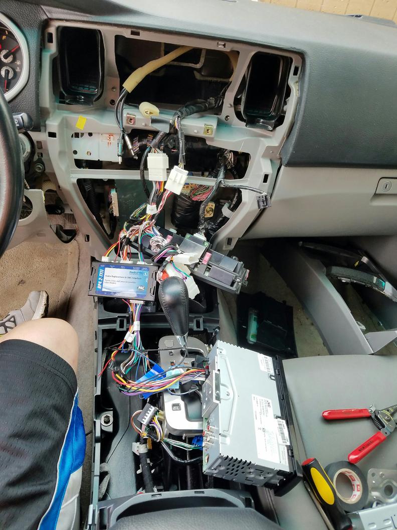

Installed a single din JVC headunit, still got steering wheel controls, got bluetooth, padora, iheartradio, hands free calling, usb and aux port for $165.

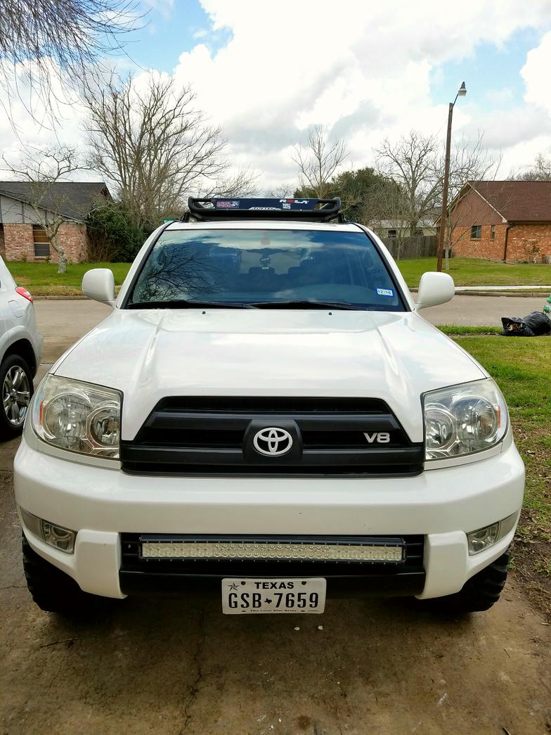

Found these pack of 12 white led "rock lights" on amazon. Aluminum, pita small wiring, easy to mount using existing holes, bright enough to light up the ground beneath you, all for $14.
Nice. Just got the same ones as a gift. My buddy mounted them on his 3rd gen and they look great. I'm laid up with a broken leg, so I can't do anything right now... Interested to see where you mount them.
My buddy has these on his 3rd gen Tacoma, after I seen them I had to have them. Mine are already mounted just not wired yet. I will get pics up of how I mounted them. Only had to make a mount for 4 of them using metal band straps with pre drilled holes. Sorry about your leg

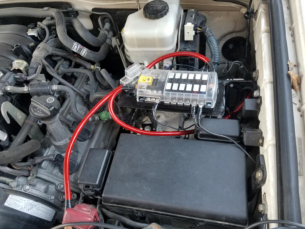

Roof rack and blue sea fuse block

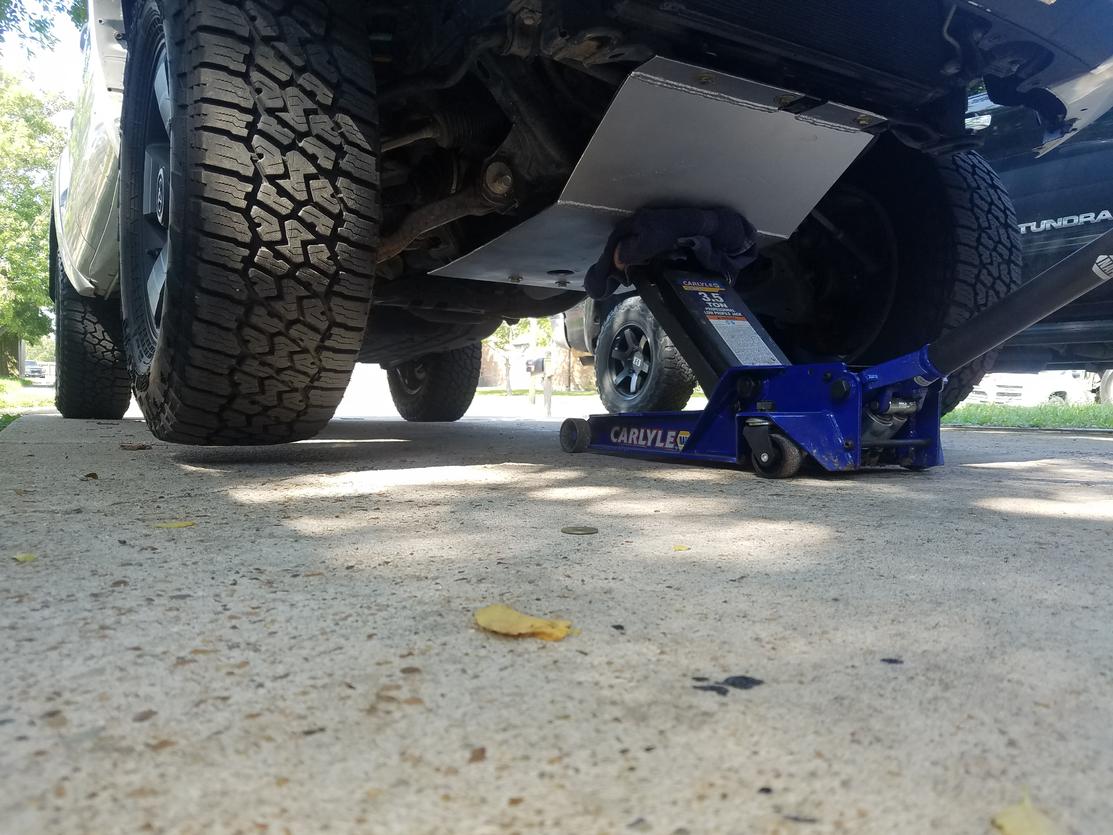

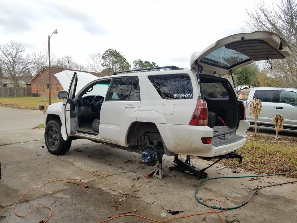

Built my skid plate using 3/16" steel plate and gussets in the middle

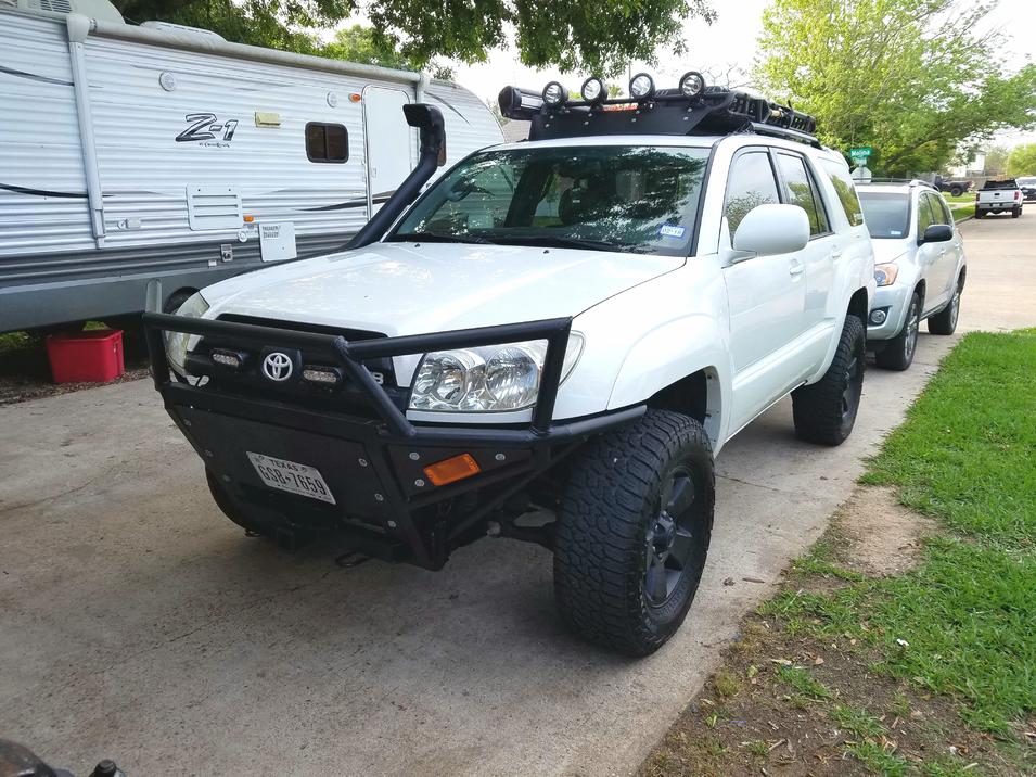

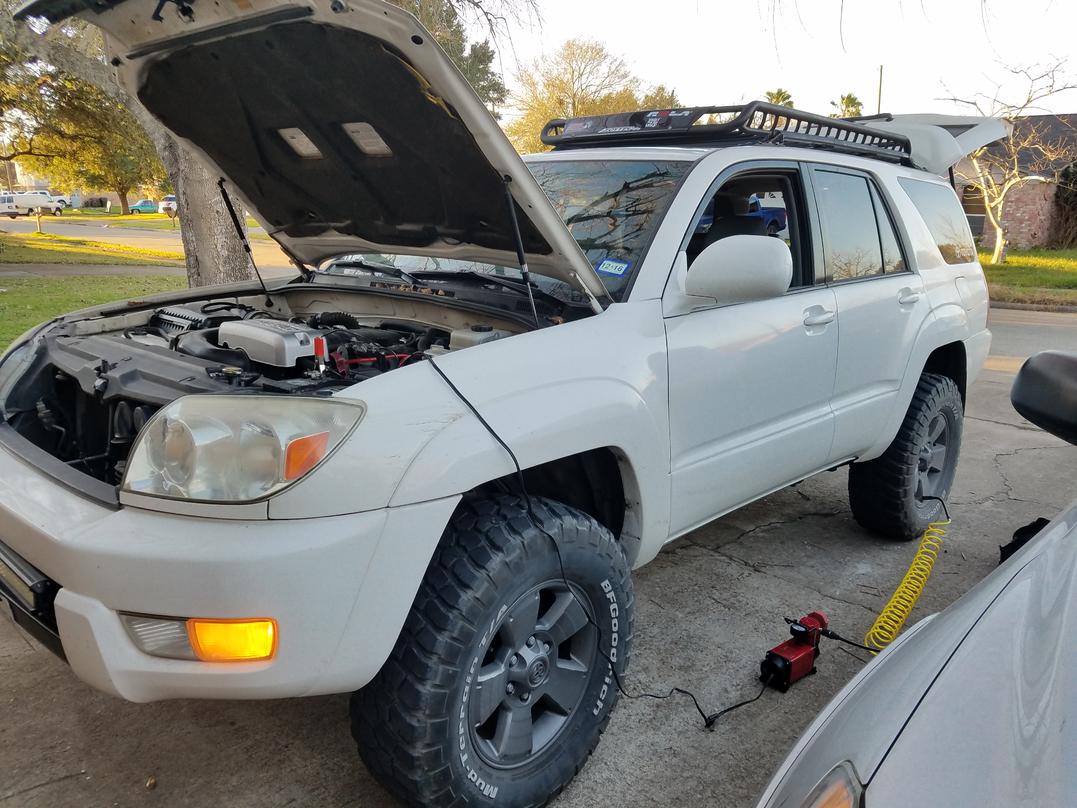

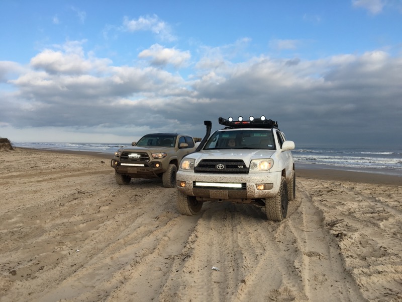

Few updated pics, 265/70/17 Falken Wildpeaks, smittybilt awning, snorkel, curt front hitch receiver, roof lights, Boar traction boards and pelican all weather case for recovery gear on roof rack

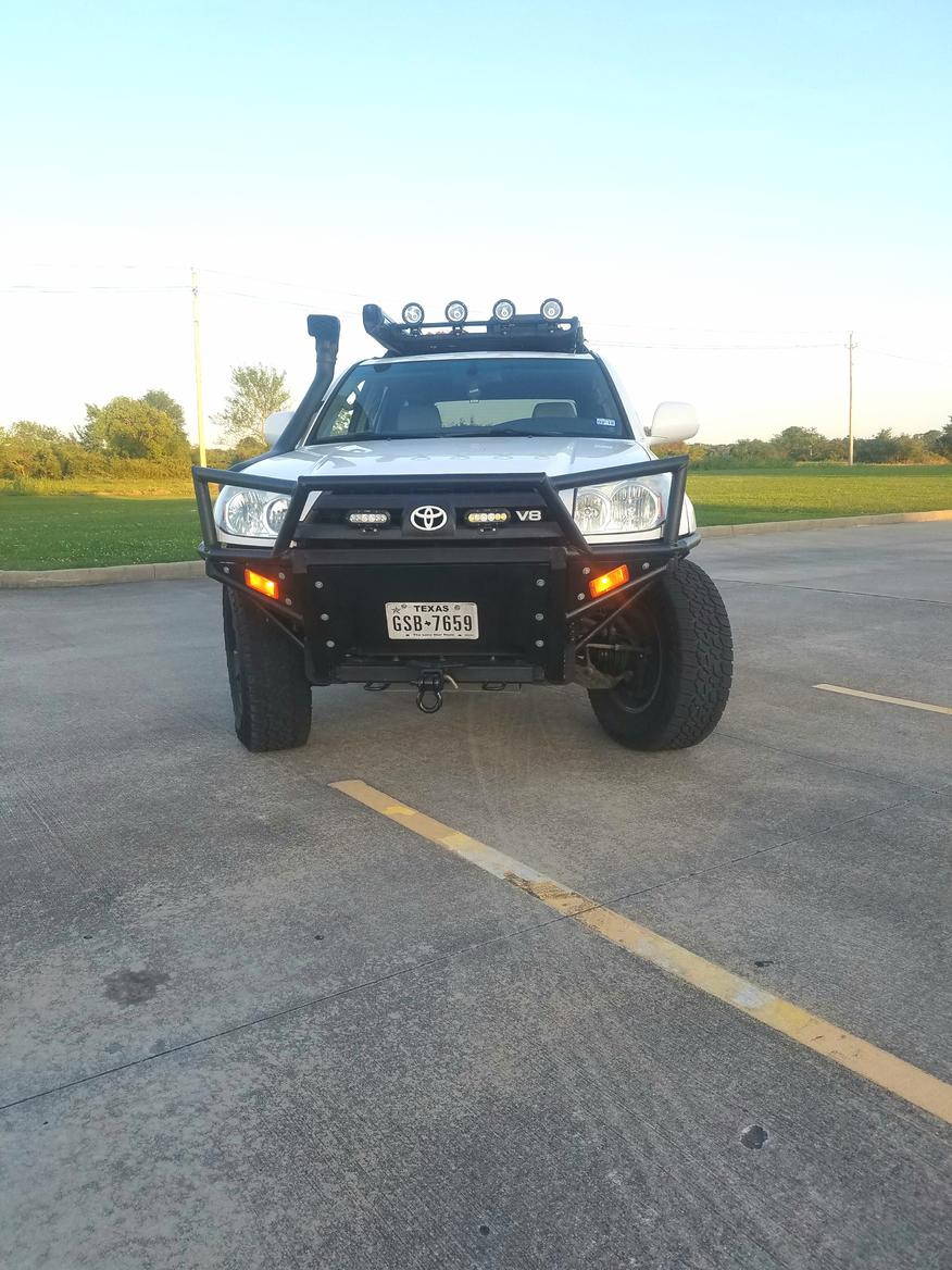

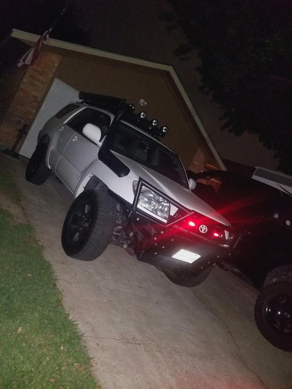

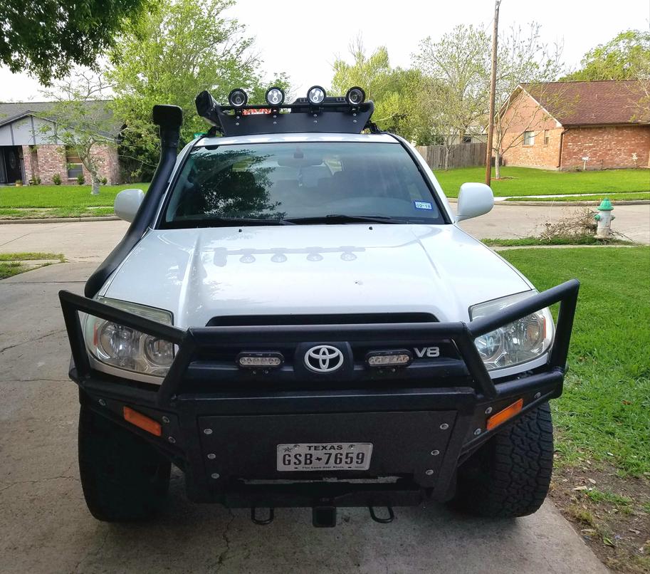

Built my front bumper.
Built off my Curt front hitch, all tubing is 1/8 inch thick including plate, brushed on bed liner and used jeep wrangler blinkers for my turn signals.
Total weight: 120lbs.
Total cost: ~$300
Got my wind fairing built for my roof rack

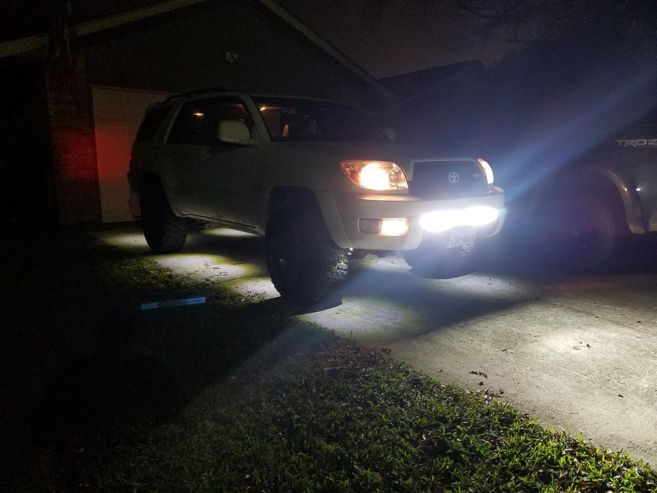

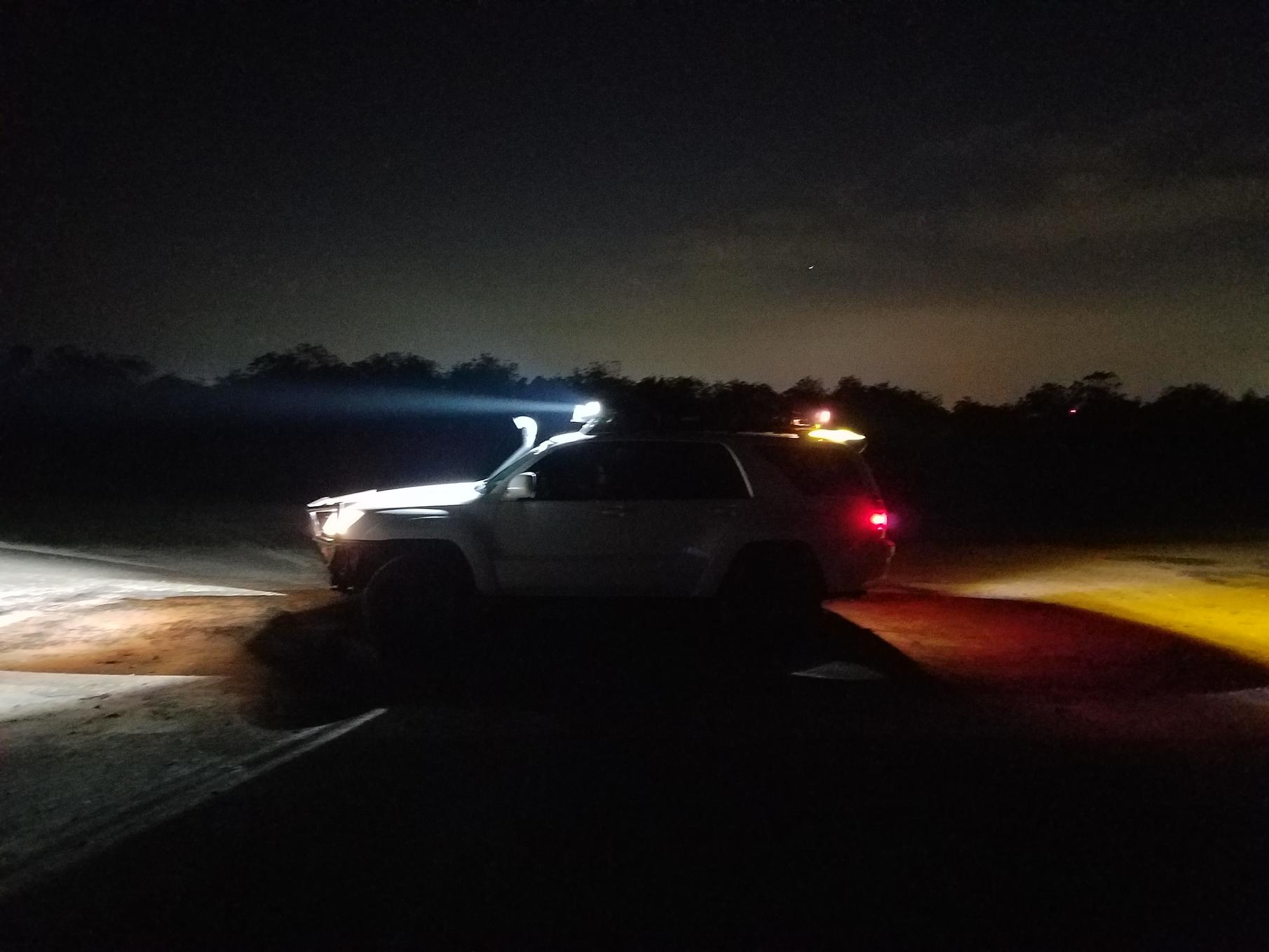

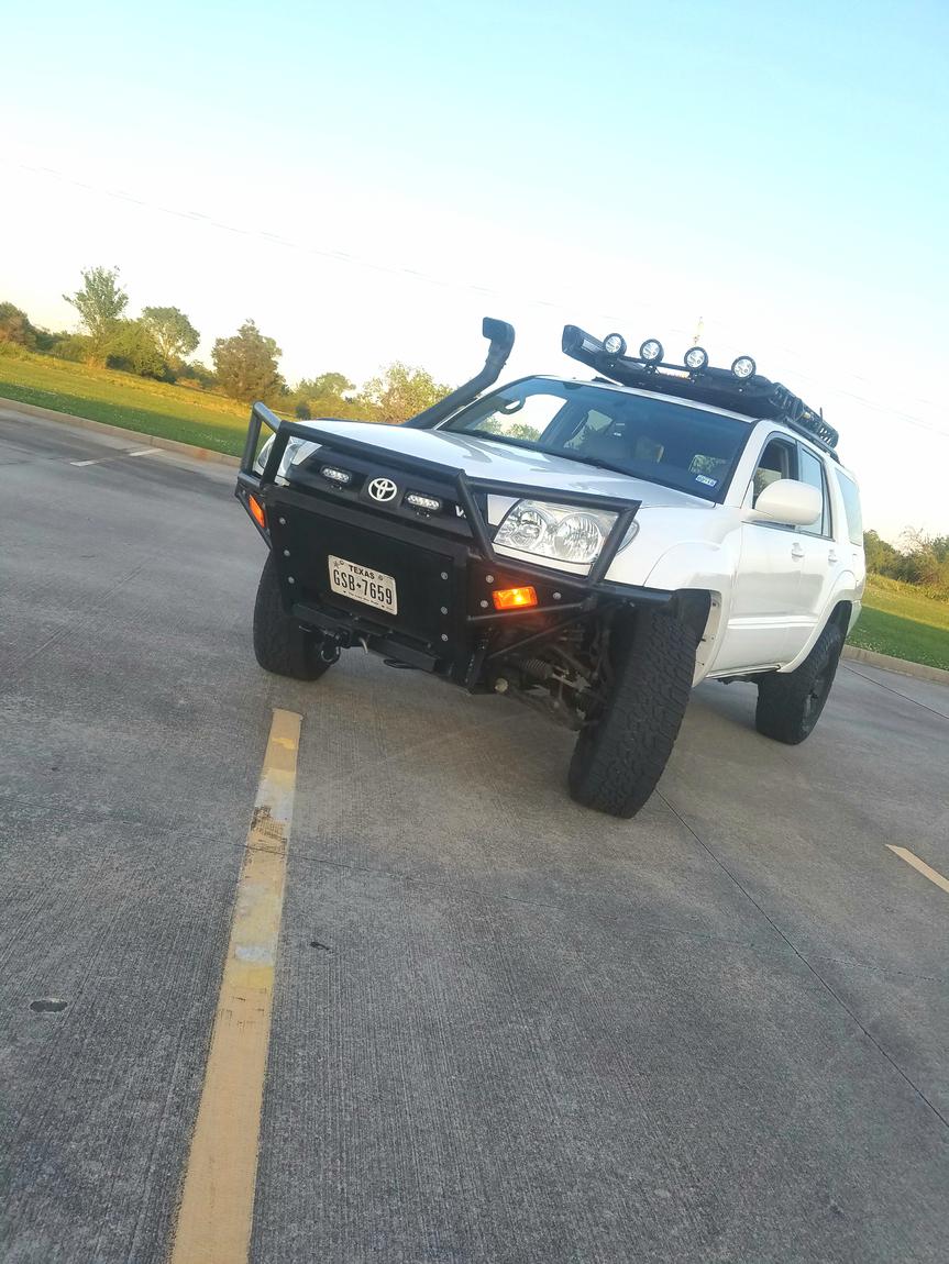

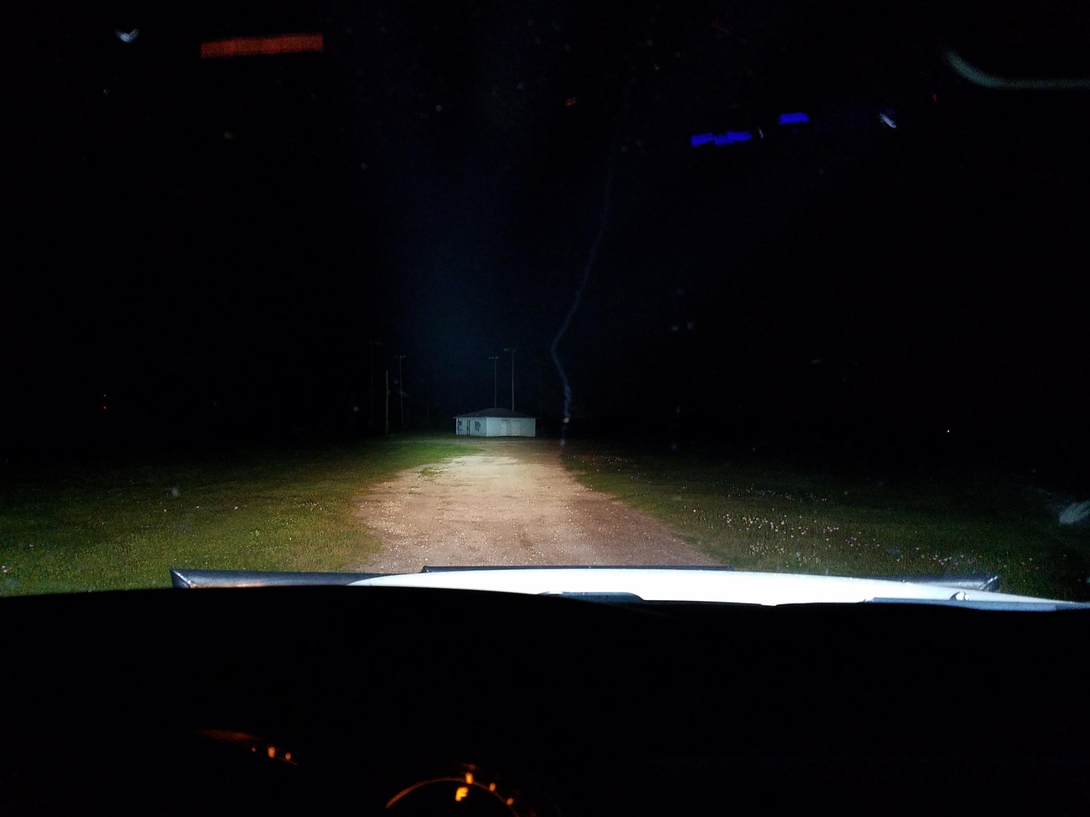

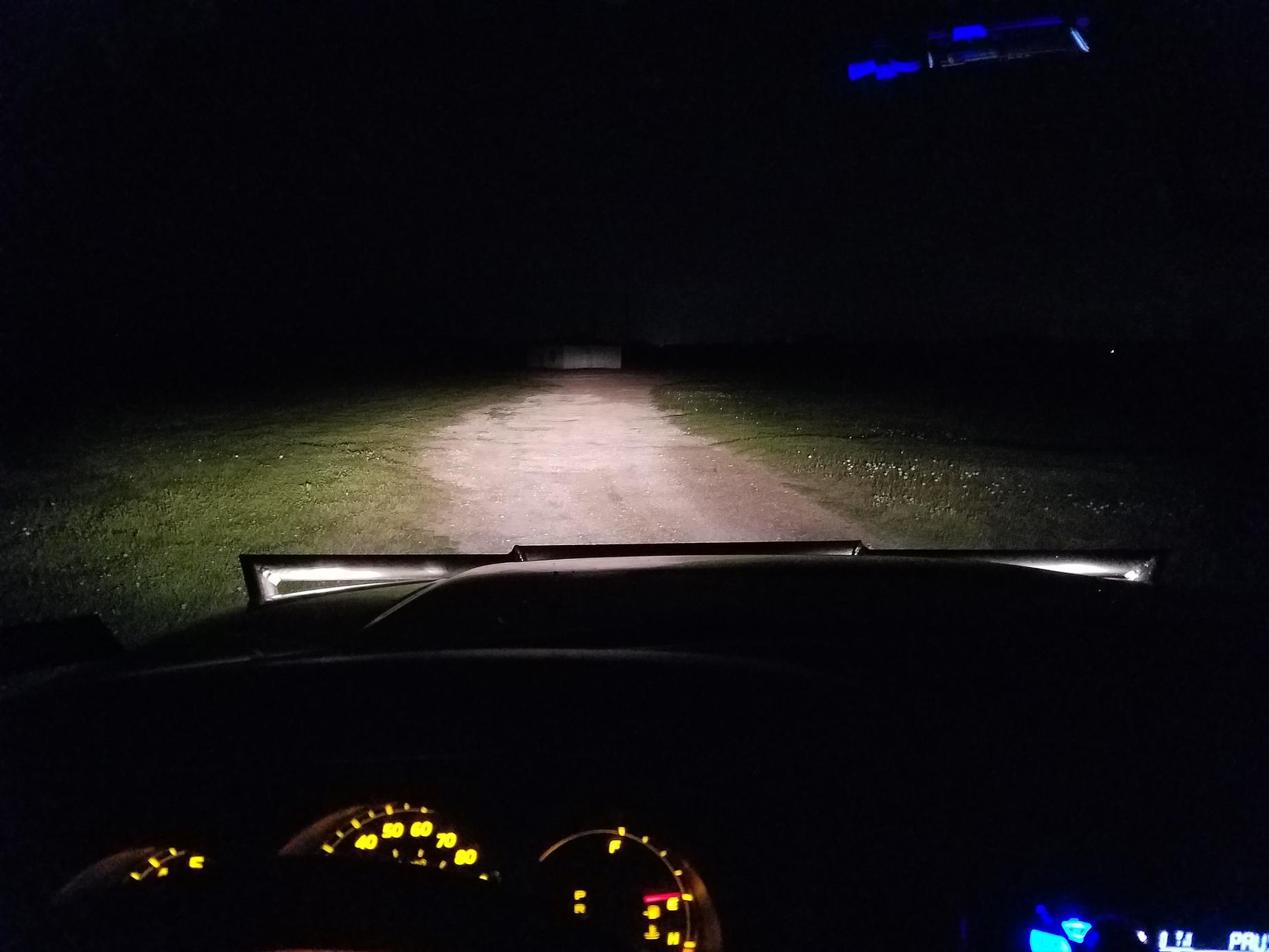

Got my rear lights hooked up yesterday and went tonight to adjust them and my roof/grille lights.
Second pic: Headlights Only
Third pic: Headlights and Roof lights
Loving the build so far! I've got some PIAAs that I'm putting up on the roof. I'm wanting to mount them to my rola and wire them myself. You got any good tips/suggestions? Also, how'd you make that fairing??!?! It looks great and I feel like I'll need it.
Thanks!! And I welded some tabs onto my rack to mount my lights and ran the wiring down the side of the windshield channel and under the windshield cowl so I didn't have to make any holes.
I made the fairing using metal band straps with the pre drilled holes for the brackets and bolted them to my lights. For the fairing I used 1/8" lexan sheet.
Here is the DIY write up I got the information from. http://www.toyota-4runner.org/4th-gen-t4rs/152650-diy-roof-rack-fairing-whitson-metalworks.html
