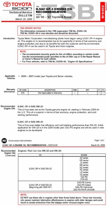

Toyota made the switch in Apirl 2006 from 5W30 to 5W20.
applicable to MY06+ Toyota
5w20 weight oil is used for fuel economy reasons. Use the viscosity recommended and certified for your model and year vehicle.
