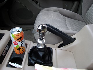

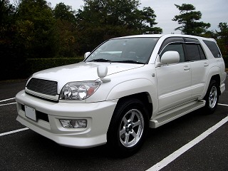

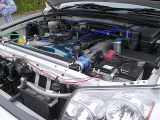

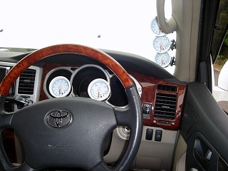

I have seen a trans swap like that on 4th gens but it wasn't with the 1grfe. I think it was used with a 1 or 2jz engine. I'm sure it'll work but it would take patience. you might have to compensate if the six speed is longer or shorter and check the geometry.

Skyline...... dman that's nice. Must be in Japan though, rhd. If anyone has more pics, or knows someone who has done it, it would be appreciated. Thanks.
