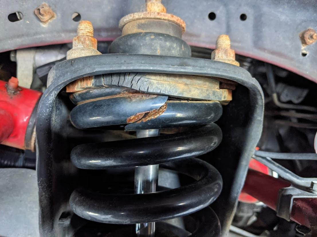

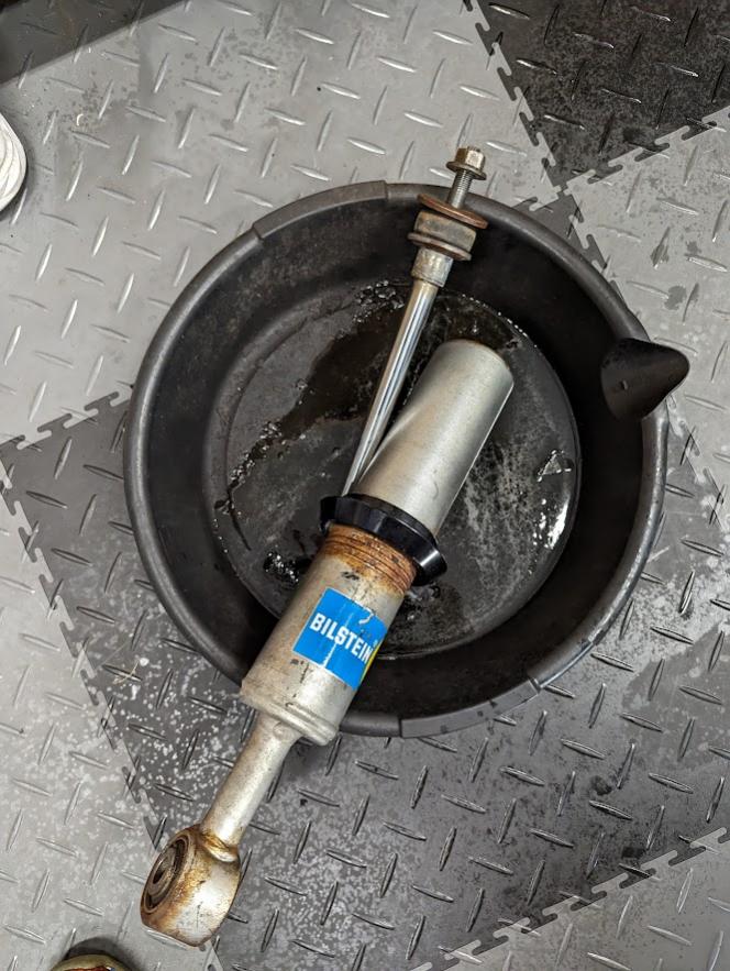

Save your money they are garbage. I had the 6112/5160 combo, the rear shocks blew around 20K miles, one of the front springs broke around 30K and most recently, I went to change out the strut mounts and the shaft of one the front strut unthreaded from the body, making it totally useless.

Not the best of reviews, could you elaborate more on your experience? Driving conditions? Both rear shocks blew? actual shock or reservoir leaking?
Just normal street/mall crawling, nothing out of the ordinary. And yes both of the rear shocks were toast not just leaking. I noticed the rear end started to clunk going over bumps so I took off one of the shocks to inspect. It compressed with almost no effort and did not return at all. The front spring just broke out of nowhere, no off roading incident, pot holes, etc. There was a little rust forming on it but nothing out of the ordinary for a 5ish year old set up. Bilstein did replace both of them under warranty but the process was not easy or quick.
