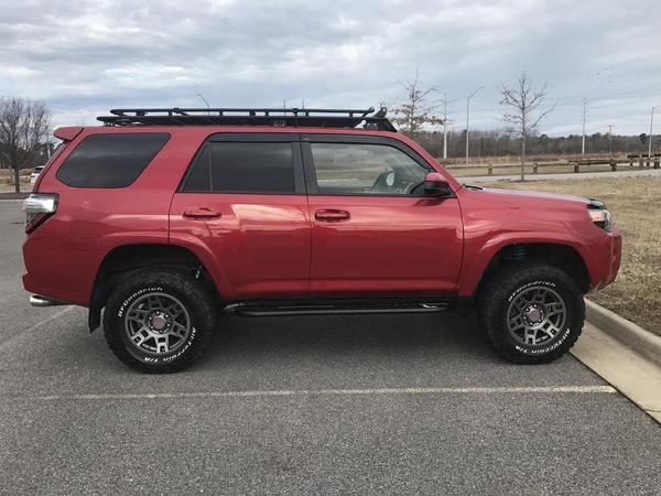

Maybe my experience will help. I have a 2019 ORP w/KDSS. I have sliders and a roof rack that doesn't weight much. I have Bilstein 6112s in the front set on the 3rd circlip for a 1.75" lift (600lbs coils). In the back I went with Bilsteins 1" coils and Bilstein 5160s. I have stock size KO2s. I feel like I got more than 1" of lift in the rear and it does ride a bit more stiff in the rear. My after lift measurements (hub to fender) are 20.75" front and 23.75" in the rear, so that's like 3" of rake. If I was to do it again, I think I'd leave the stock rear springs and get a more level look and possibly ride more comfortable.

Yea, the part number for mine is 36-281817. Bilstein, on their site markets them as a 1" rear lift. I just checked Wheelers site and they market them as 1"-1.5" lift. The one that you're referring to at 400lbs constant load is for part number 36-281831, "provides approximately 1.5" lift with a heavy constant load of approximately 400lbs."

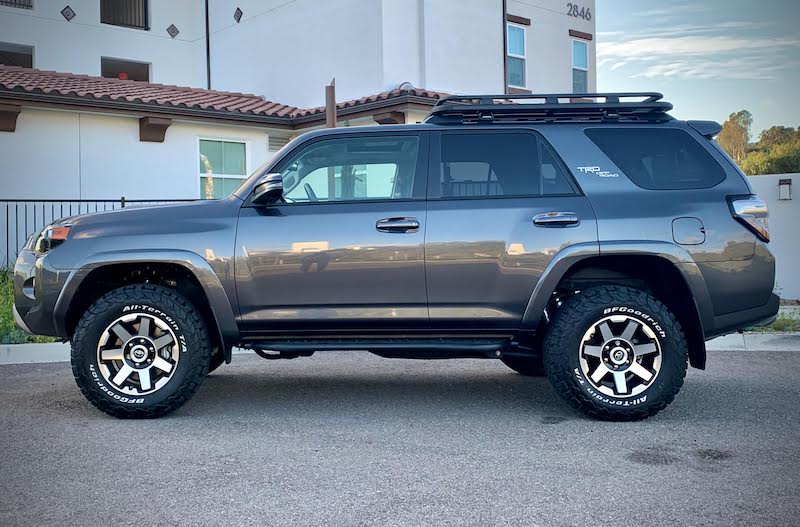

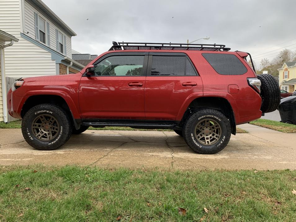

Dobinsons has a front coil C59-748 for the 6112s, which is an inch higher than the Pro coil, set to the bottom clip.Then match it with the rear coil C59-599 which lifts it 1 to 1.25 inches. Those coils should be able to handle the sliders and skid. I used the 5100s paired with 302 and 505 coils for a 2.5 and 1.5 inch lift. The picture with the graphite wheels has 265s, but now have 285s on FN Pro wheels, with skid, sliders, rack, full size spare E Load, tire carrier, ladder and third row. The coils make a better ride with 5100s, so I can only imagine the 6112/ 5160s will out perform.
