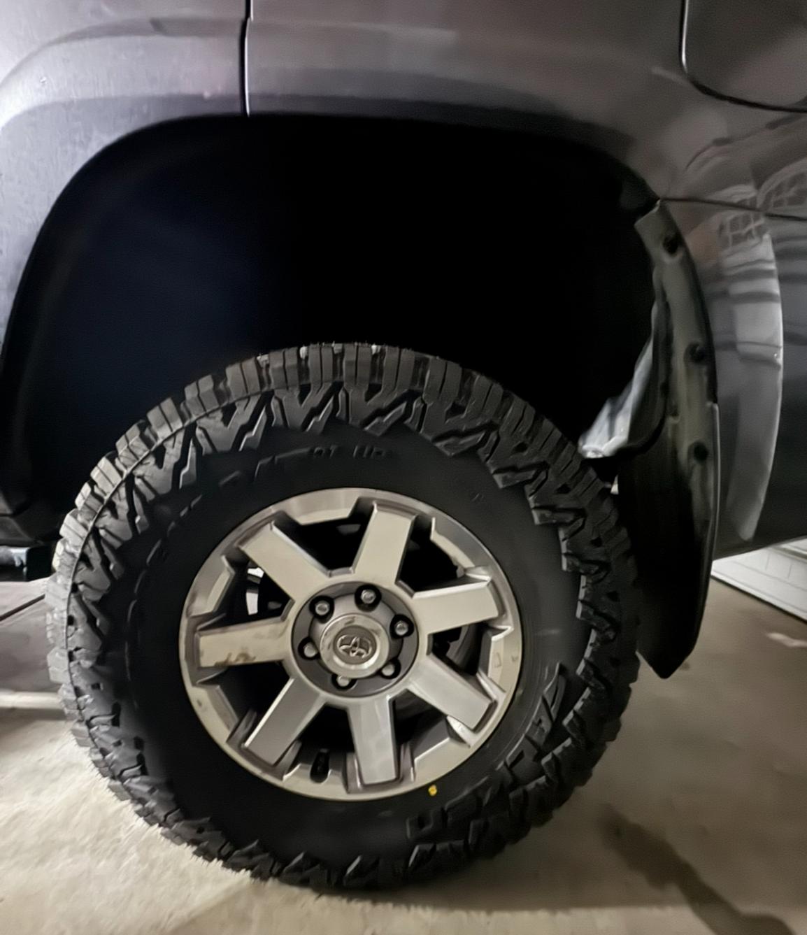

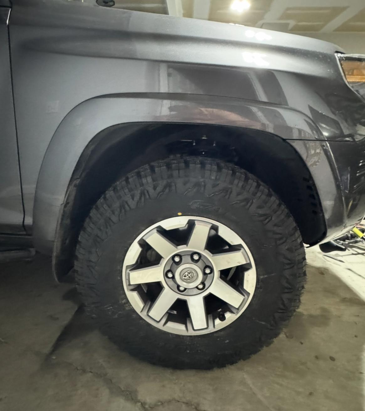

Put 6112/5160 setup on my 15TP with Kdss. Went with ome 2889 and front set to 5 clip. Post install im at about a 3.5 in rake front to back. Springs should settle a bit, but not over an inch. I have rci pike, skids and a superwinch 10 up front. I knew with the weight i wouldn't get the 2.6, but i thought it would sit higher in the front than it is. Just curious if anyone else has seen similar, reduced lift heights.
