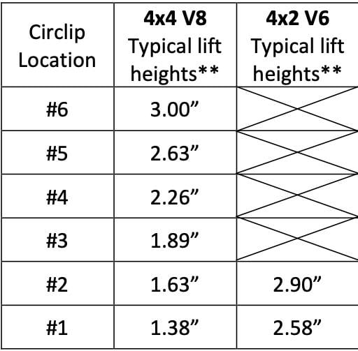

Hey guys. I’ve got a V8 with no extra weight. No skids. No bumpers. No roof rack. Looking at Bilstein 6112 with upgraded 650 lb springs. Looking to gain 2.0” - 2.5” up front. It looks like circlip location 4 is advertised at 2.26” lift, but that’s with the standard 600 lb spring.
Does anyone have this exact setup (V8, no weight, 6112 with 650 Springs)? If so, what setting did you use and how much lift did you gain?
Got 650lb coils recently and about 2 inch of lift on my v8. 4th ring.
That’s interesting because it shows 4th should be 2.26” with standard springs. Would day day you got over or under 2” of lift?
not sure if this is helpful but I installed this combo about 4 years ago.
I went with the coil that the 6112 comes with as I was not going to go with a winch or steel bumper. I maxed out the height on the coilover.
PRE LIFT # (center of wheel to fender)
Driver Front: 19
Driver Rear: 20 5/8
Passanger Front: 18 7/8
Passenger Rear: 20 5/8
POST LIFT:
Driver/Passenger Front: 23
Drive/Passenger Rear: 24
Sorry I don't have numbers for you, but this is how mine came out.
I believe I went with the 5/3 setting. This kit is with the 650lbs front springs.
