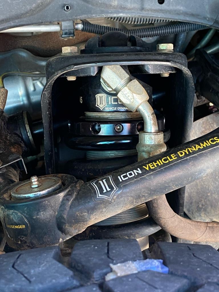

For a point of reference this is where my 700lb Icon Coilovers are sitting with 230ish extra lbs hanging over my front axle. Alum winch bumper, winch, dual batteries, air compressor etc. it nets about 2.75” of lift over stock
Either way the proof is in the pudding. Look forward to field testing the softer setup over some rocks soon.
