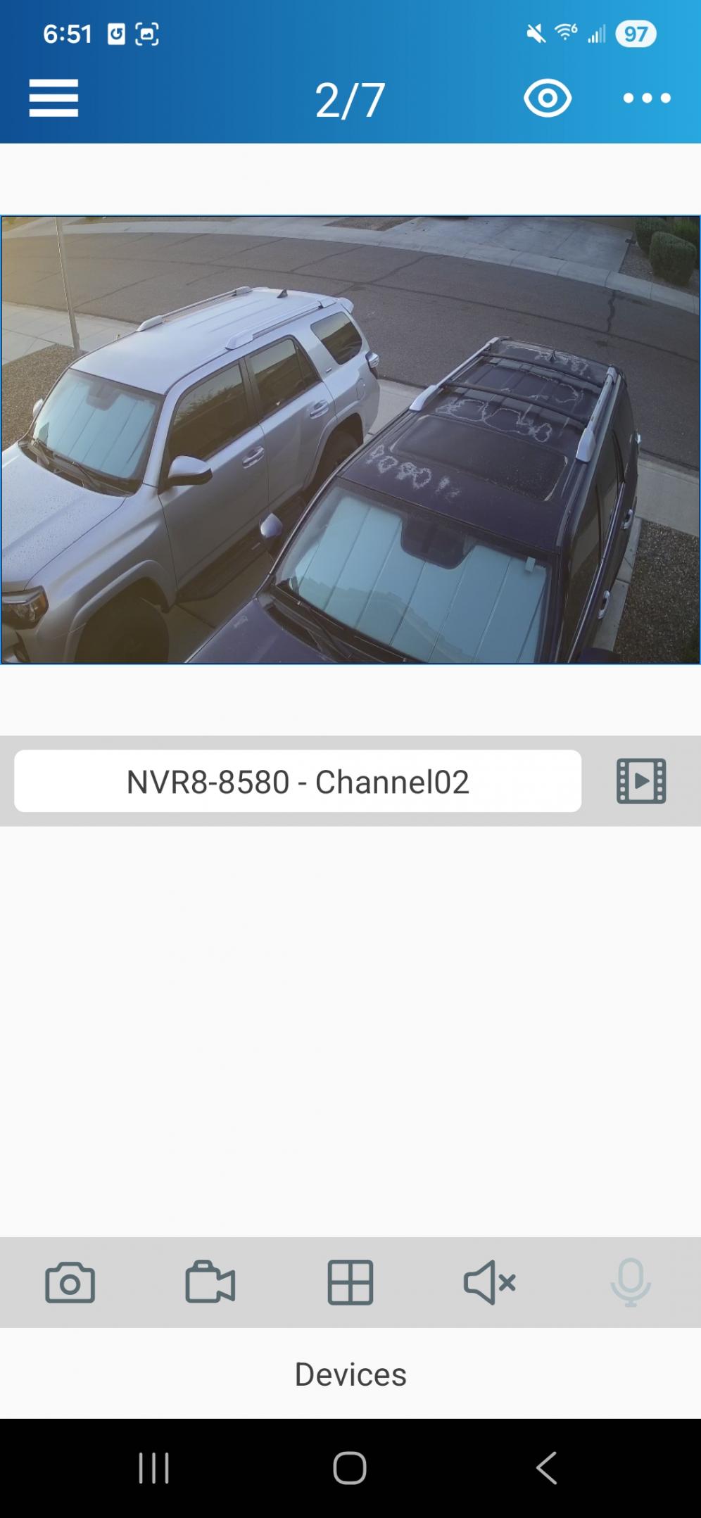

Here is a screen shot. The blue one top has no clear coat.

Depending on what the other ashy areas look like, I'd honestly just have the roof sanded somewhat smooth and wrap it black or something. I wouldn't opt for a full respray. But detailing definitely won't help with failed clear coat.
For what it's worth, I am the owner of a detail/wrap/PPF shop and have been operating for 18 years. You don't want a cheap paint job as it will likely come with issues over time. I would opt for the wrap.

Correct. Any form of wax, sealant or ceramic coating is only a protection applied to the top of healthy clear. If the clear is fading or worse, has failed and is peeling, none of those products will help. Repaint (or sand and wrap over) are the only options to fix it.

Thank you. I got a quote for a roof and spoiler wrap from one place. Still looking but I think this is the way. Bad thing is they don't prep the bad areas before wrapping.

I washed the 4runner. The only issues are hood, roof and trunk lid and spoiler. I called the original paint guy, who gives lifetime warranty, and got a new quote for $2100 for those items. That's what I'm going to do.
I would have done ppf on those areas but the cost would have exceeded the paint and I could not find anyone that prepped first. It would need prep.
