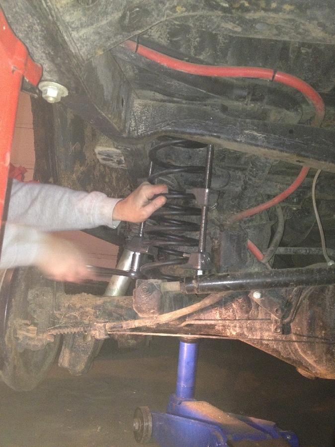

sure thing. I don't have any pictures or explanation on the first method. We just used a floor jack to move it around and make it all like up. As far as the spring compressor method here is a picture of that. Only thing you would have to do is pull the springs out, run the shocks first, then put the springs in. I don't even think the axle was at full travel here by the way.
