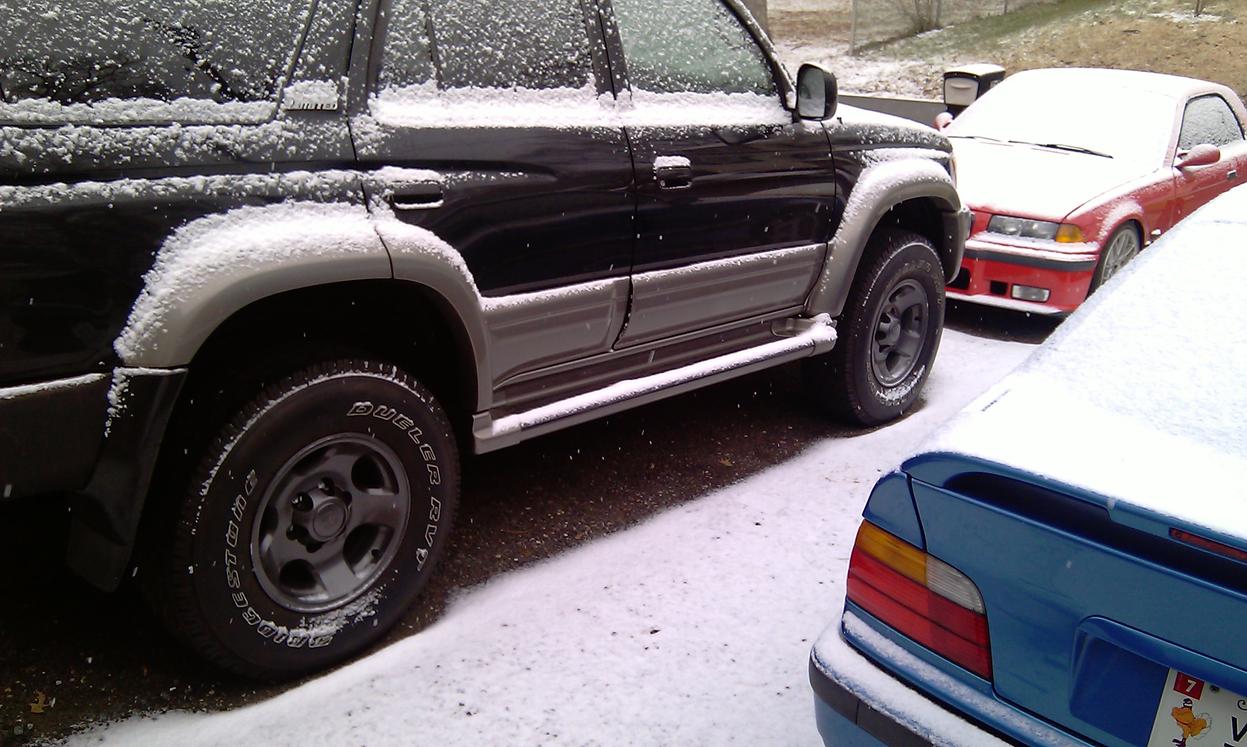

I roughed up my 80 wheels, shot 3 coats of self-etching primer and then 3 coats of duplcolor wheel coating in gunmetal gray. They looked fantastic and held up very well!
Good luck!

Good revival on those rims..post a shot though of the whole truck next time so we could appreciate the LC wheels much more...good work on the paint job.

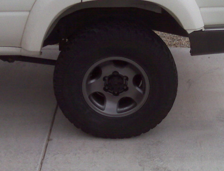

did the same thing with guy couple post up...sand,primer,paint using rustoleum gun metal(metallic).
held up in 3 snow storms,ice and salt....
bought wheels in the same cond't as OP...
btw: if you upgraded to the tundra 231 brakes you'll need to grind very little material off the back of these wheels :)
