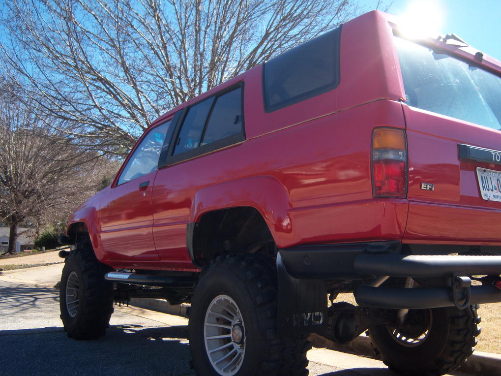

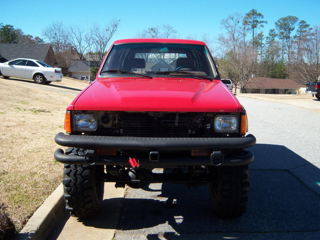

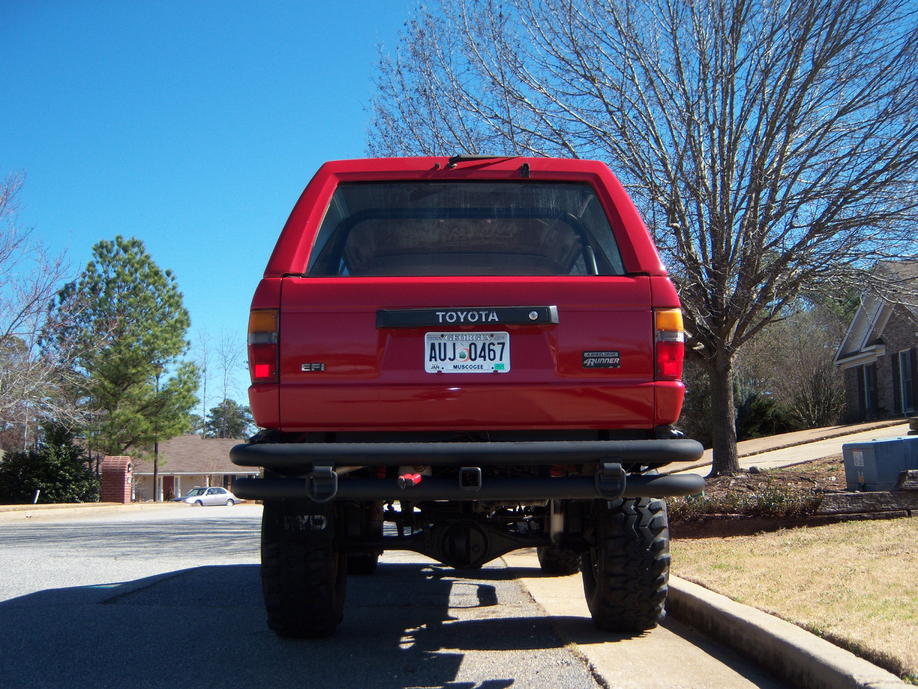

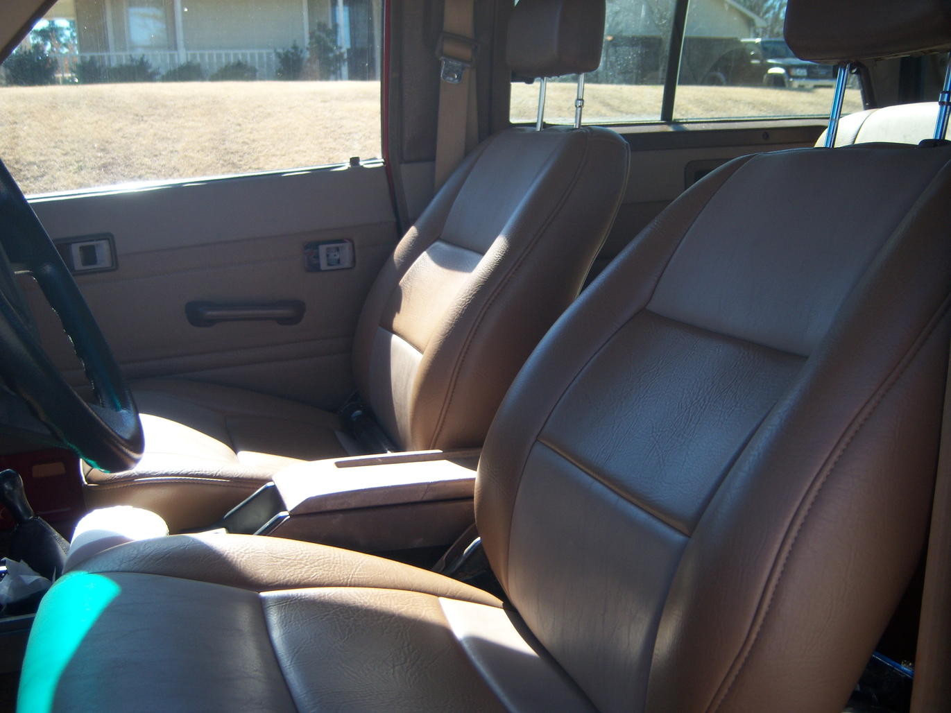

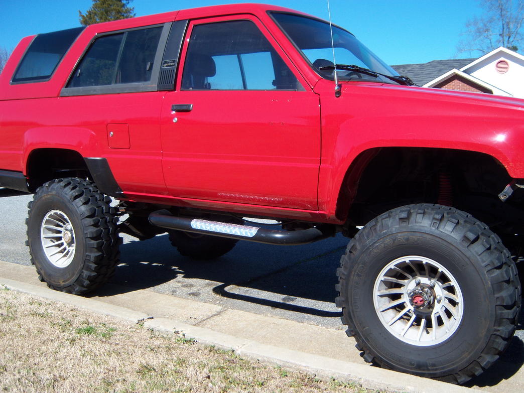

I posted some pictures in another thread. But I figured I would add them here too.
