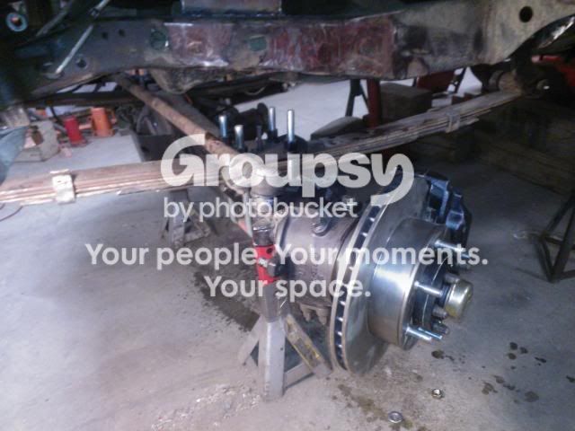

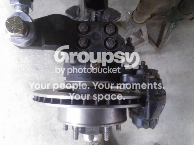

Marlins rebuild will work with IFS hubs, just did a version of this, very easy to do. They are Ifs hubs ground down to fit into a 97 Tacoma rotor. You have to take about 1/4 if material off. It requires moving the break caliper to the outside of the ears on the axle and spacing it out with a small washer, and I drilled out the holes to to put a 1/2 in bolt in there. Im running the backing plate eliminators, otherwise you would have to trim that too. Also had to widen the opening of the caliper a bit to fit over the taco rotor.
Now I have a matching IFS width without wheel spacers. You could technically still run spacers, but thats putting a lot of stress on the trunnions and would not recommended it.
WP_001533_zps3c5fabb2.jpg~original
WP_001559_zpse290d19c.jpg~original

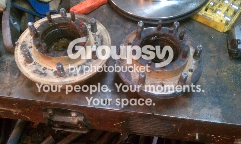

Early ifs hubs are "flowered" and is easier to grind down, later (like mine) were solid all the way around. I ground both of them with a flap wheel in about 1/2 hour.
Below is a later ifs hub with the outer edge cut down (not my pic) Stock on the left, cut down on the right.
IMAG0218-2.jpg~original
IFS hub on the left, solid on the right. You can see how the overall length is the same, the IFS hub WMS just rides a little farther out on the spindle. Again, not my pic.
