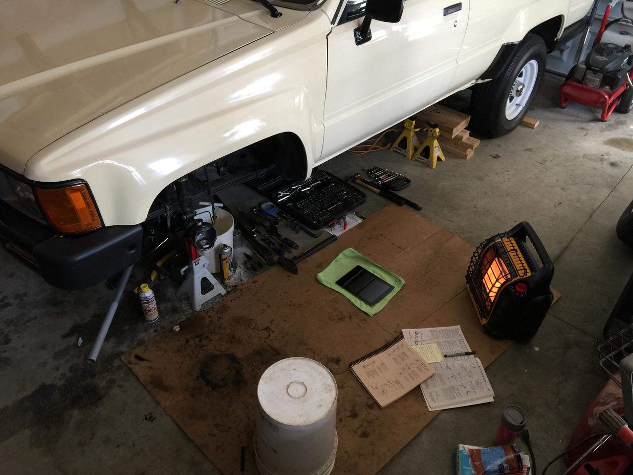

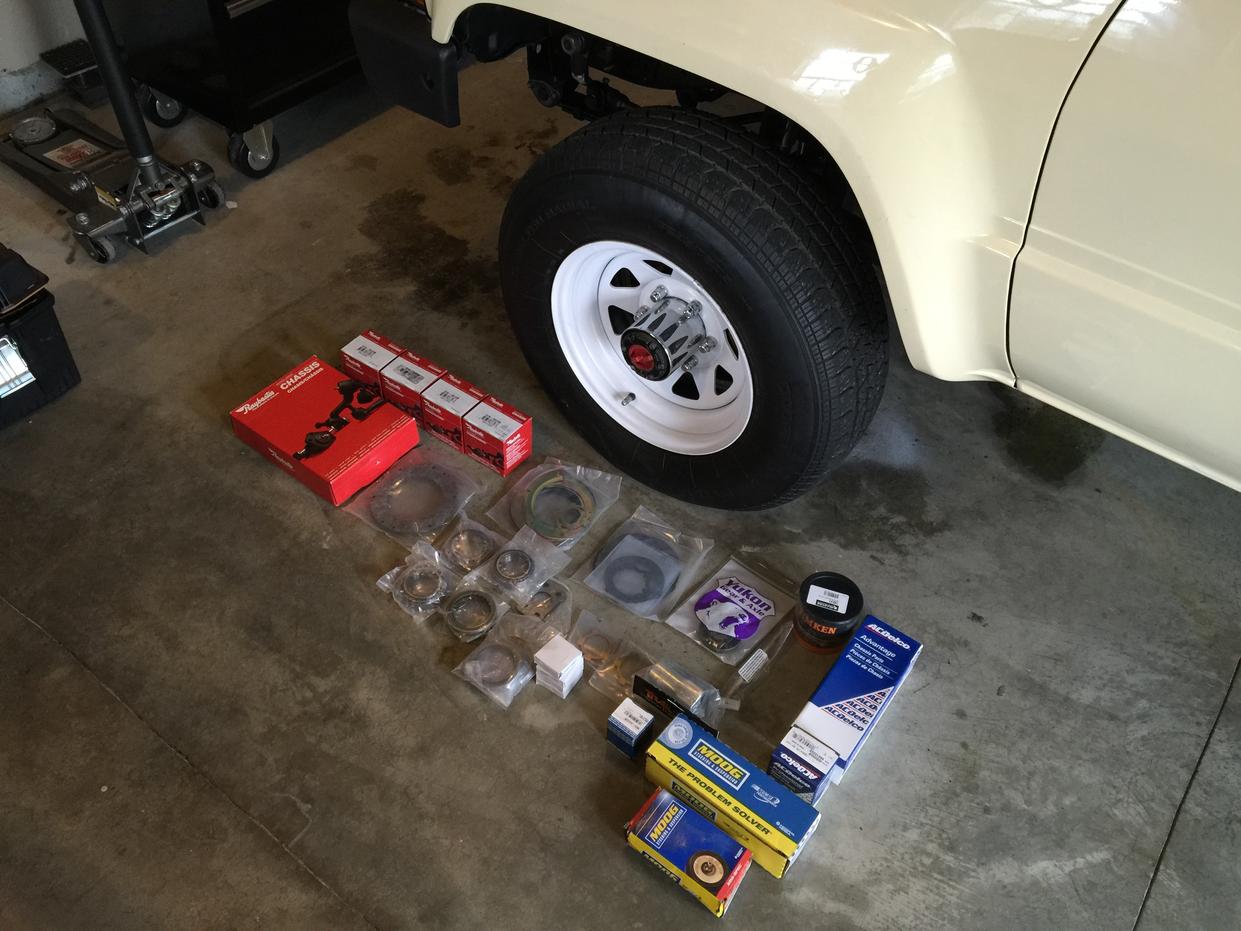

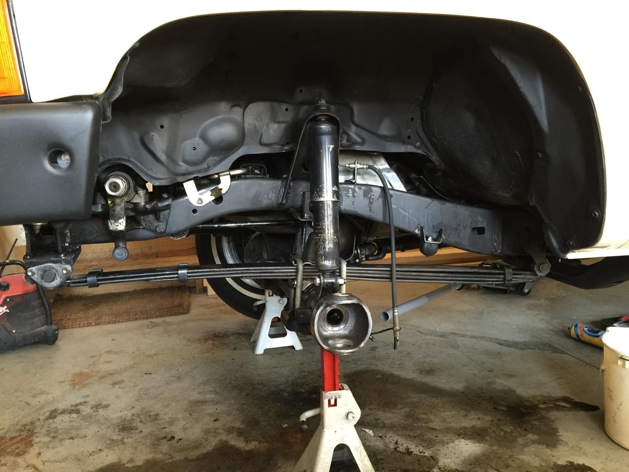

Okay, so I am in the process of servicing the knuckles on my 85 along with a couple other items. For reference of my skills, this is probably the most complicated project I have taken on, however the tear down went very well on the knuckles thanks to lots of prep and research which I have found plenty....However, one question.
Most of the references I come across recommend filling the knuckle 3/4 full of grease, however of course you don't see a lot of pics of this since it's presumable a messy process. So, I literally pack in grease until the knuckle housing is literally 3/4 full, right? Shoving it in there without verifying had me concerned and I want this to be perfect after putting everything back together.
Thanks for any help you can provide - definitely wouldn't have taken this on without finding good research in the first place.
Pics not for reference, but just because they make all threads better...
