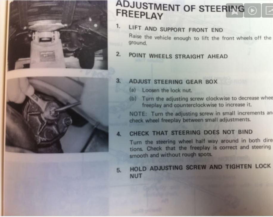

there is some small adjustment your can make on the steering box, it might help somewhat
