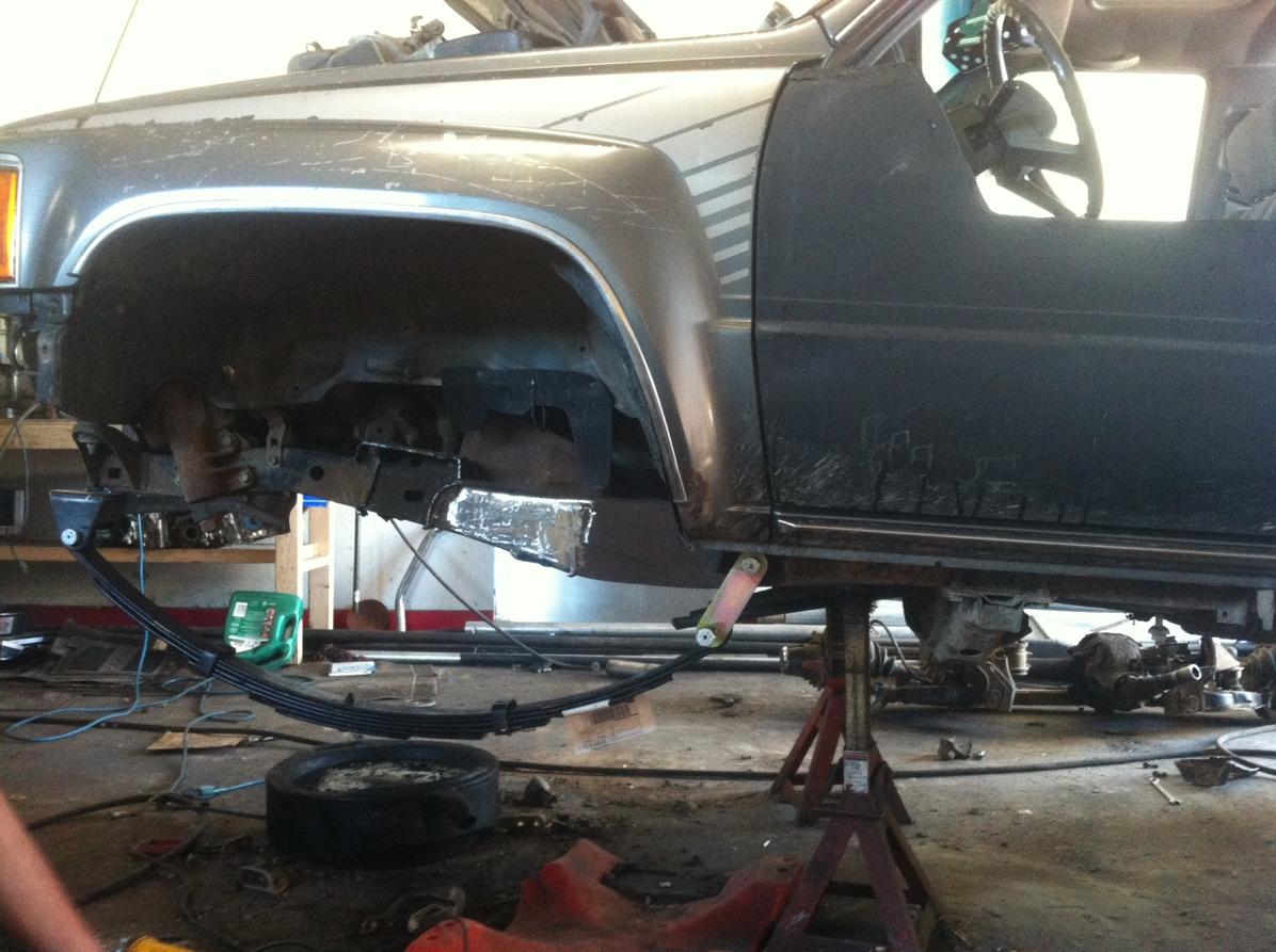

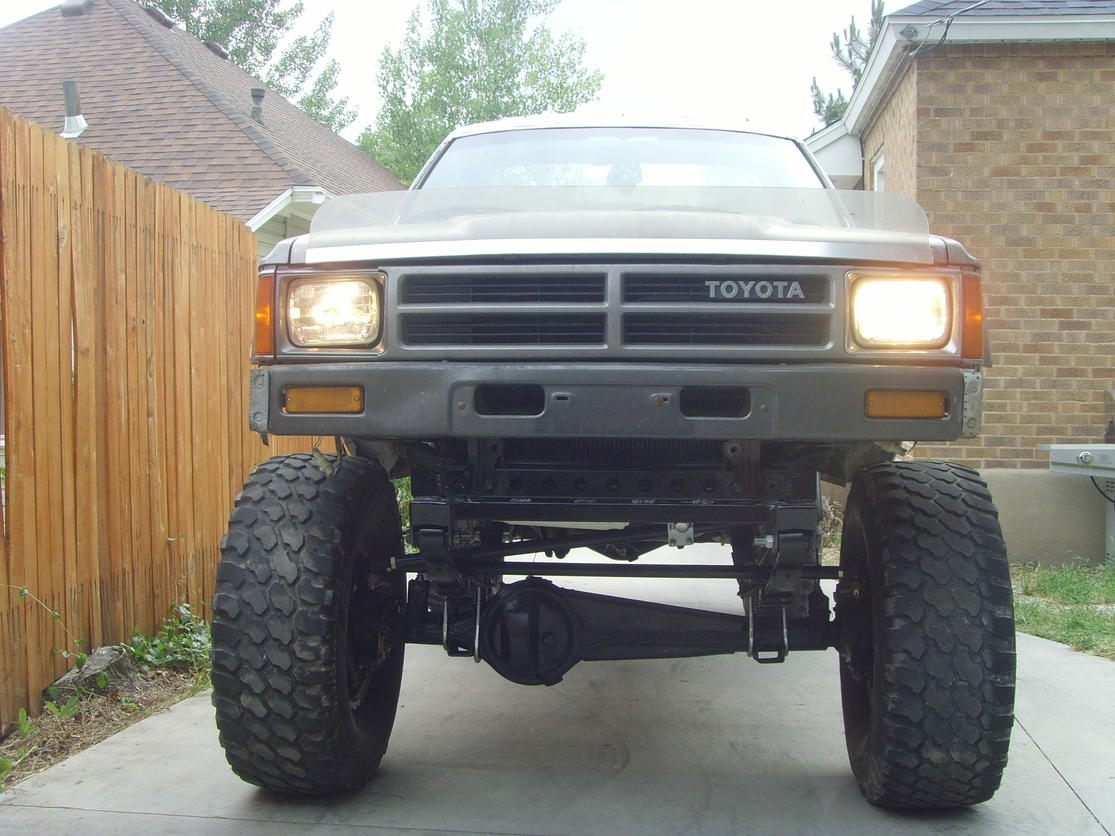

The Sas has been started as of last night. That independent s*** is gone! I'll get more pictures up when I take them
Are you going to relocate the IFS box? You might have trouble with your tie rod and drag link interfering if you don't.
:iagree: I would move the box forward now. You can also move the axle ahead a bit more and avoid some rubbing. TG has a simple kit for this.

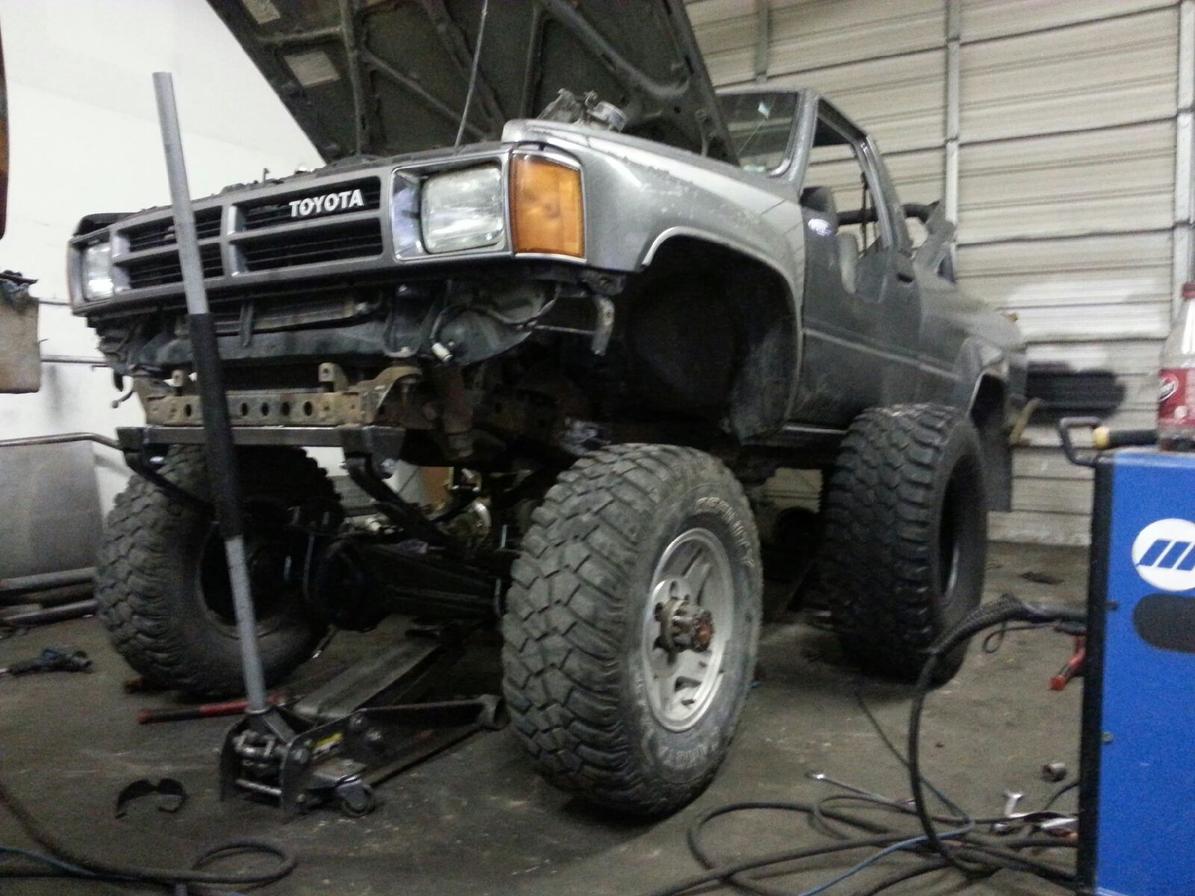

I guess I never properly finished my build thread. That's a shame, because I like telling people about my truck.

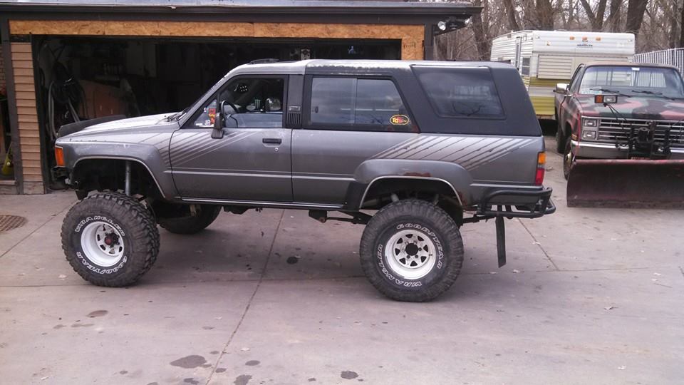

The Trail Gear IFS Eliminator kit was installed, front axle rebuilt (Toyota axles suck), went Chevy 63's in the back. After all that, went cheap in the front with a square front driveline. I'm looking to fix that this year; circular is better.
Recently got new offset rims on MTR's. She was tippy on 35s on the no offset stock wheels, so that ought to help out.
I ordered a Killer Toy Tops Solar90 Bikini top, which arrived in one week flat. I'll be putting it on in the next week or two. It ought to look good! A picture with it on will be posted.
Edit: If a moderator could rename this thread to "87 4runner SR5 Build Thread" that'd make more sense.

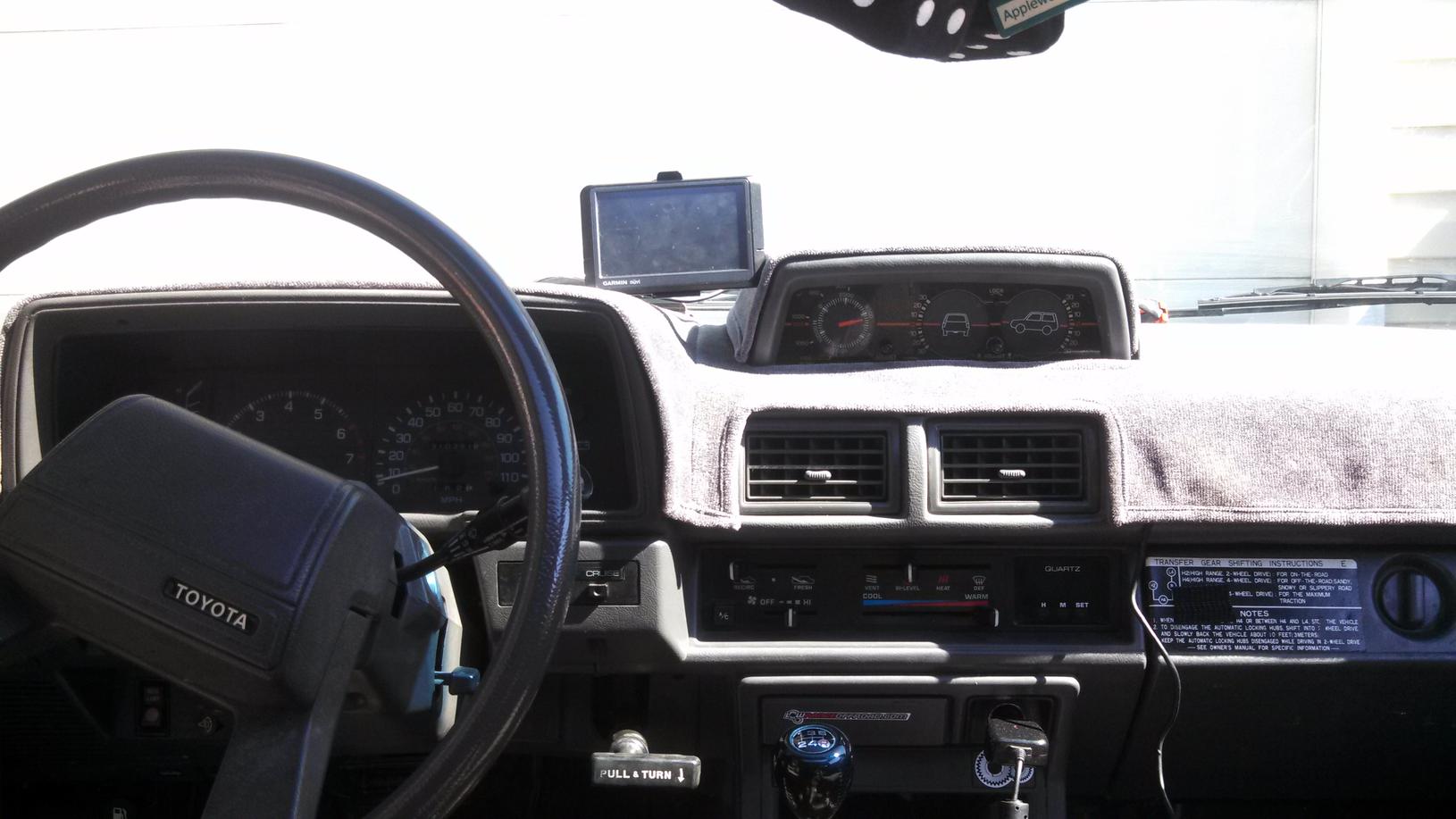

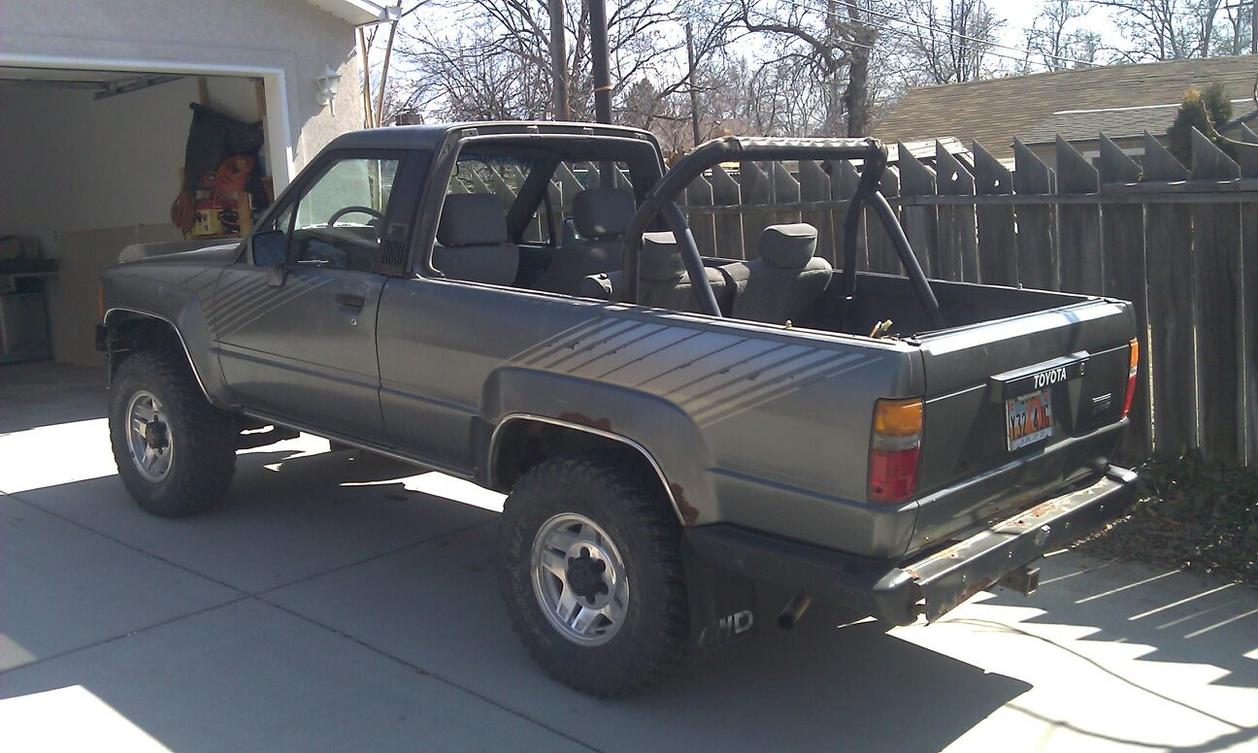

Bikini tops galore. She's now cruising the streets all open-air like. Another two months and the half doors can go on again.
Also, check out that tasteful Garmin. I learned they have the Best Feature Ever - you can set them to leave a blue line anywhere you've driven before.

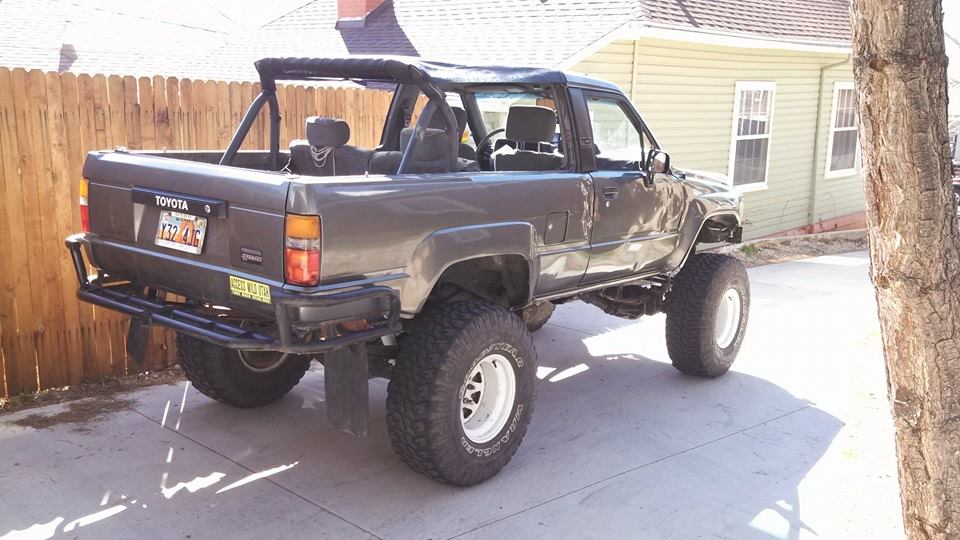

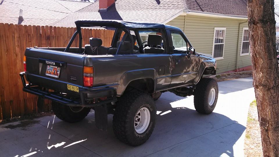

I like the looks, but unfortunately the days of rolling around with 4 people
in the truck seem to be over. Hardly anyone will get to enjoy the best seats
in the house. It's a good top, but it's something most people could construct
themselves.

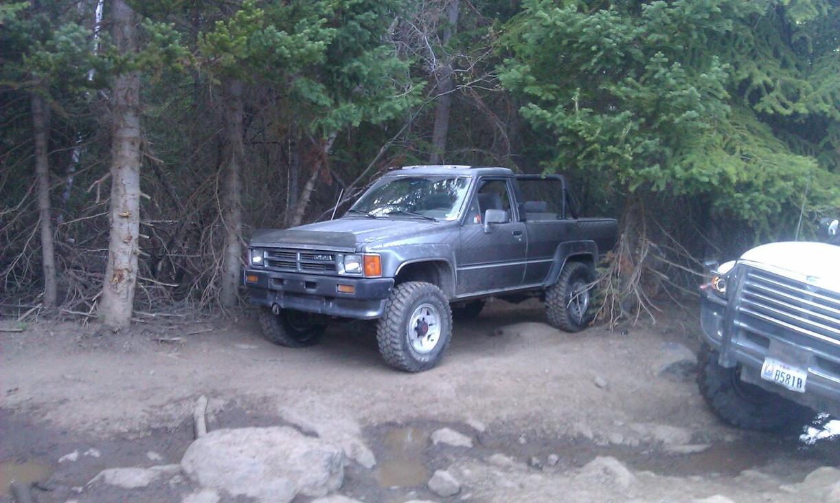

Repacked the front bearings, and greased my zerks! Should be wheeling
tomorrow, even with the windows stuck down.

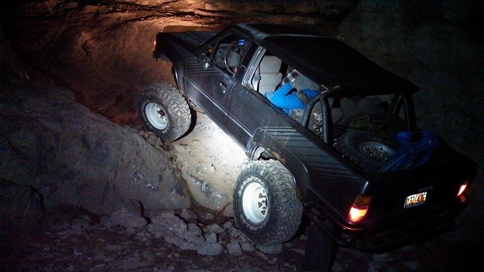

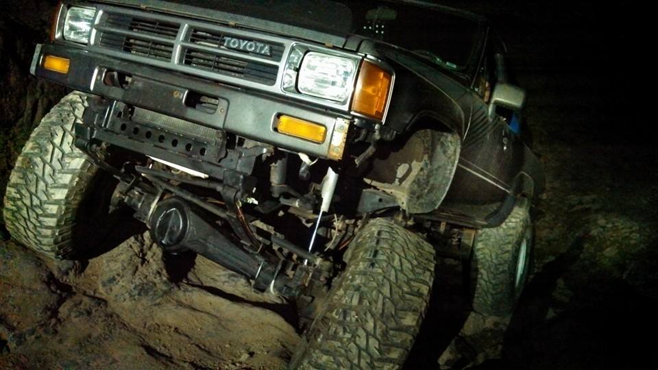

Ran 5 mile last night. Nosed-up Wayne's World at 2am. Pulled over by Saratoga PD at 3am. Bit cold with the windows stuck down.
