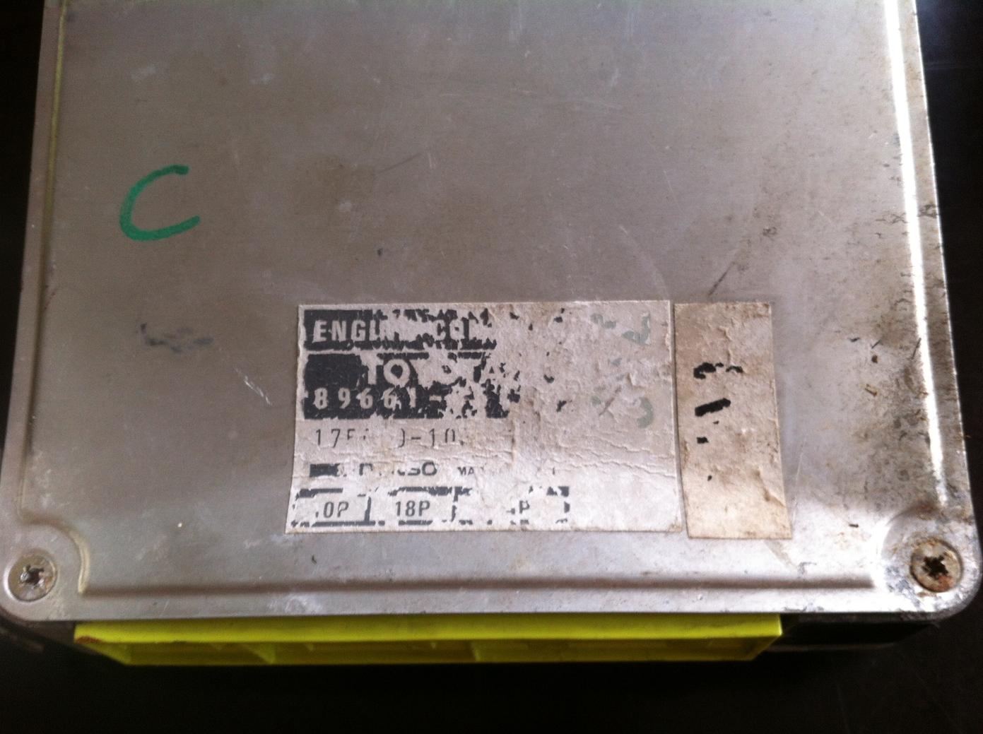

Bringing this topic back up, I just picked up a 88 v6 and it had 2 ECU inside, both stickers are pretty much unreadable, one had gray slots, other has yellow, yellow I can read some and it says (89661- "" ) (175"""- 10) and I can see (3VZ) just wanna make sure I'm using a correct ECU now that I've read this. The marks are just the numbers I can't make out
