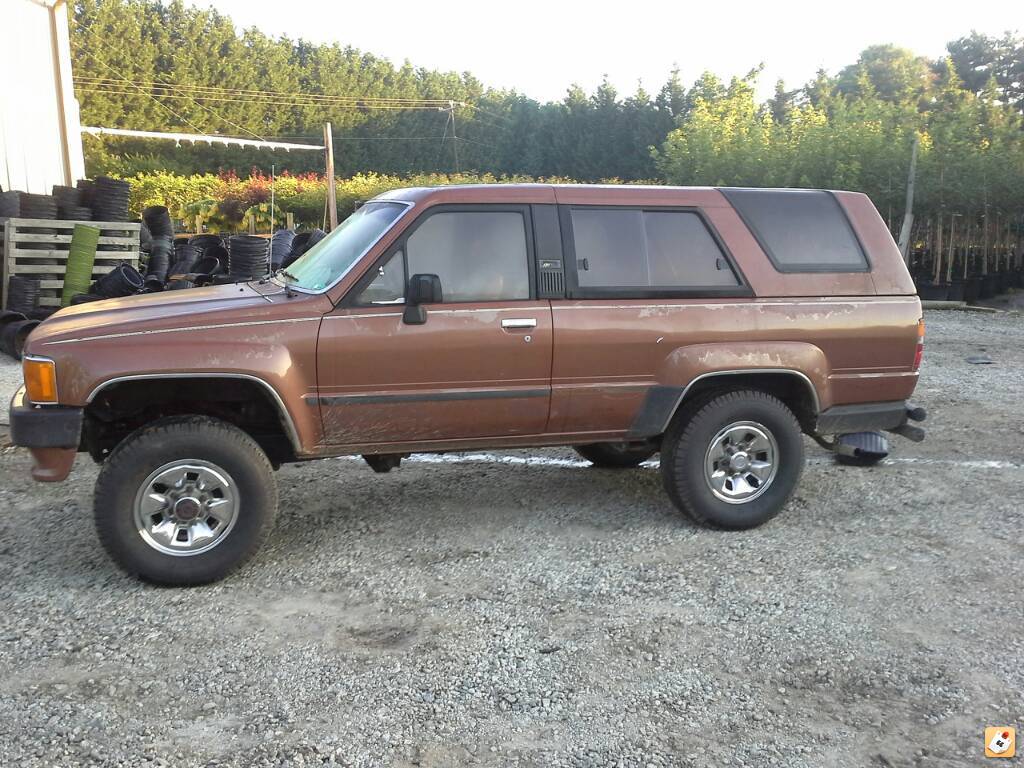

I started out with a completely stock 87 sr5 4runner. The clear coat ia pealing off so a new paint job is coming this winter. The motor has been completely rebuilt by th previous owner. My plans are to run 63" chevys and bj spacers with 33's.

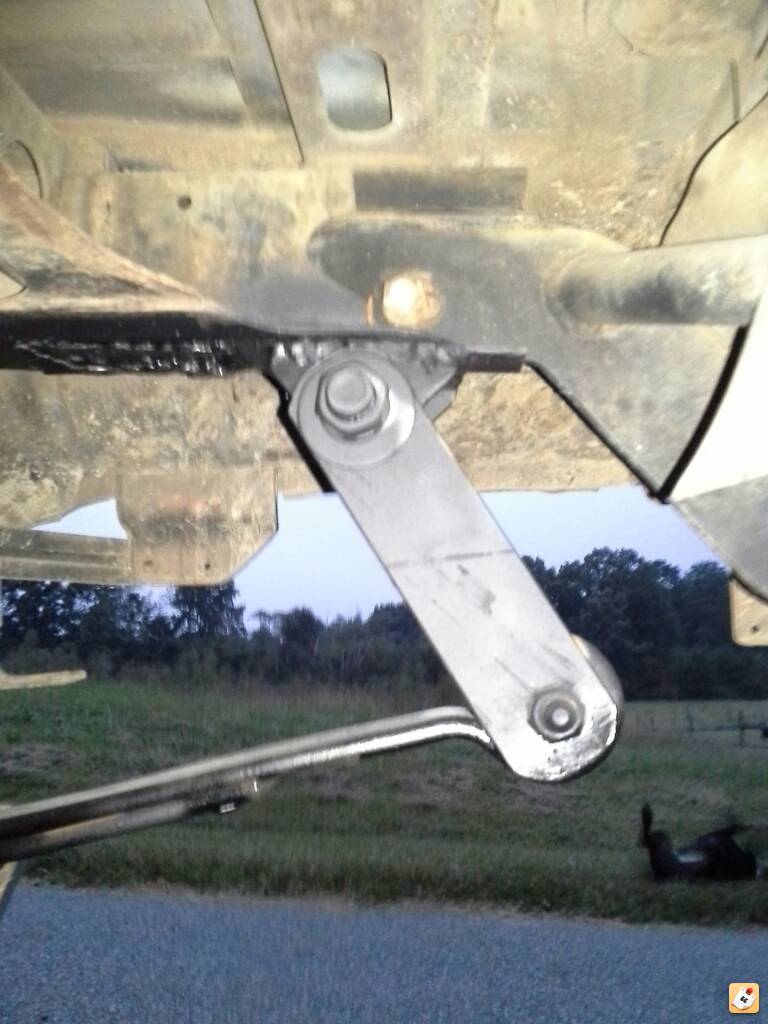

I used a 6" shackle for the rear, which gave me a little more height than I wanted.
I have the torsion bars relaxed quite a bit. So when I asjust them some I am sure it will help some. I dont want to twist them to much and sacrafice ths ride quality.
torsion bar bolts as they sit now. I am thinking of going to a 5" shackel to help get it level. Any thoughts on shortening the shackels?
Another thought to lower the rear end is to remove the over load spring and leave the 6" shackles in place. Any thoughts?
That's a really good shackle angle. Unless you plan on hauling heavy loads frequently, I'd definitely look into yanking the overload leaf before you mess with the shackle.

I think I have decided to remove the over load spring. That should lower it 3/4-1" and with a slight tbar adjustment set me level. I will still have 3 leafs left and with bump stops hopefully have no issue's. I will post pics of the results

Well I havent had much time to work on the 4runner but I have managed to get a little done. I decided to lower the rear end by installing some 5" shackles from ruff stuff. They are 1/8" off set.
