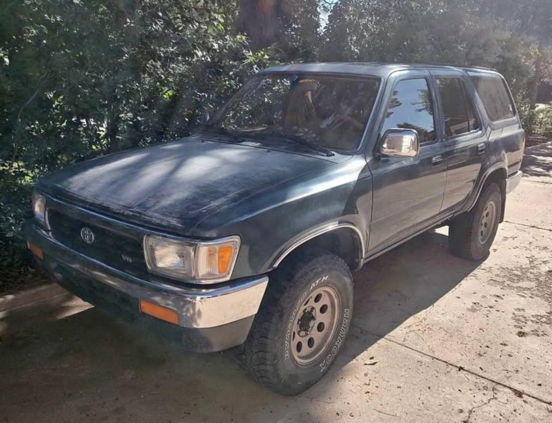

Someone in Colorado is selling this 1994 3.0L v6 4x4 4Runner with 220k miles for $4.2k on Facebook.
Looks like it grew up in California, 6 owners, no accidents.
Timing belt replaced 98k. Head gasket recall was done in 1997.
Failed emissions inspection in California on 05/17/2023.
I couldn't find any rust on the frame. There is rust on the exhaust and it's loud.
The engine had a bit of a tick, not sure if normal.
When I turned at full lock on the steering it made some noises.
Shifting seemed fine, it did stall on the first stop sign and again on a turn. Started right back up.
I was able to shift into 4L and 4H and they were engaging.
There was probably some small oil leaks in the engine and I assume the transfer case.
Emergency break worked, and reverse. Lights, etc. AC worked, I don't think the heat worked.
I braked from 30mph and it didn't shake too much.
The rear windshield wiper motor probably needs to be fixed, I couldn't unlock the back door or put that window down so that seems broken too.
CV boots aren't torn, it's 4.88 gear ratio as far as I can tell from the axle code.
Windshield is cracked, sunroof works. Interior looks good. Paint is really faded, clear coat is probably gone. Dash is cracked.
I plan on taking it to get a compression test on the cylinders and a pre-purchase inspection on Monday, will cost me $350.
I think I could talk them down to like $3.5k - the stalling concerned me. My brother thinks the milage is too high. I really just want it to be reliable off road, I have a daily driver - but I plan to have another vehicle with me too.

The 3.0 wasn't Toyota's best design, and the mileage is high. Frame rust was a big problem with earlier trucks, but I think better on 2nd gen.
If you like it and can get the price down $1 K or so might be worth it, just expect to put some $ into it to fix things that will pop up.

So the HG was done in 97, that's no guarantee that it couldn't leak again, right? I'm suppose to hear from the mechanic today but it would a big job.
Mechanic got back to me and says biggest things are rear drum brakes and the wheel bearings and seals in the front have play.
He said something like $4,200 in repairs, but I don't think those things are outside of my wheelhouse.
I've done drums before. I was more worried about the head gasket. The compression test came back 140-145 on each of the 6 cylinders.
I'm gonna use the report to negotiate down, will report back!
$3,400 later I replaced the coolant temp sensor and put in 91 fuel, no stalls yet. Figured out that the rear window/tailgate wouldn't open because the windshield wiper wasn't completely stowed up. Put in the proper coolant instead of the piss colored stuff!
