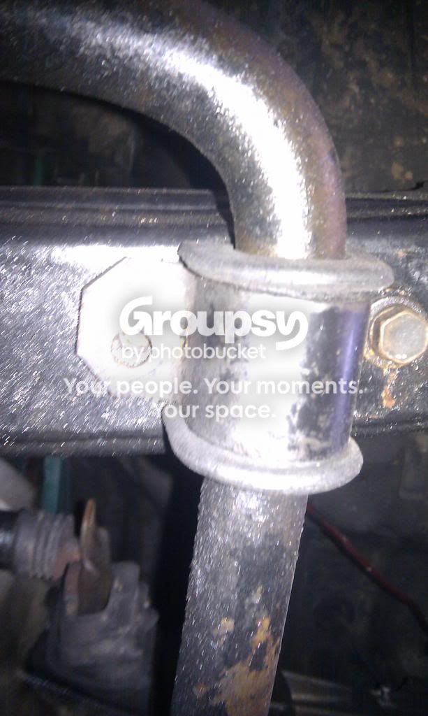

swaybar bushes look like they seen better days also

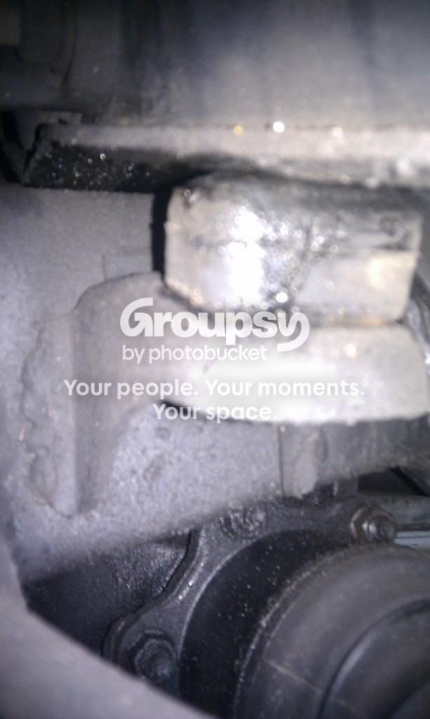

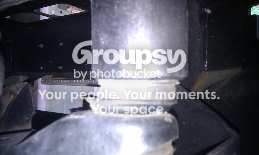

what is this rubber stopper? and why is it destroyed by upper control arm.
other side isnt even touching it???

The black rubber triangular thing is a bump stop to limit suspension compression.

rubber stopper is the drop extension bushings for your swaybar in front. Or are you talking about the lower control arm bushing. stops the lca from overextending the suspension. probably blasted cuz they lifted it by CRANKING the torsion bars up as tight as they will go so your front is maxed out and stiff/harsh as hell.
all your bushings look sloppy, good start is to replace them with a urethane equal, then see what you got. dont overtighten them or they will blow apart like some you have pic'd there.
here is the same rubber on other side, directly under the upper control arm
here is location of crushed 1

that bumpstop that is smashed..is due to the lift, and the upper control arm riding on it.
