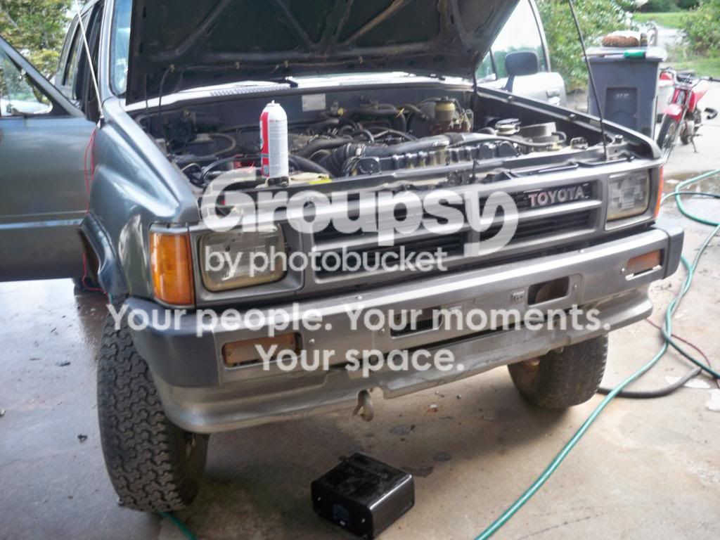

Stuck my seats in and ran my 88 out a couple miles and through the gears. It wants to cut out a little at higher rpm and is slow. I unbolted the converter. It seems to be getting better. Here are my questions
Where is the best place to buy a radiator and get the most cooling for the money. I want to stay under 150. Advance and a local supplier are at about 110 for a replacement. Advance one lifetime replacement. Should I get my original soldered up for 60 bucks?
Where is the fuel filter?
Anyone have a link to purchase a bolt in pipe to replace the cat? How can I check mine? Should I replace Cat or eliminate? I am non emmission. Does the computer/vehicle run better with the cat?
If it's a 22RE, the fuel filter is hiding under the intake plenum, just above the starter. I'd have your existing radiator repaired and pressure tested before replacing it.
The cat makes a significant difference in the amount of emissions put out by the truck. Even if you aren't emission controlled, I'd run one anyway, just because it's not just you breathing the air around you and it's nice to be a good neighbor.
I agree with KV, get ur original radiator fixed. As for the fuel filter, there is an access panel located in the right front wheelwell that makes it easier to replace the fuel filter. Good luck!

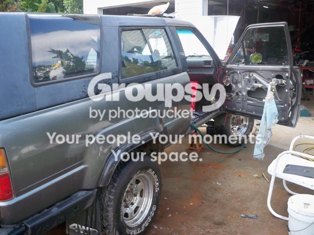

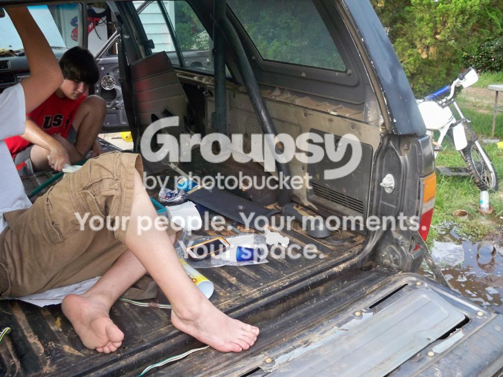

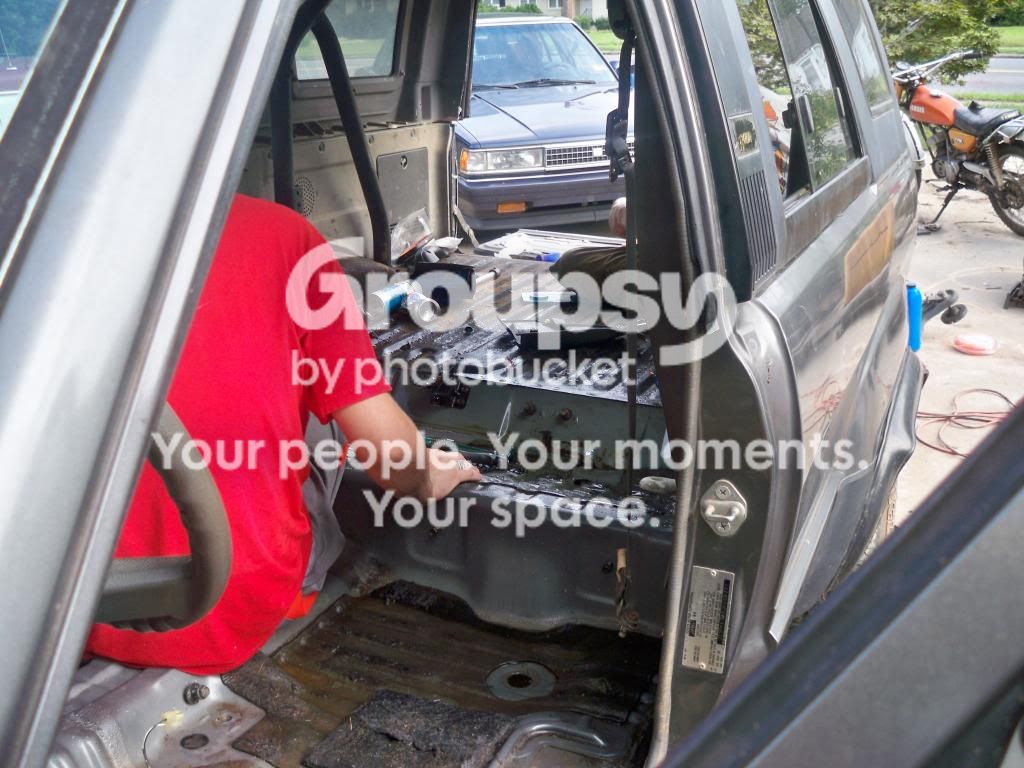

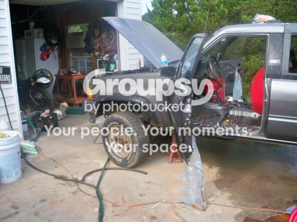

I went ahead and bought the advance auto radiator and installed it. I will hang on to my original. Cleaned inside with brush and water with gain detergent. Cleaned carpet with degreaser, waiting for it to dry. Pulled the rubber plugs from the floor and all inside panels. And I have pics! Sorry about no before but found the camera and snapped today. Lubed up all my window tracks etc.

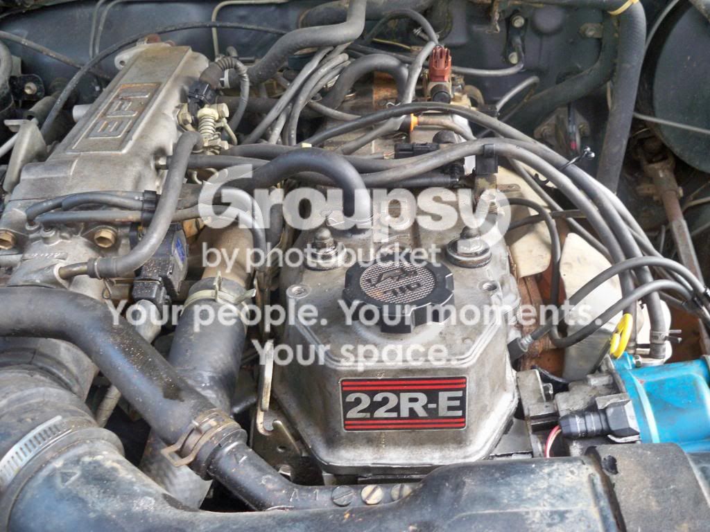

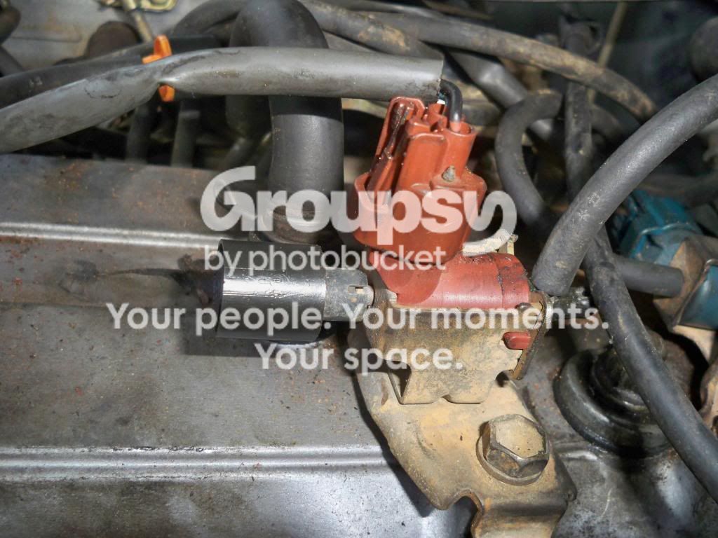

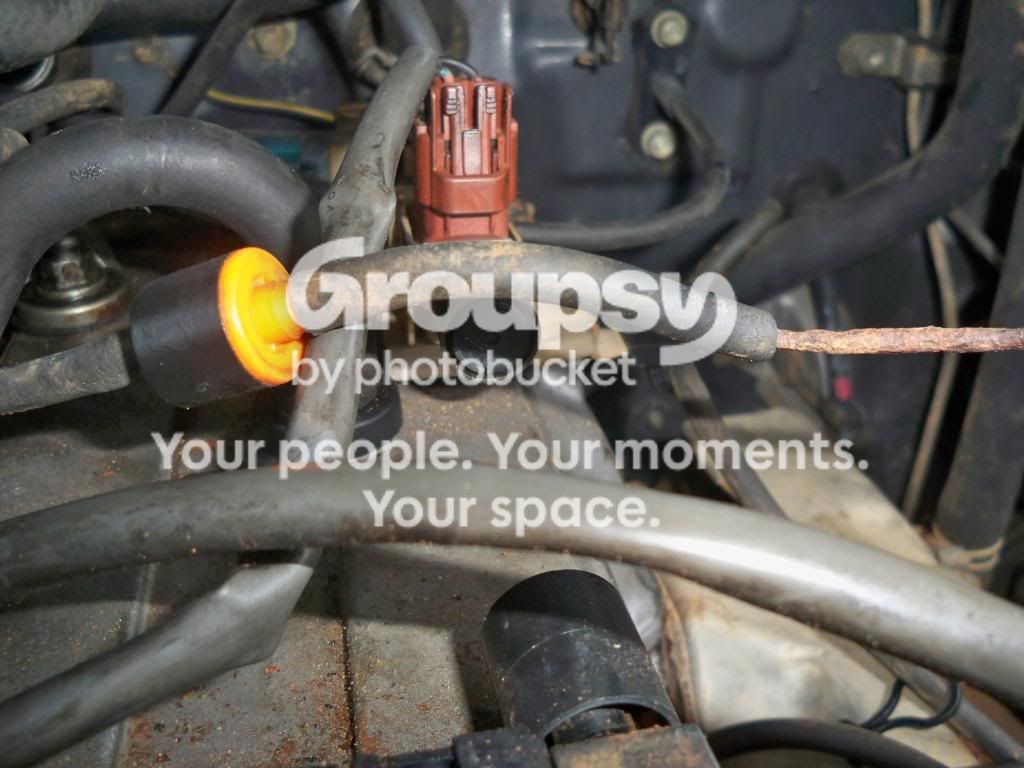

Someone broke the connect off this sensor? and plugged the hose with a rusty nail. Ideas on a fix or anyone have one on the cheap?
I approve of your use of slave labor. I can't wait for my slave labor to be old enough to detail my truck for me.
I'll have to see if I've got that vacuum switch kicking around my parts box. I'm betting you could get one at a yard cheaper than I could mail it though.
