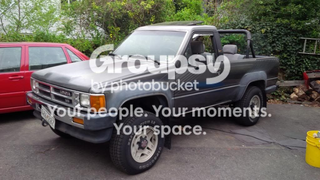

I bought an '88 4runner 3.0 5speed from my cousin for 1000 over the weekend. The rear window didn't work when i got it, but iv'e fixed that thankfully pretty easily.
Now, the reason he sold it was because it started overheating. Originally he thought it was just the water pump but there's oil in the coolant so now i'm going to have to do the head gasket (There's also oil all over the bottom half of the engine and there are quite a few oil drops on my garage floor. Anyone know what would cause this?:confused:)
The 3vze has 256k on it and has had the HG done once before. I really wanted to keep this cheap and get it on the road ASAP but is it worth it for me to do all that work just for the HG? Although I would like to get the top end at least re-machined.

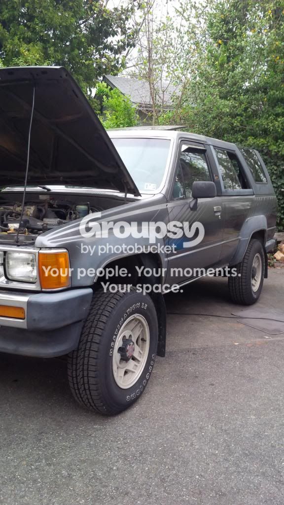

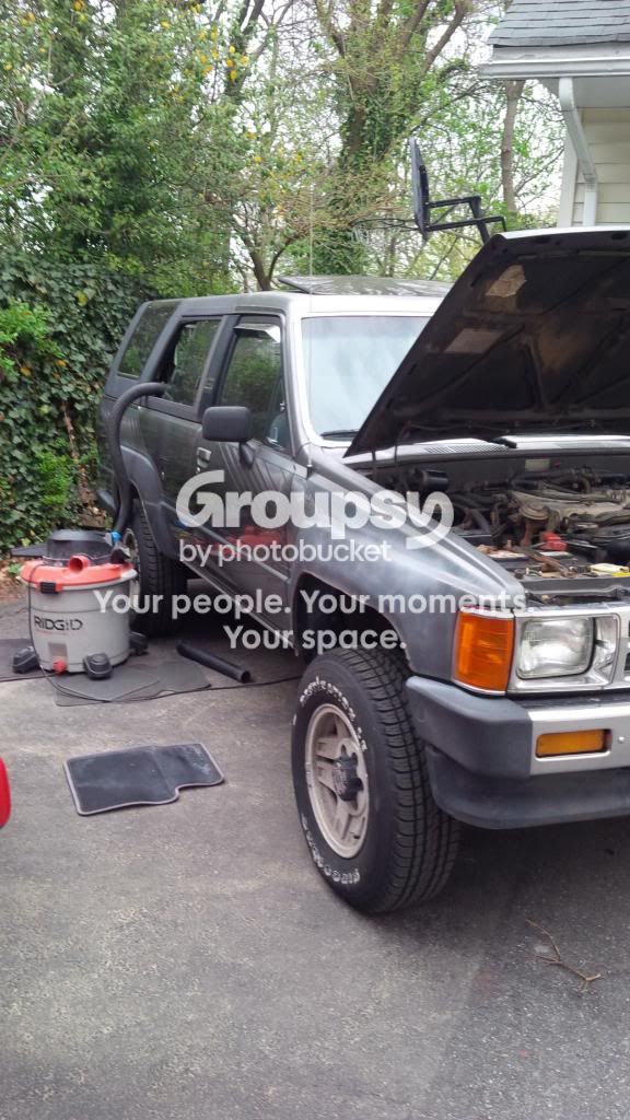

Anyway here are some pics of her
Interior is actually very clean just needed some vacuuming.

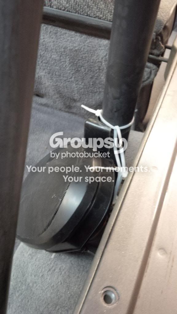

Someone tried to zip tie speakers in the back:doh: needless to say they had to go.

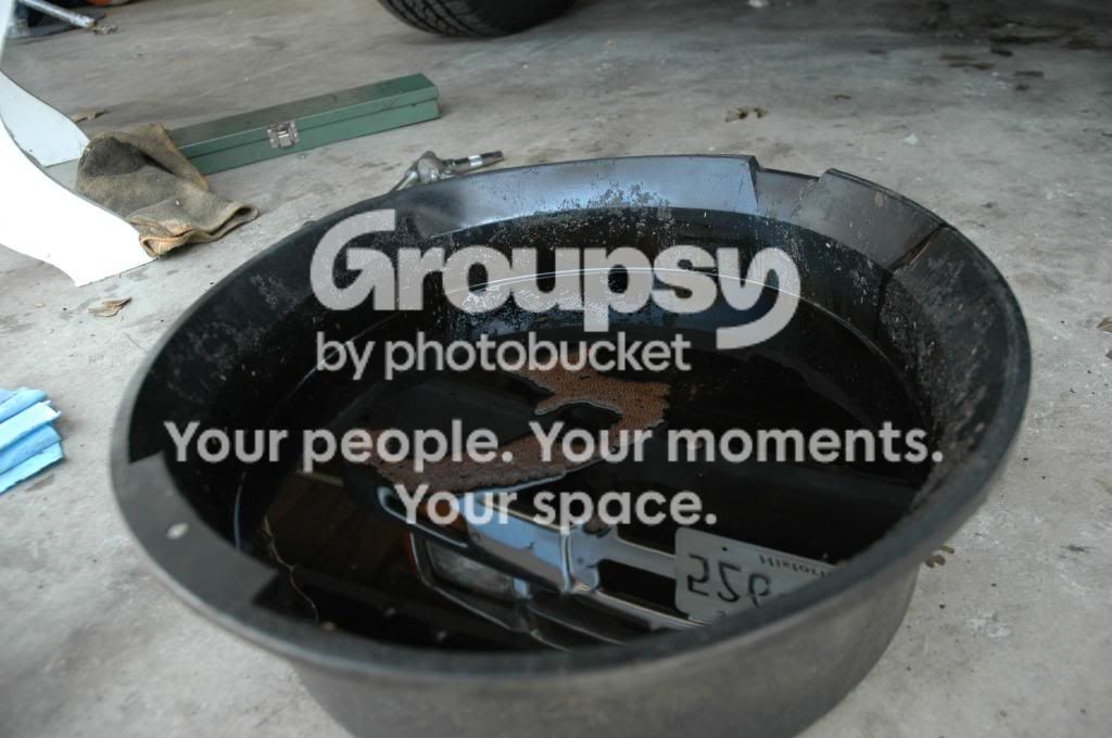

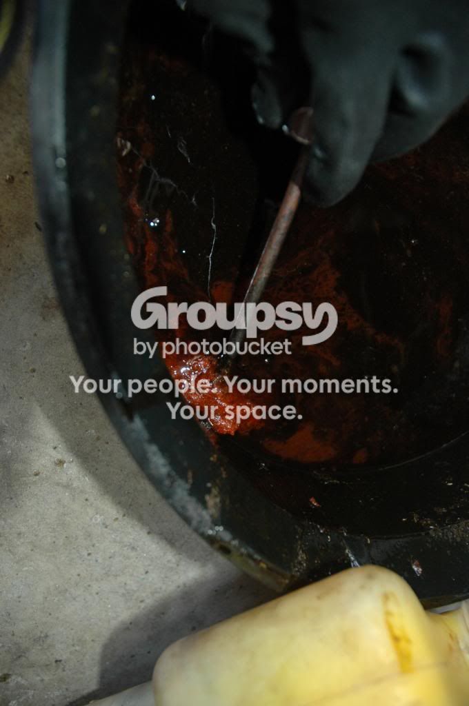

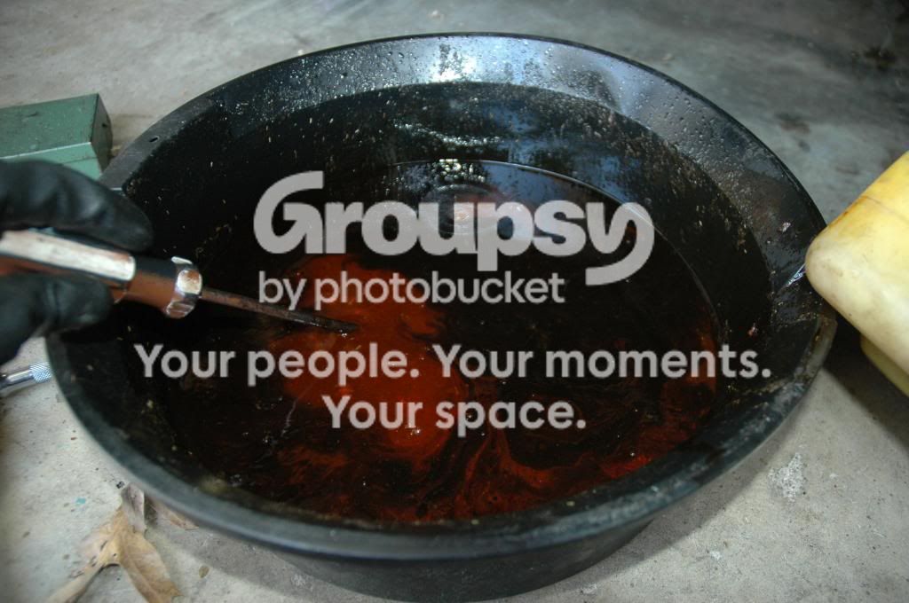

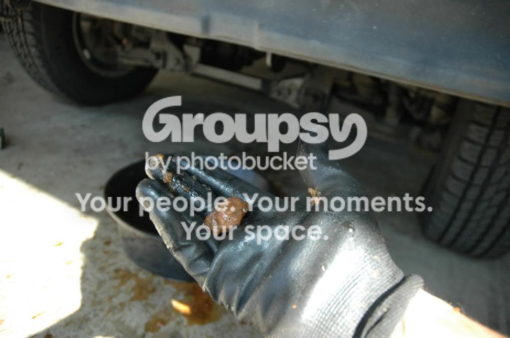

I got started on ripping down the engine today and the oil looked coolant free, however the coolant does have a very small bit of oil in it. I also found out why it must have been overheating. The radiator was clogged with lumps of this nasty gooey stuff that i've never seen before. I imagine its just broken down coolant from not being changed in way too long.
There's the little bit of oil floating on top of the coolant
And the chunks of gooey stuff :(

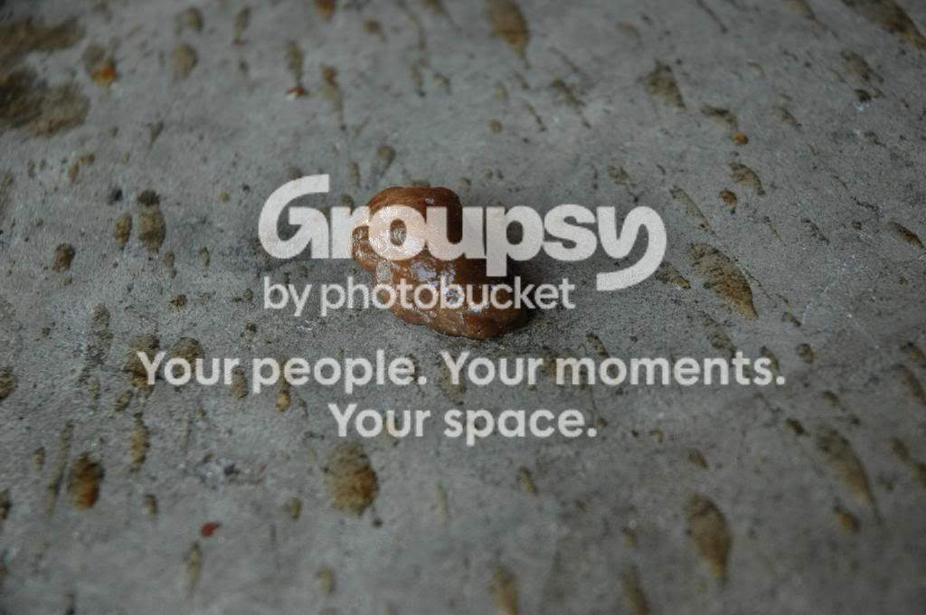

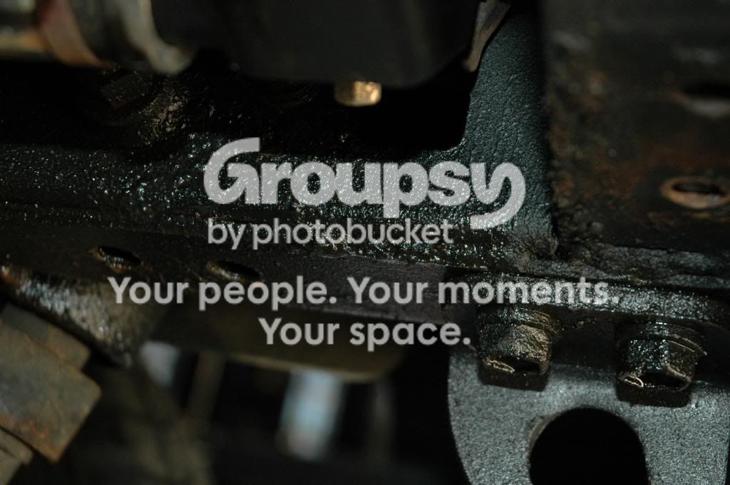

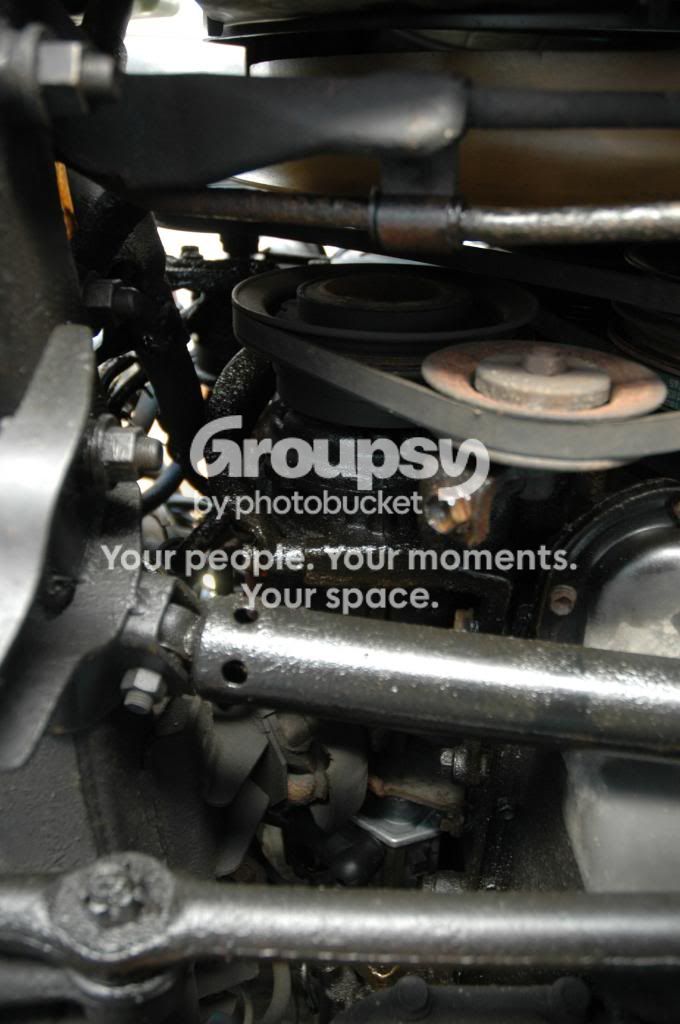

Lots of oil residue on the underside. Is this a common problem with these engines?:help: Is it most likely a gasket of some sort?

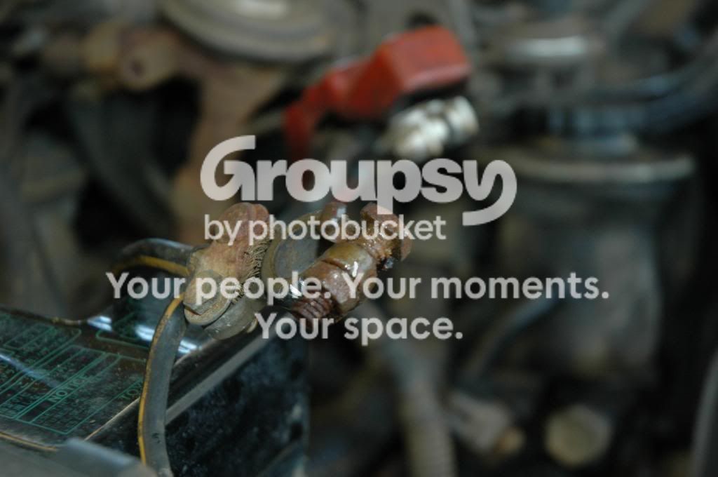

Only one casualty for today. Ripped off the negative battery terminal... oops
