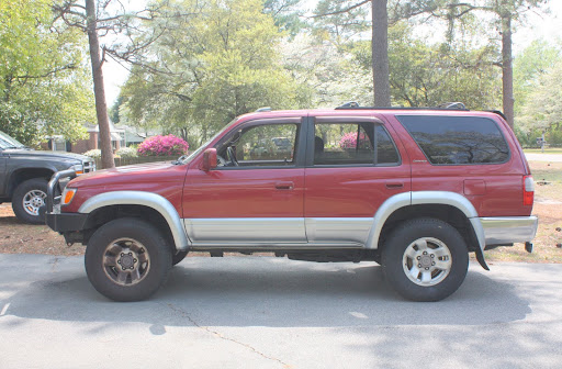

Someone has assembled some 880 906 front and back and post some pictures to see my bus will look like these? I would appreciate your help.
Almost made fun of your grammer...but I caught myself. Here are some pics:
Thanks, sn0wrunner! Sorry for my english, I am from Puerto Rico and don't speak and write the english well. But thanks again for the pics. Now I have an idea how my 4Runner 4x4 1998 will look.

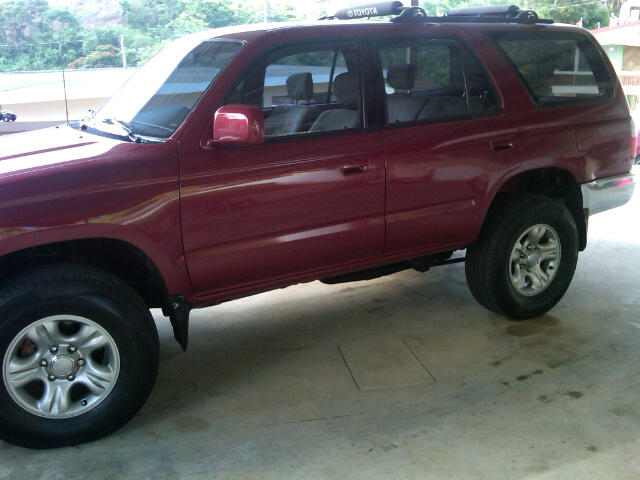

Well, it's my stock 1998 4Runner SR5 4X4 looks now. I will post pictures as soon as I receive and install the 880 and 906 coils.

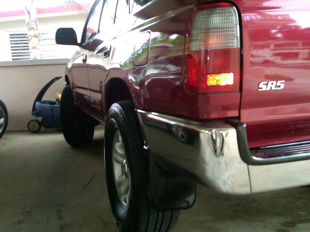

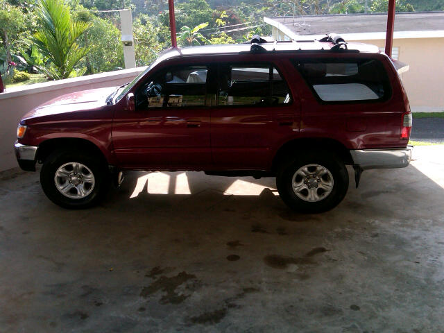

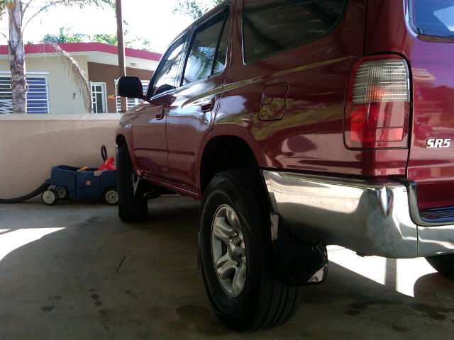

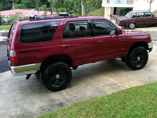

With Dystar 1.5 rear spacers, looks good.

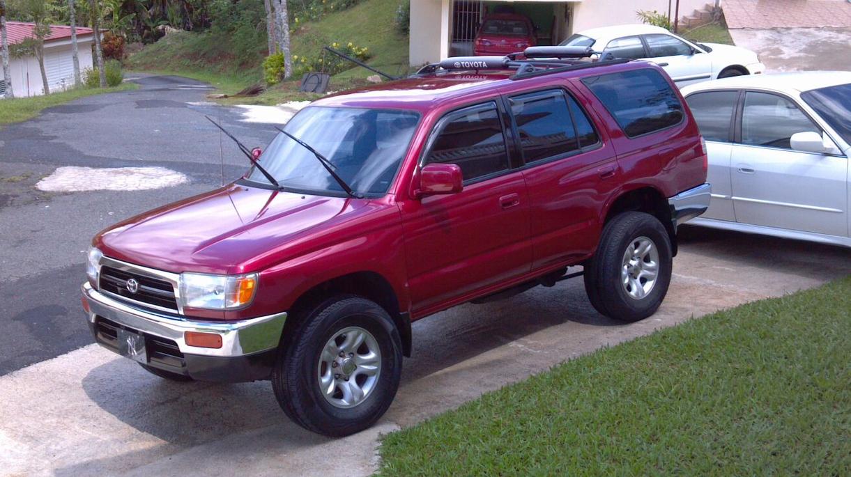

Well, finally the OME 906 arrived last Tuesday, and were mounted yesterday during the evening. See the following picture for the results:
