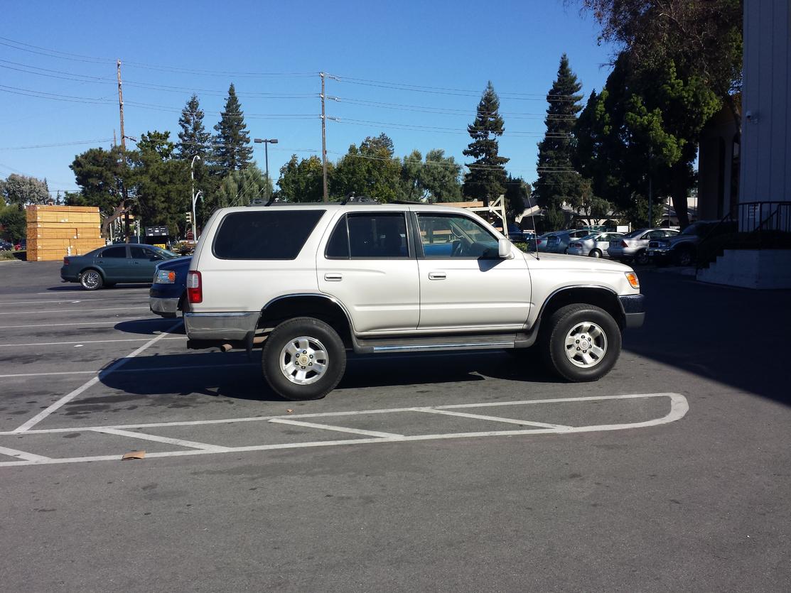

Tons of info on this if you search. I just did the 881/890 lift on mine. No spacers. Just used Bilstein shocks/struts instead. Pretty sure you would be fine unless you need the extra length of some longer shocks. The Bilsteins are a bit longer than stock to better handle lift springs.

What size tires are you running right here?

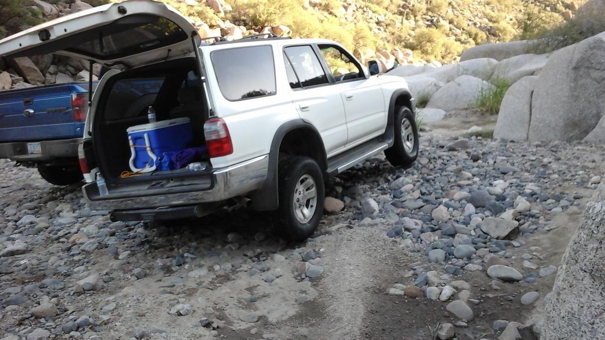

Hey my 4runners twin. Yeah i searched on here and google and couod not find a solid answer on if you can use stock rear shocks. After a little more searching i did find some info. I guess you cqn but it limits your rear drop a little. For my needs that is fine for a little while not doing crazy crawling. The front diff drop recommended for 881 springs?

I'd be a little skeptical keeping stock length shocks on the rear with the 890's. It's a pretty good jump in height. Seems the stock size would be stretched pretty far. I would think that might significantly shorten their lifespan. Diff drop is always debatable. It doesn't hurt anything. I have it on my truck. One tip I'll say is be prepared to re-boot your CV's after you lift it, diff drop or not.
