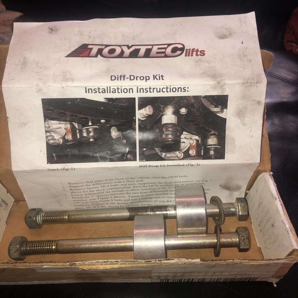

Nice. I find my black springs slightly boring. I pulled my diff drop because I tore 2 more boots with it installed. I now have the TrakMotiv/NAPA HD XL and am happy. I have a used Toytec kit, used but with original box and install sheet if anyone wants it :) $20 shipped.
so you tore it with the diff drop, interesting. Maybe the boot itself just sucks. I saw a video comparing this and the community is split on fact vs myth. If in doubt, just change the boot itself to the extended length style. It shouldn't wear the CV itself more, just the boot from what I've read.
I agree, but 'just changing the boot' is a greasy F'n mess. I'm not doing trails that should require carrying a backup axle (but I have the tools to do it onboard). I could buy a 3rd HD axle to carry but I'm done with the OEM spec ones. If I break an axle I can pull it out and 2WD home. But to clarify: yes, the boots on the 'OEM reman' axles Toyota has sold recently tore happily and quickly with the DD installed with a mild 2" lift. Plus the TrakMotive axles from, say, Rock Auto are a lot cheaper than the Toyota-stickered ones.
