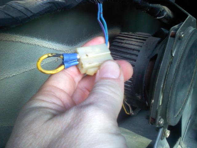

use a boost pack and jump the two terminals on the motor. positive on one side and neg on the other (reverse it to go the other direction)
chances are you are not getting a good ground
behind panel on drivers side near speaker. make a male male jumper wire and plug it in
Hey guys thanks I put the window up and when i get some free time I am going to do what that picture above says. If anyone else has some options and let me know but these 2 responses were perfect. Thanks again and long live the 4runner
