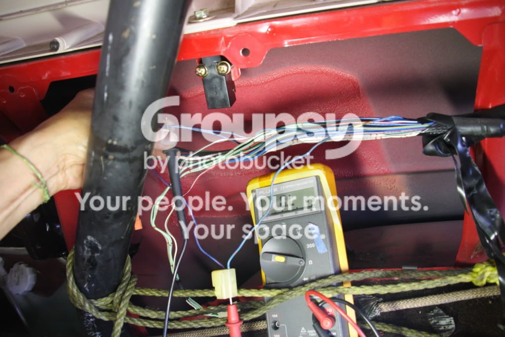

Here's the cover top "B" bolt, just forward of the rollbar diagonal member.
20120819_015.jpg~original
Here's location of Cover Top bolt. (Make sure you use the correct length one):
Cover_Top_Bolt_B_zps6916ddb6.jpg~original
*Cover Top bolt or switch does not affect Door Lock or indicator light. However it needs to be on to allow you to cycle the glass.

WEll i put the hold bolts not the tie down bolts back in just like in the picture above tapped the rear glass button up twice and BOOM LIGHT IS OFF! thanks for the help replace the bolt circled in the picture and tap the glass button itll go off.... no shorts no pants LMAO :lol:
