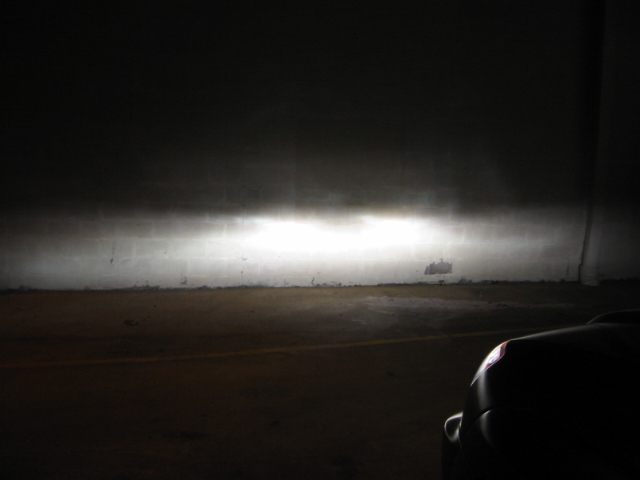

Here is a 2006 Projector headlights with the 4300K kit
<img src="http://toyota-4runner.org/attachment.php?s=&postid=141794">
Here is my 2004 with the 4300K kit

Indeed, Steve will take good care of ya with his products. Adjusting the headlight will be very easy (you'll need an 8mm wrench). Just give it a few rotations and you should be fine. I would test the alignment by parking next to a long wall so you can see the cut off line and use that as a good reference point.
Also park behind a sedan and confirm the height of the headlamp rays.
