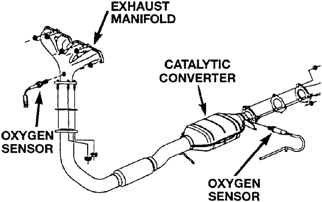

Also can someone post a picture of the cat?

If you follow the pipes for the exhaust, you should see a big can type of thing, with a senor screwed into it, and wires coming out. Probably right under the driver door side.
Thanks for the pictures mate found it and checked it with the local exhaust man, the cat is fine.

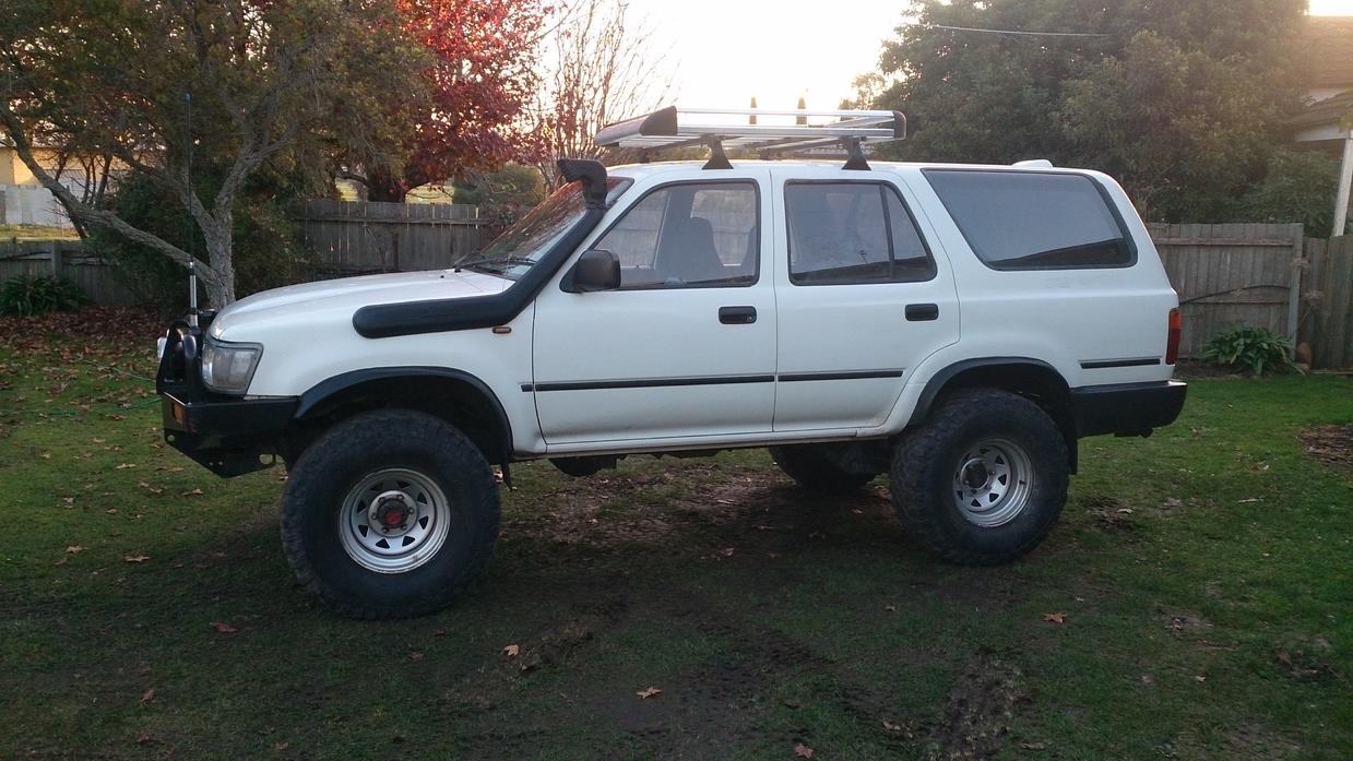

This is my girl just Incas anyones interested. Cheers again guys for the help.
