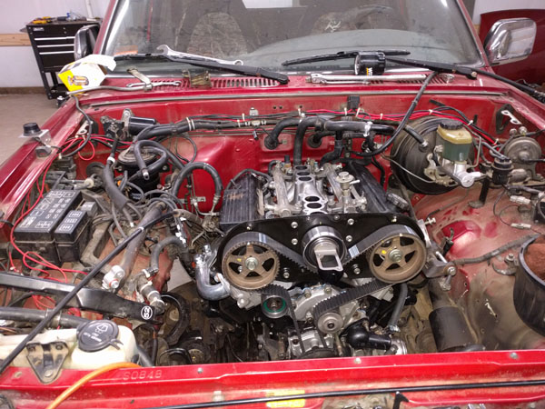

Well, It's that time. In February the engine went, lost the mains. Decidied to go with a long block from Home | Oregon Engine Rebuilders - Sandy, Oregon
Board .020 over and camed, also will get a set of Thorley headers and new exhaust. I need new injectors also as some of them are broke, think I did it taking it apart. Any ideas on what I should put in it for injectors?
It's a 93 all stock other than the 32" BFG's
Thanks for lookin!

Well, I figured out what took out the crank bearing. The crankshaft pulley bolt is gone, interesting. Anyone have an extra bolt laying around they're willing to part with or know where to buy a new one?

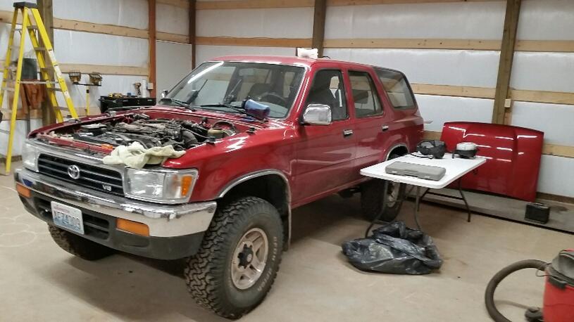

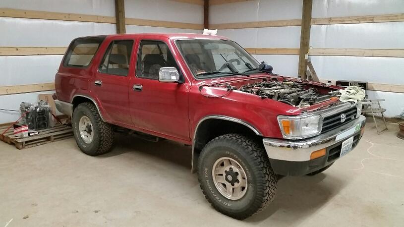

Slowly but surely making progress. The body lift showed up yesterday and if all goes as planning will get installed on Monday. In the process, I have discovered that the harmonic balancer was broken so ordered a new one. Also need to find a new power steering pulley, it was bent up pretty bad. Then to top it all off, I discovered that the bracket that holds the timing belt tensioner spring was completely missing(never there?) so had to order that too. Who know what else I'll need, lol.

Something had to be there to hold the spring on. You might have a hydraulic tensioner.
I pretty much have a running list of parts to order on Rockauto at all times. By the time I finally make an order, I usually think of some other things I should replace and so the next list begins. I also have three vehicles all with over 100K, so they pretty much need constant maintenance.
1" body lift installed, what a difference it makes in the header install.. Would recommend it for anyone doing headers for sure. Still waiting for the rest of my engine parts so I can finish putting it back together. Tomorrow I will finish installing the headers and work on the exhaust. Forgot my phone so no pics :( As for the tensioner, well the spring and bracket was never there and no hydraulic either. Oh well. I've got more money into this thing than I ever wanted to but at least it should last a few hundred k when I'm done.
