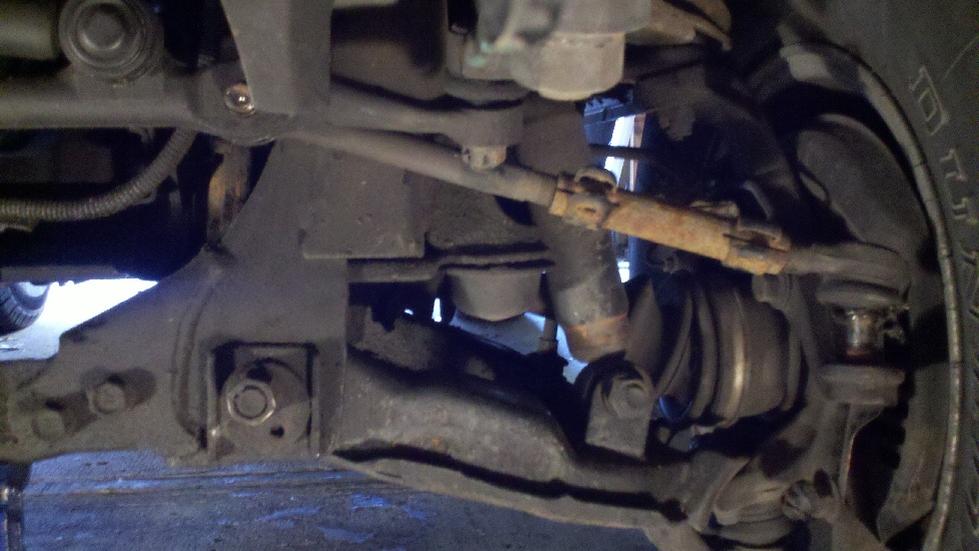

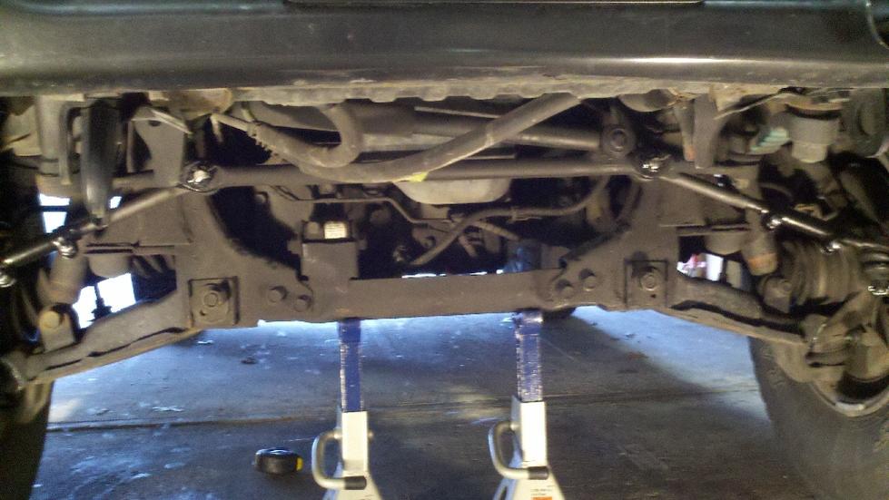

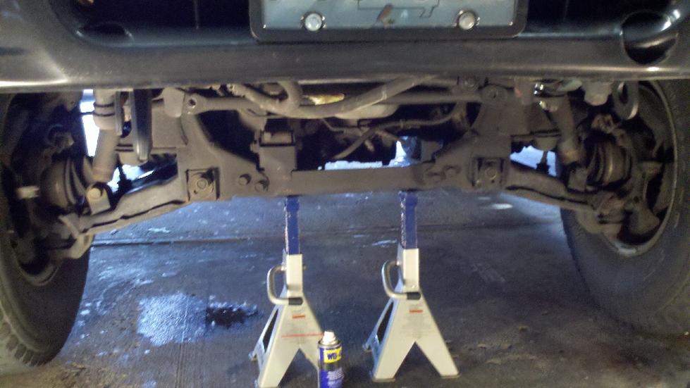

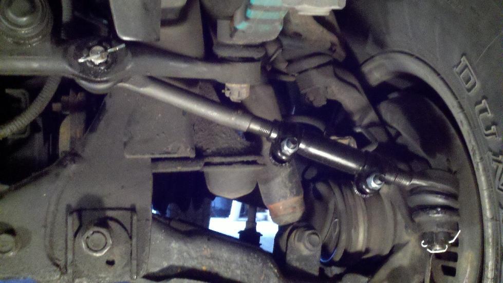

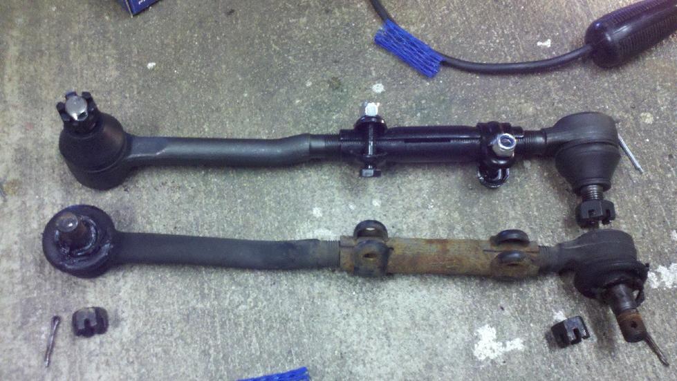

Before and after pics. They really were rusted frozen. I think I spent a total of about $50 all together...would've been about $500 with the jabronies at the stealership :flipoff:
