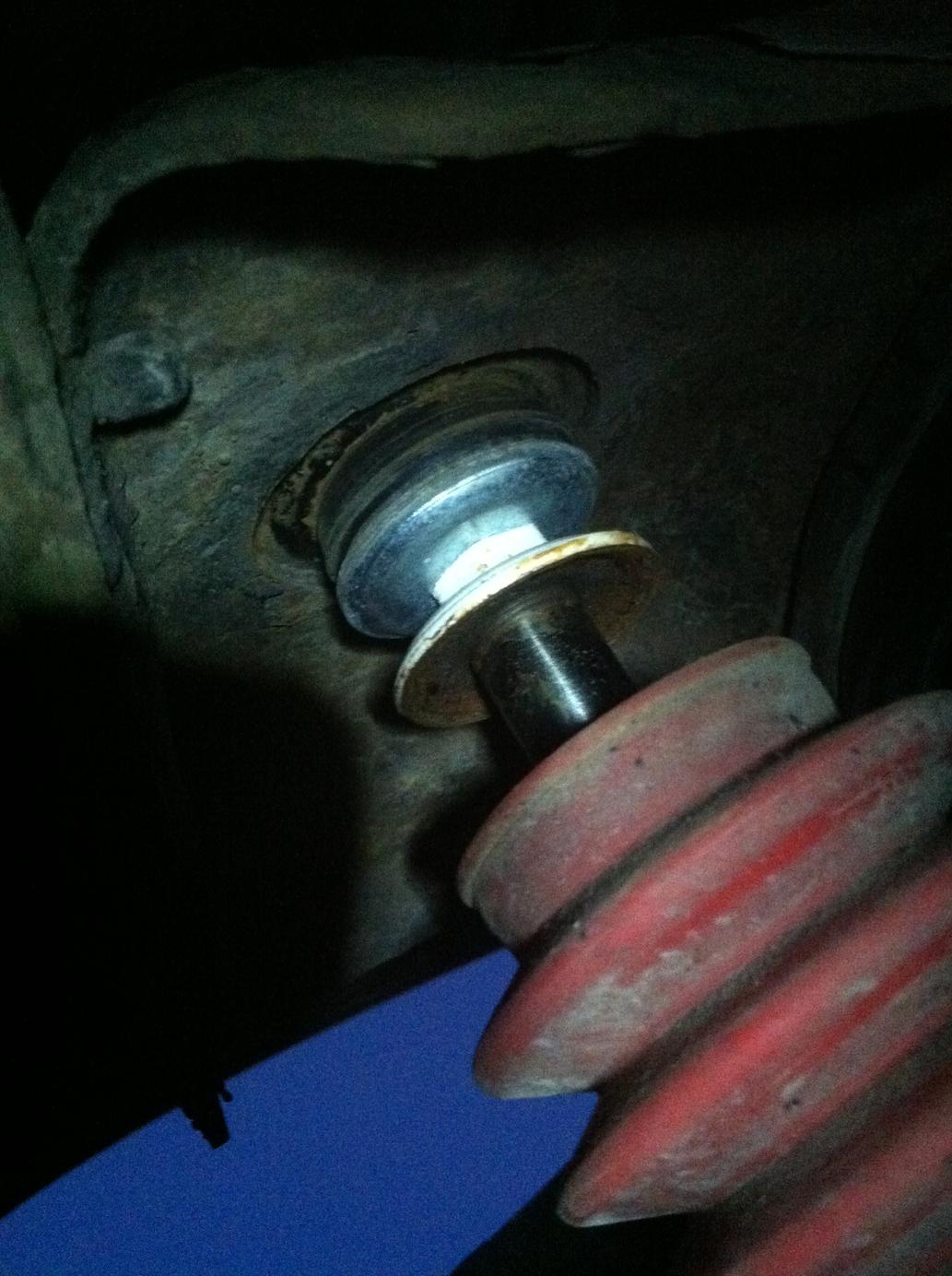

Found a set of four Rancho 5000's off craigslist and only looked at the travel length and they were within the limits I needed so I bought the set of 4 for $100. They were used but still in very good shape. When I got home to put them on, the eyeloops on the bottom where way too small. Called Rancho and they said I need a 3/4" bushing eye loop on the bottom end and a half inch bolt mount on top. They also said I will not be able to switch bushings in these shocks either, so I will need new ones. I currently have RS5187's but need longer shocks due to new FJ coils installed. Can anyone give me a part number that would fit my needs? Ideally I would like somewhere around 15"-25" for the rear shocks. I also am thinking of fabricating a piece of angle iron to make an upper shock mount so I can use a shock with eyeloops on each end? Has anyone done this?

Below are pics of the rear upper shock mount where I plan to weld the fabrication...

The upper mounts on rear 2nd gen 4runner shocks mount like the fronts. They have a bolt with a nut on it, not a through bolt. (see his pic)
You can get an adapter that changes it to run the other style, such as the shocks on 1st gens and Pickups (Not tacoma)
Edit: I re read his post. He wants to make a mount that will let him run the through bolt style, in that case they'll work great!:thumb:
Guys trust me I know. Trying to find a shock with a 3/4" lower eye loop and a 1/2" post mount on top is nearly impossible. Found a set of skyjackers on cl but the guy can't find me a part number. Called skyjacker direct and they said I will need a n8024. So the hunt continues. Probably gonna fab an eye loop for the top. Really opens up my options.
