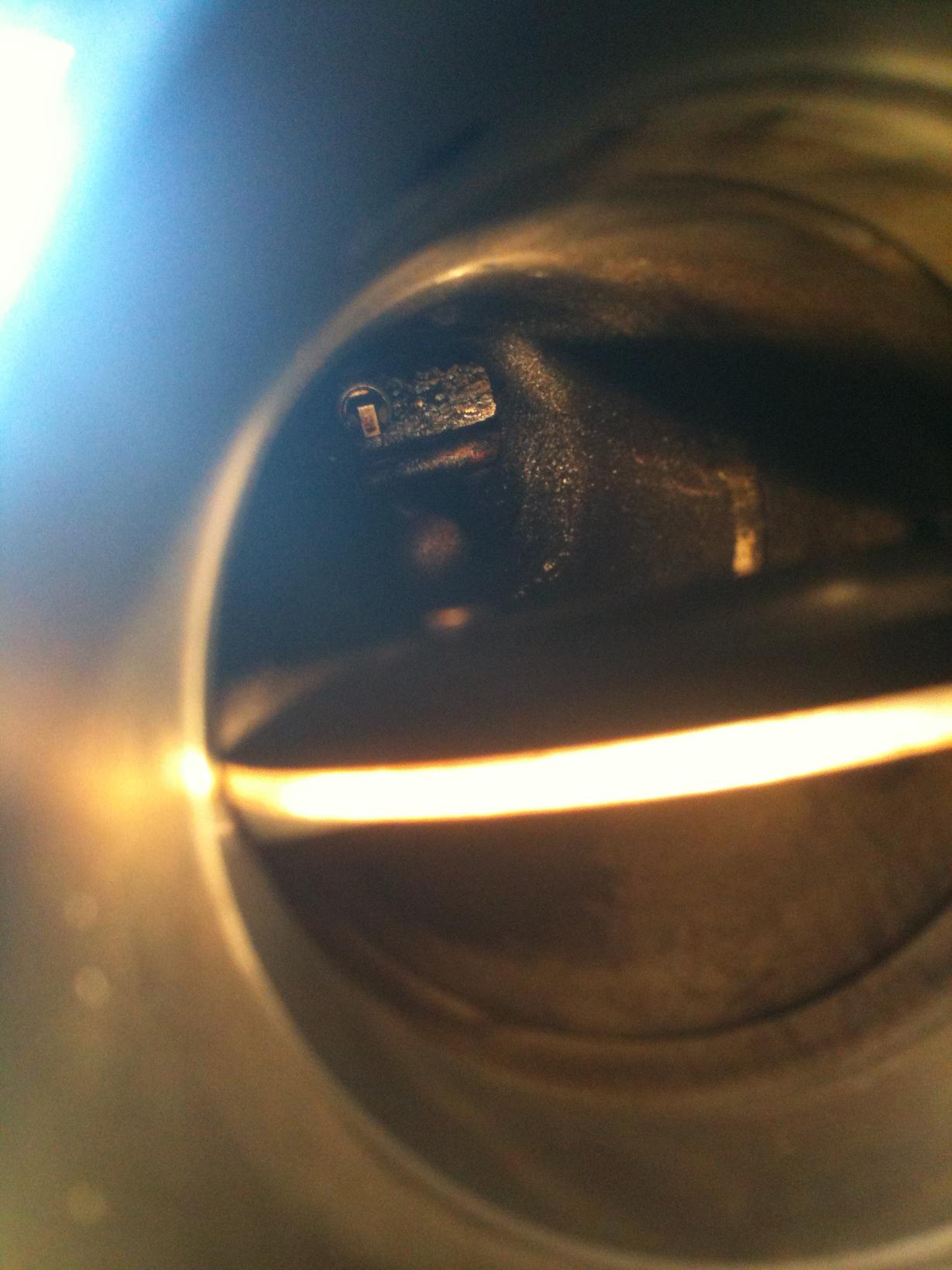

First thing I would have checked is the TPS (Throttle Position Sensor).

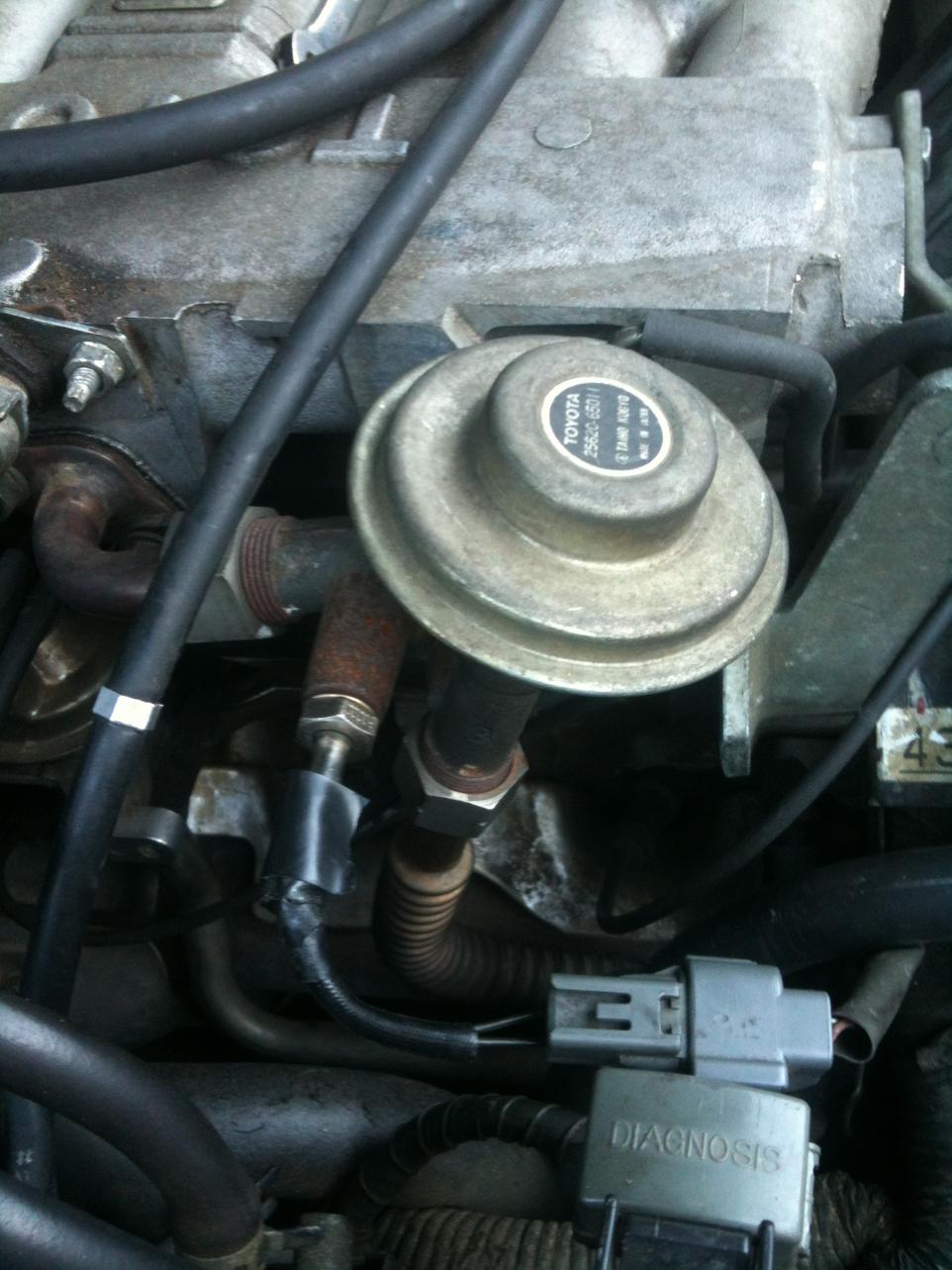

Although it's another problem I suspect because I have also had it, I'd like you to test the EGR. It's the bigger disc thing next to the one that is directly above your power steering fluid reservoir. This one has a vacuum hose on the very top. pull the hose off and block the hose end with a golf tee or a screw (just something to block it off). Go drive it around or let it warm up... in other words, allow it to run under the conditions where it would normally run rough.
If it runs better now, you have another test to make. Again, a vacuum hand pump (or gauge this time) will be beneficial. This is to see if the VSV (vacuum switching valve) is failing and applying vacuum to the egr when it shouldn't be. If it doesn't pull vacuum... your egr could be stuck open. To test this, simply apply vacuum to the port on the egr and note if a change in running condition is made or not. If you don't have the hand pump, there is a capped off vacuum port on the top of the throttle body that you can run a vacuum hose from.

Been there, done that. It ran fine for a few hours but it came back so either the EGR is just bad so of course the truck wont change or its not it which makes me wonder why it threw the code for it. I took the bolt out already since it didnt change.

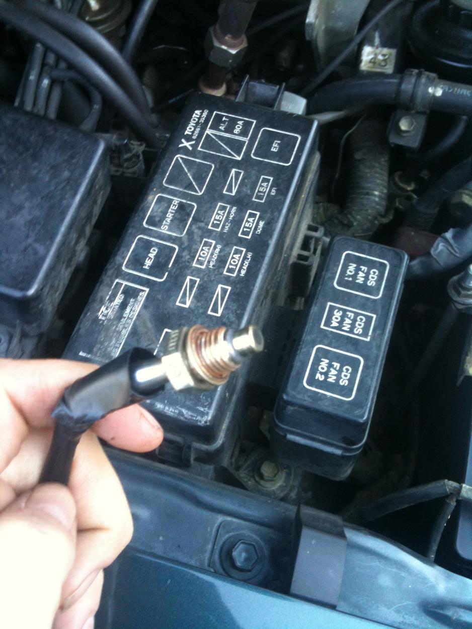

Wish I read this before I went to the garage, I took off the EGR sensor and its clean, heres a photo from this morning. The tape is where the protective netting is coming off, the wires look good, no kinks or creases or wear spots. Going to pull a plug now.

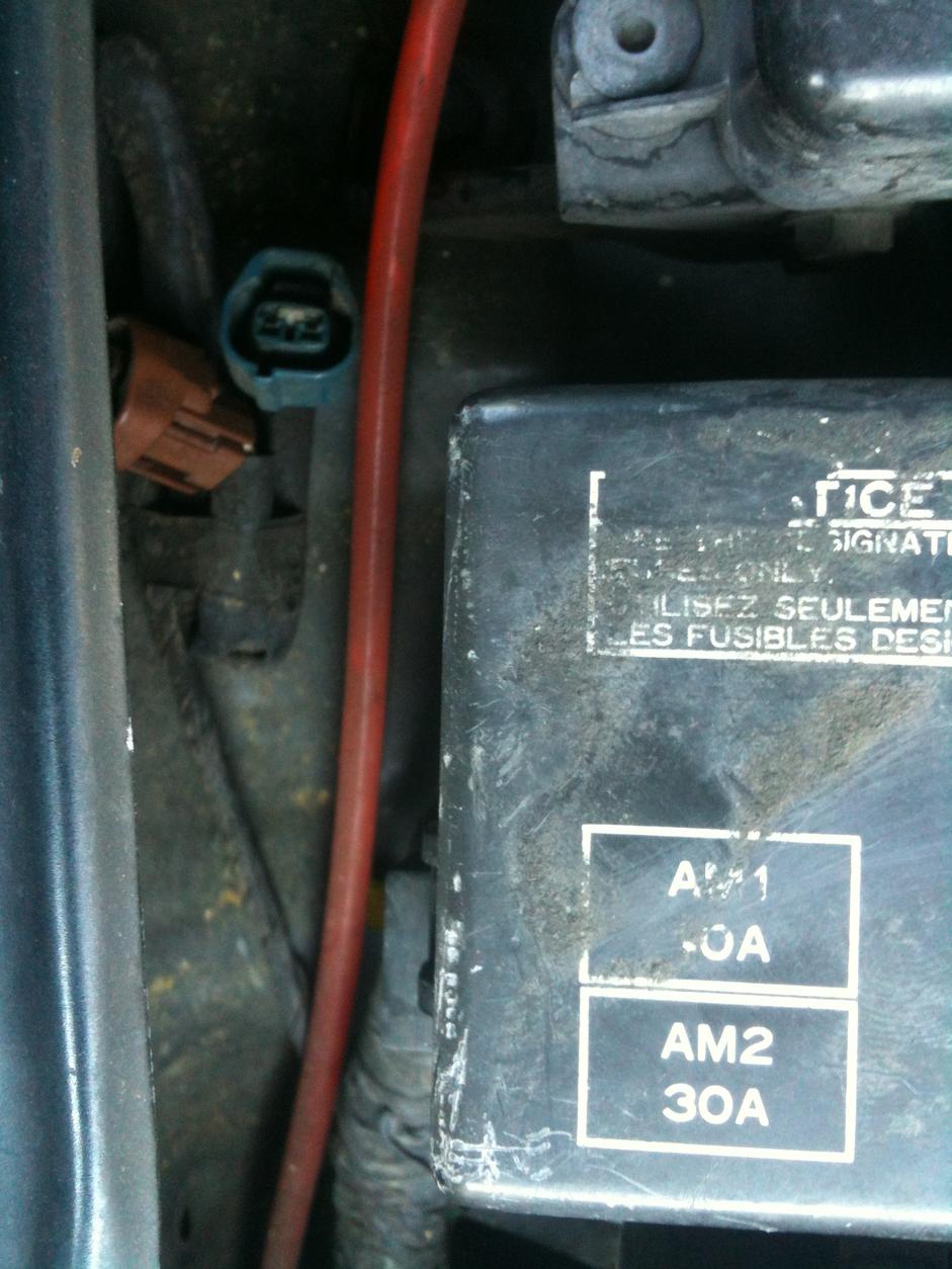

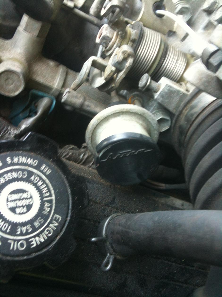

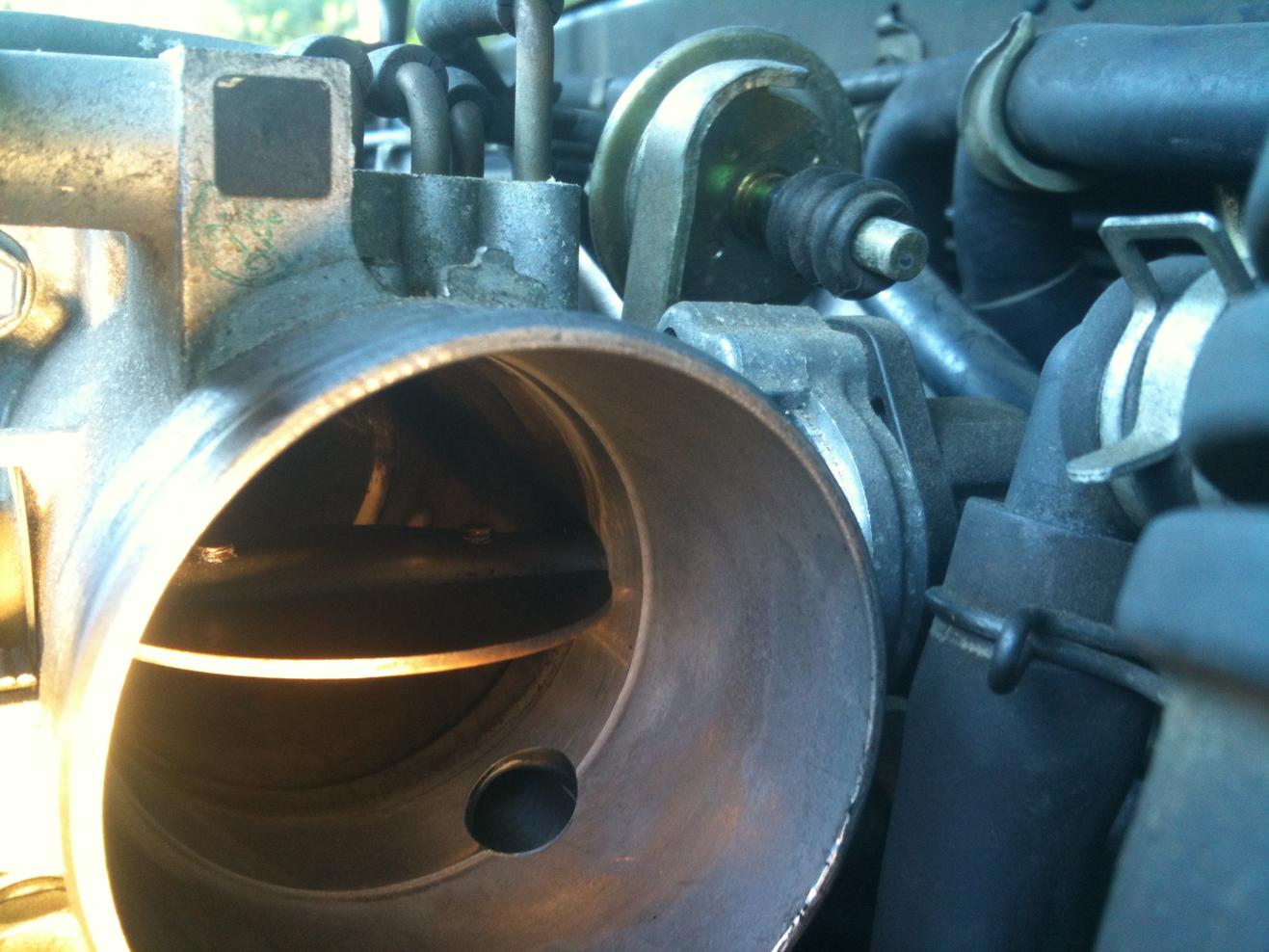

Cant take the plug out, hubby took his tools w him to work today so took some photos around the motor as I went through some old treads. Curious on the 2 open connectors next to the fender and the cracked black cap by the oil cap. Sorry for the size of the first photo :wow2:
