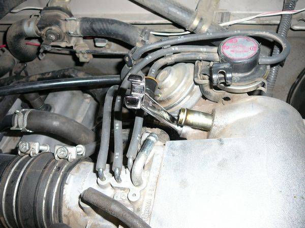

It's this dinky little valve on the back of the intake manifold on the RZ motors (The silver one, directly under the black valve). All 3RZ and 2RZ's had it. Exhaust side is just a small 2 bolt flange on the back side of the exhaust manifold. It's not a complex or detrimental system at all on our motors like it is to the modern diesels, just a way to slightly reduce emissions.
