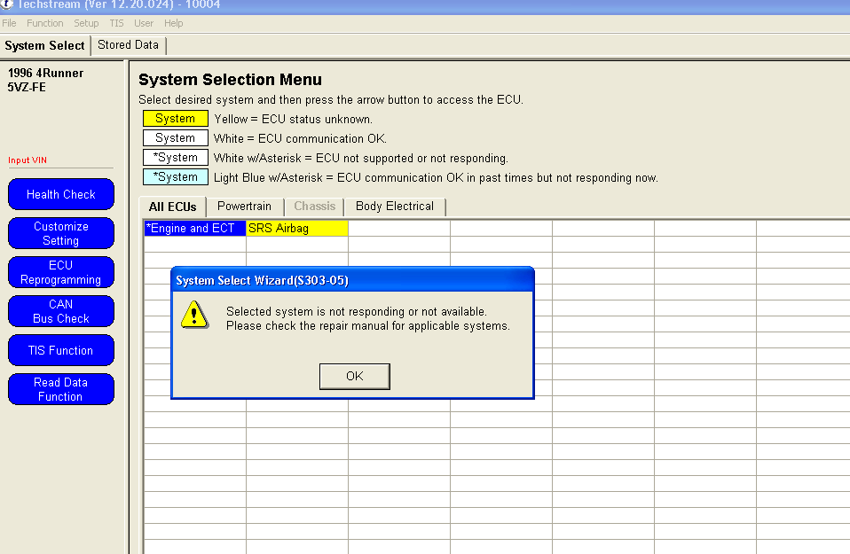

I tested with a bluetooth ELM327 adapter and different apps. Doesn't work at all. I also set SAE J1850VPW as protocol. This adapter worked with lots of others 3th gen 4runners.
Then, I bought this on Amazon:
Mini Vci J2534 Cable Standard Obd2 Communication Interface for TIS Techstream V17 V18 Toyota Lexus Scion OBD2 Scanner Diagnostic USB Vehicle Scan Tool
Spent 2 days getting a virtual machine on my laptop running with some old ass windows and techstream installed.. and it didn't worked.. it shows "ecu not found"
I'd buy another adapter If this solves my problem?

Any scanner I tried wouldn't work, I had to get a reman ECU so the scanner could read it. Working now. * I had to R/R for the state emissions at the time.

Sounds like it is worth opening up your old one to see if there are any bulging/leaking caps...
