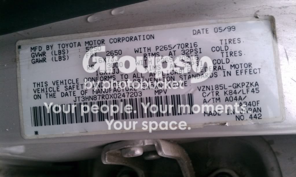

You can call a local toyota dealership and they can tell you. All you need is to look at the data plate in the drivers door jam.
IMAG0232.jpg~original
If you look at the pic above locate the vin # Above the bar code. Supposedly the dealership can look it up with the vin but I have tried with no luck. What they can look up the ratio with is the 4 digit code to the right of the bar code. In the pic above it is A04A. Its the 4 digits after A/TM.
My suggestion is to call atleast 2 maybe 3 dealerships because not all of them are right or know what they are looking at.
^^^ That's been my experience as well. They don't know what they are looking at when I call and ask questions regarding my VIN. I may just have to go ahead and pull the third to count the teeth.
