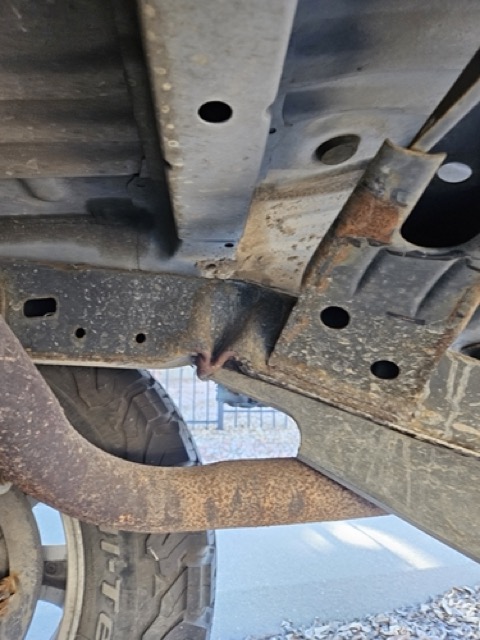

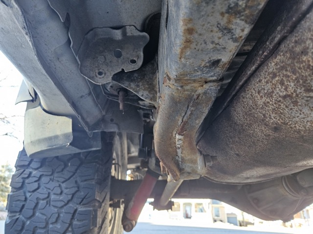

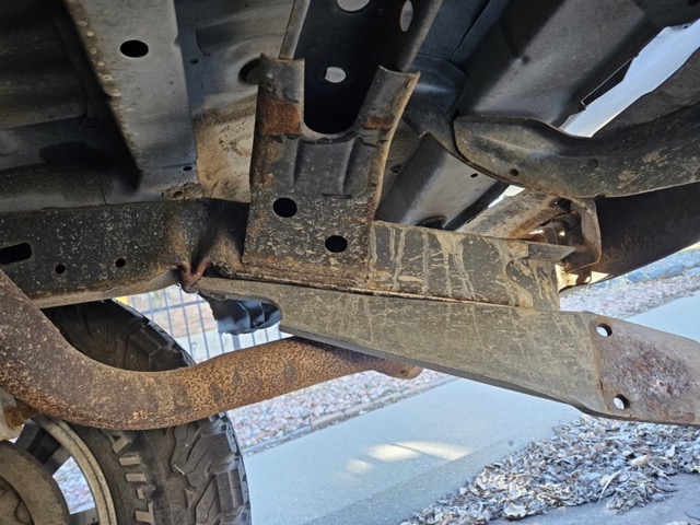

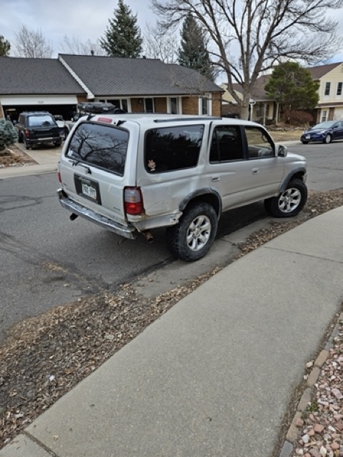

I've got a 96 T4R with manual trans and factory e-locker and 230k miles that I think is a great truck. My son-in-law hit some black ice over on the Western Slope, hopped a curb at highway speed which resulted in the bent frame seen in the pictures. Damage is to the right rear starting just at the connection of that stabilizing bar(?). I don't want to give up on the truck and part it out. I drove it home to Arvada from Grand Junction and it drove just fine. It's clearly not perfect but it made it home without incident. I took it to a frame shop here in Arvada and they just told me they couldn't fix it and handed it back to me. My questions are: does anyone know a shop that would take this straightening on for a reasonable amount of money? or would it make sense to cut the frame and weld on (with additional support) a replacement section?
These particular configuration T4R's are hard to come by which is a key reason I don't want to junk it.
All positive input is welcome.

The body is pretty bent too, I wouldn't repair it. Better suggestion? Find a cheap 2WD and swap everything over. Less total work, and you have the perfect parts truck. You'll need to do a bit of work for MT part of the swap (make sure you start with a matching engine chassis), but it will be way easier and probably cheaper than fixing what you have.
-Charlie
Hot damn that's a kink!
I agree with above. If it was just the frame you could replace it with some square tubing. But the body is seriously tweaked judging by that door and it would be the an extremely expensive nightmare to get it halfway right again. Unless you don't care that much about the body, I know some people like that. A cut-and-patch would probably be the only (reasonable) way of going about it
Finding another for cheap and swapping everything over would be the move; preferably something with a major failure like a burnt out tranny or blown head gasket. Usually when that happens to people they list it for a "get it the hell off my driveway" price. It would be a fair amount of work but nothing compared to straightening everything out - and you'd probably be ahead a solid $10-20,000 at the least
I repair Rusty Frames and I probably would not fix that one. Its a lot of damage. The frame is the easy part to fix. Its the body that's bent as well back to the rear door. The frame would have to be cut out and replaced as well and plated back together. The corner is mangled and probably bent the floor along with all the supports on that side. So when someone would pull it back all that bent area will rust and rot 2 to 3X faster then normal. This is why the other members suggested to put the parts into a non rear end damaged one. :-(
Not to mention, if that section got hit again it would crash a lot worse because all that steel is really severely weakened.
Just sell it and tell the buyer all they need is a little touch-up paint and everything will be fine... and of course 13k min for the diamond in the rough.
Glad no one was hurt, at those speeds and the forces needed to fold the rear down like that it could have been a lot worse.
