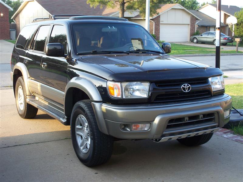

Are you guys saying that the wheels I have on my 4Runner will clear the 231mm brakes with no modificiation? I've been searching for days trying to find a solid answer.

I'm under the impression 16" wheels limit me to 199mm.
I'm not ready to start removing material from the rims.
231s WILL fit theses rims. no grinding required. Ive been running 231s on those rims for over a year now.
