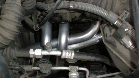

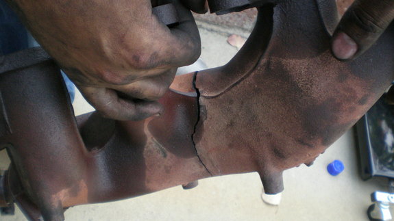

Tilt, the 4 banger isn't bad if you don't mind the diminished power (which it really isn't THAT much slower).
Also, the only 4cyl problem I know of is the exhaust manifold cracking. I replaced my cracked manifold with LC Engineering headers. LC Engineering makes anything you want for the 3RZ-FE 4 cylinder engine, ANYTHING.
See this thread about the exhaust manifold,
OEM mini header install for 2.7L*(Pics)* - YotaTech Forums
No timing belt to worry about, but timing chain... which lasts WAY longer.
Pics from my install:
