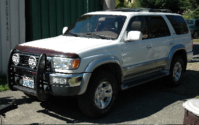

I have a '97 Limited (love it!) and the thing that I want to change is the ass-dragging with any sort of load in the rear.
Three people, 2 dogs and a load of camping gear leaves u with very limited clearance on rear tires-to-fender bits.
I've hear spring spacers may be enough. I don't see call to lift it as most driving is highway.
Open to expert opinions! Thanks - MW
