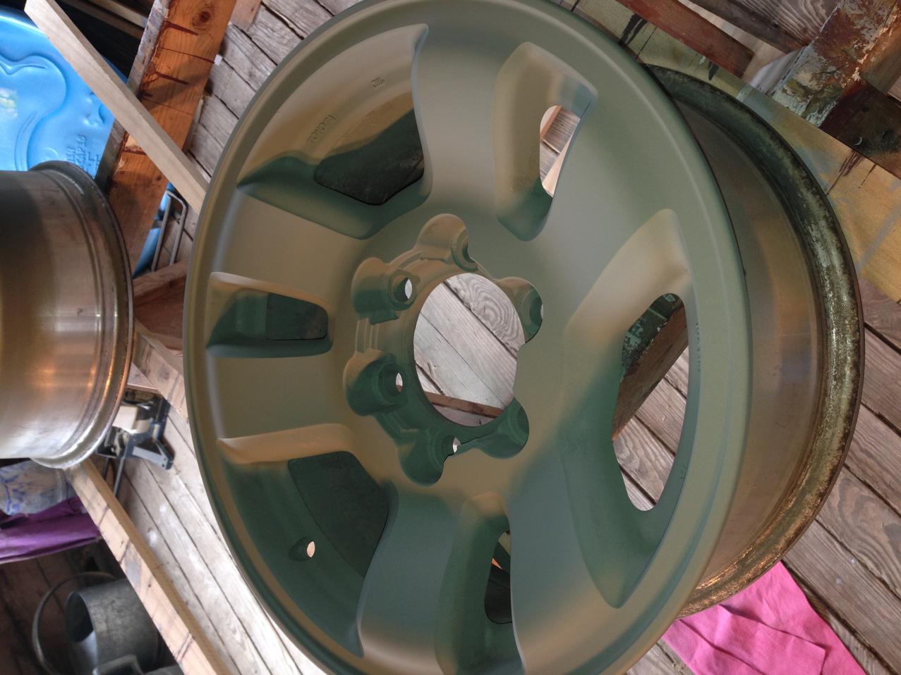

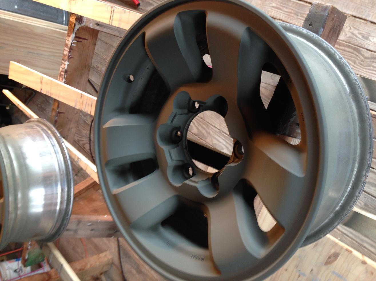

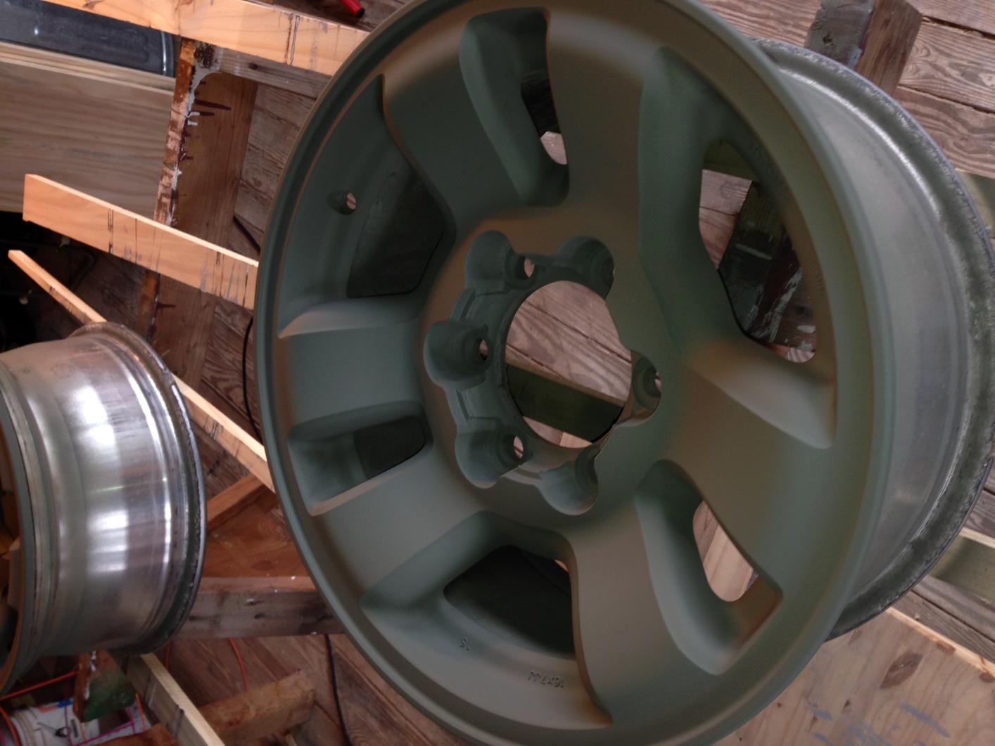

Tomorrow I will start preping the last two wheels for paint and have the local tire shop order another Cooper AT3 to replace the tire that got dammaged in the accident.

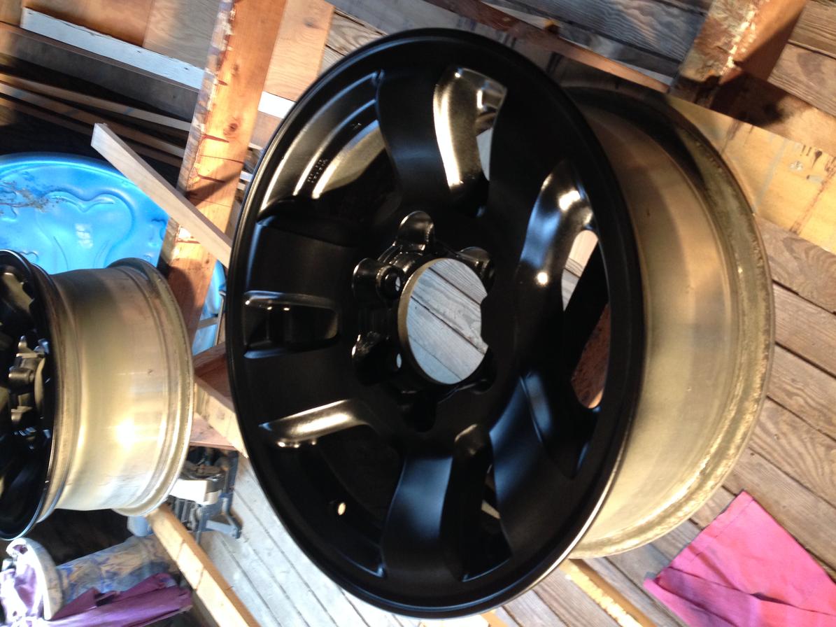

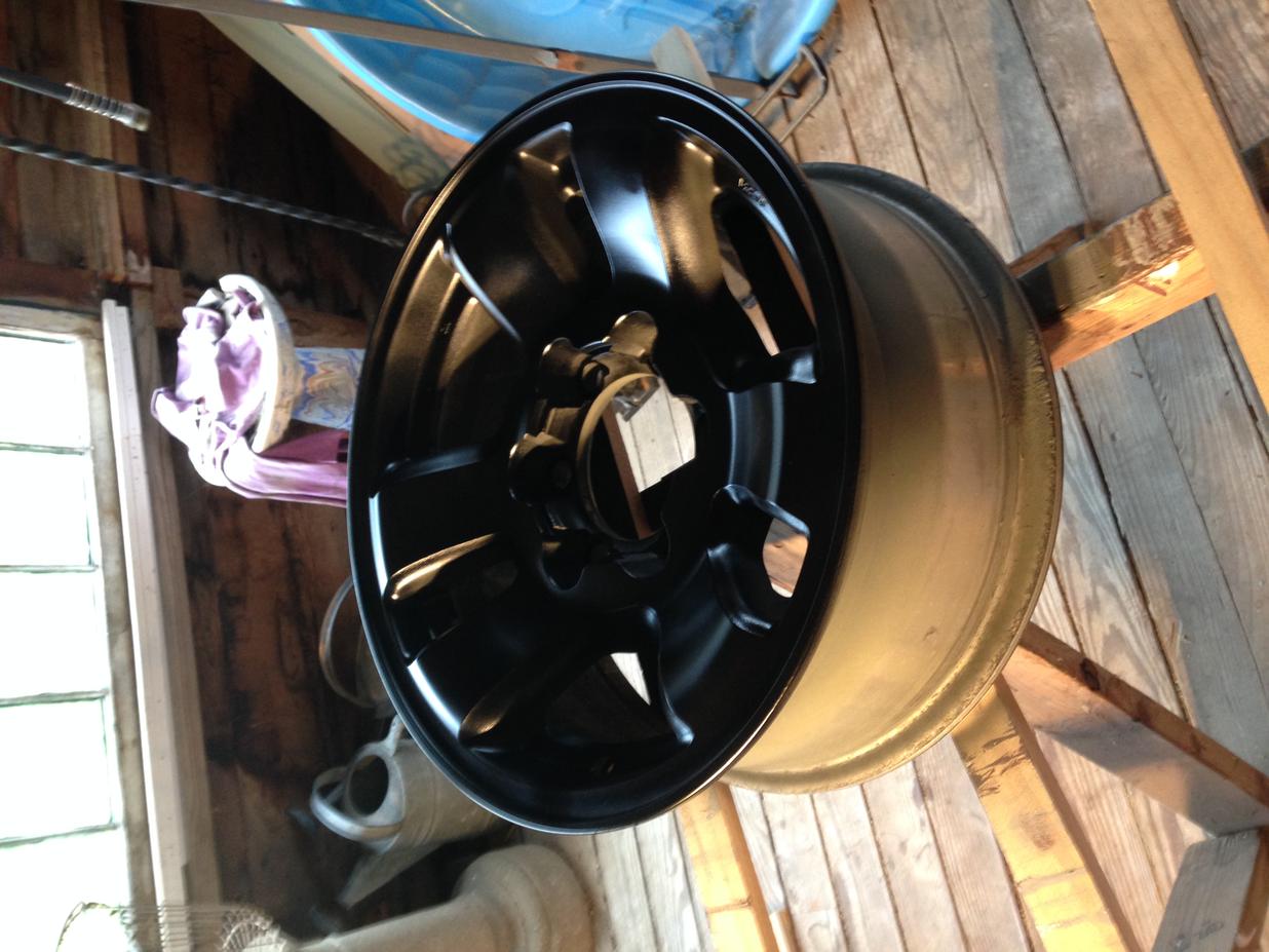

I have a set of rims painted black to put the Cooper AT3 on from the wrecked 96

Got rims and tires swapped over.
