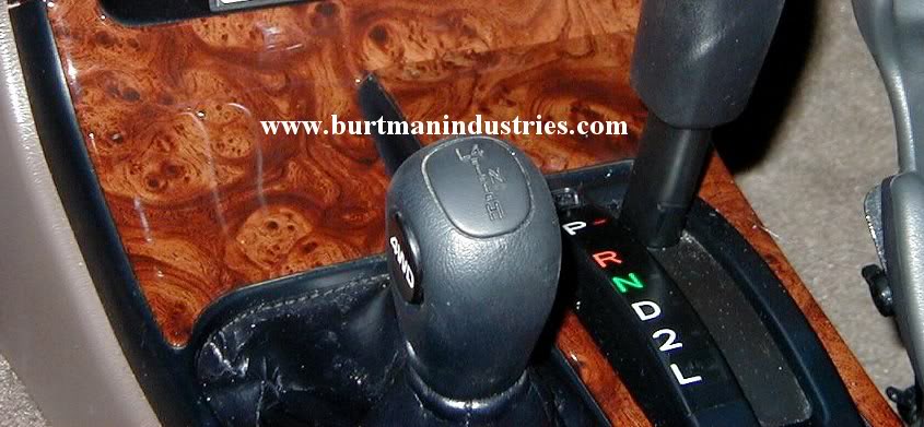

so ur shifter looks like this?
right side shifter is just a regular car, Park, drive, so forth.
left shifter has the 4wd button (engage only below 62mph but I like 10) and also has the hi/lo shift, only can shift from one to the other while right shifter is in park or neutral. Is this how you're doing it? See any lights flashing on dash?
