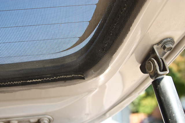

The rear screen:
I need to re-work the sticky velcro that is on the weather stripping. The sticky side doesnt stick very well to the weather stripping and therefore rips off when you try to remove the screen. I tried to Gorilla Glue it in place but that doesnt really work either. Next time I'm at the parts store Im going to pick up some weather seal glue, and that should do the trick.
You can see my velcro is sewn to the screen mesh material:
20111002-IMG_0470 by Headlight Hookup, on Flickr

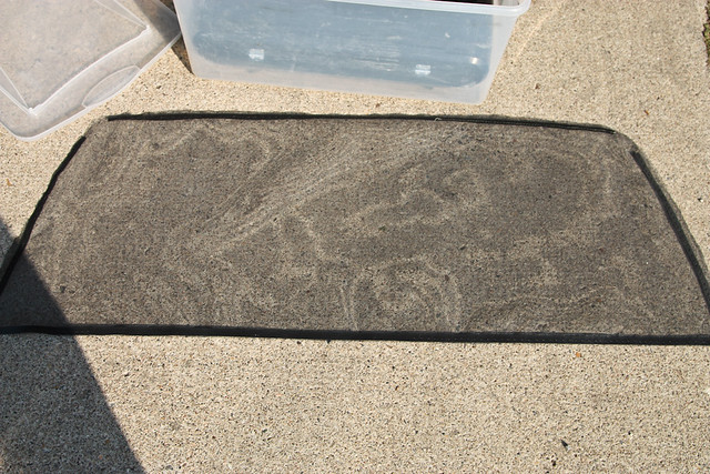

The screen cut-out:
20111002-IMG_0471 by Headlight Hookup, on Flickr

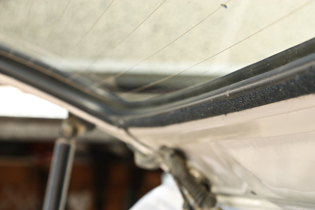

You can see how the velcro just runs along the weather stripping for the rear window:
20111002-IMG_0472 by Headlight Hookup, on Flickr
Wow thats a great idea!
