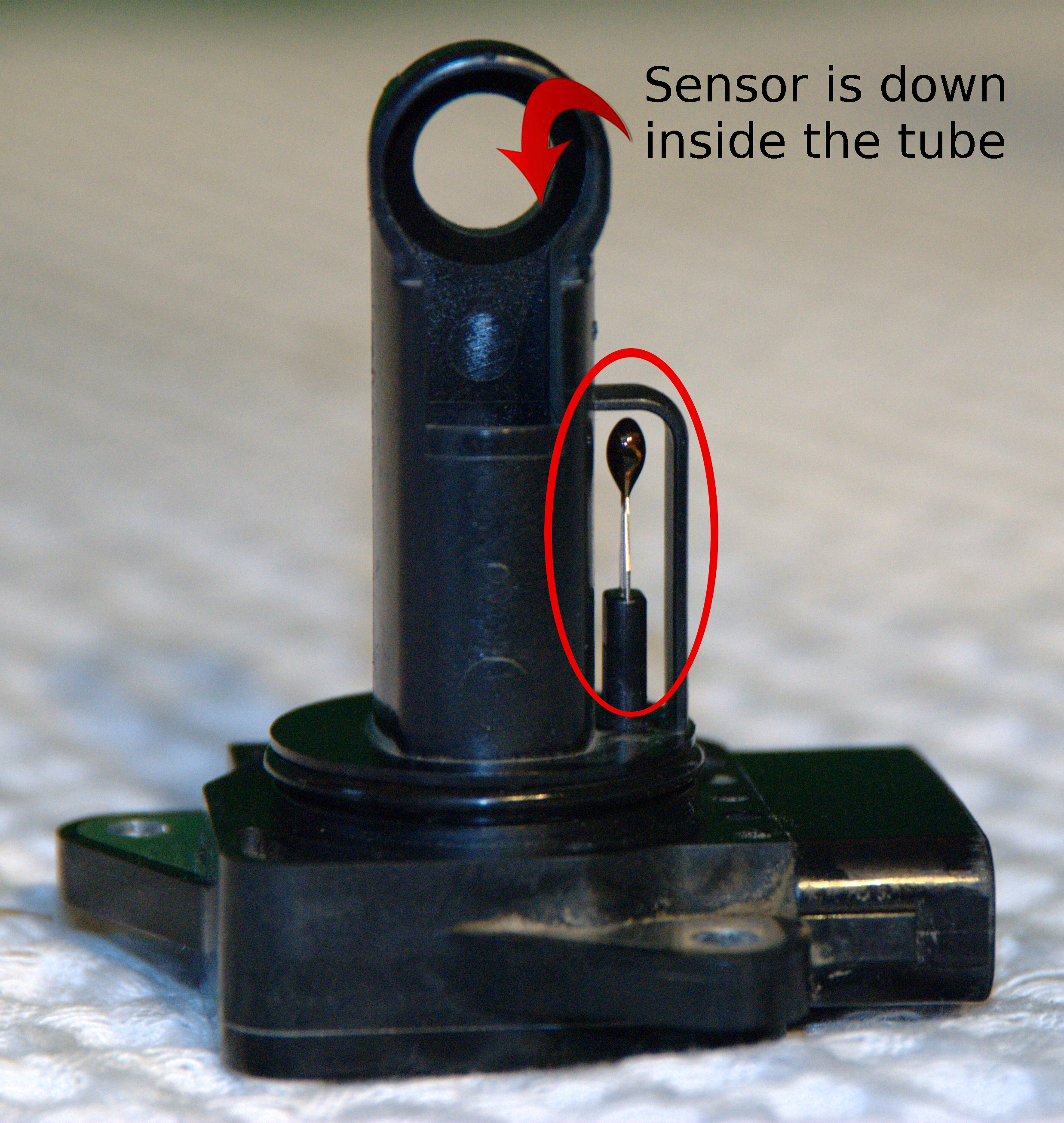

Now, I've removed the MAF sensor and I'm trying to get the oil out of it. I'm thinking I have to be creative since it's a very sensitive part.

It's not the electronics that worries me. The orifice down the middle was full of oil. There's a set of wires down there. Beneath an ounce of motor oil.

Down there, I wouldn't use anything other than air (gently) and MAF cleaner, even if it takes a whole can.
Vehicle was upside down. Tube was full of mobile 1.

So, I applied what I know about electronics to this MAF sensor. With one twist: After the wash and the dry I then cleaned it with CRC Mass Airflow cleaner.
The result: Awesome! Engine purrs like a kitten with no CE light. I'll have it code scanned at the shop Monday but the immediate result seems perfect.
