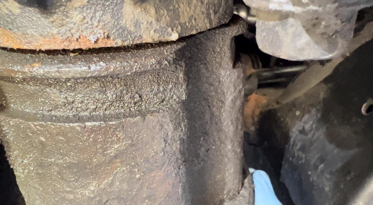

Does the cv axle supposed to have movement? I know the axle itself has slight movement, but what about the cover part that connects to differential? Does this seal tight to diff? I have small gap and slight movement with both .

Yes, mine had about a mil in and out of the diff, none front to back though. Thought they were sloppy because of it. When the boots tore after my lift I replaced them with extended articulation cv's and they had the exact same amount of play. The ECGS bushing took away a tiny bit of that play, but it does exist. I think getting under it while someone else steers is your best bet.

Sounds like an outer CV joint. It's easy to check. The inner or outer joint don't seal tight. You should have about an eighth inch of in and out play. The problem would be lateral play. Grab the axle shaft near each joint and pull and jerk on it real hard. There should be no play.
Last I checked, I have barely any play in the axle itself, but I can pull the cover in and out about 1/8" from where it connects to diff on both sides. I'll try again today and it give it a harder pull.
