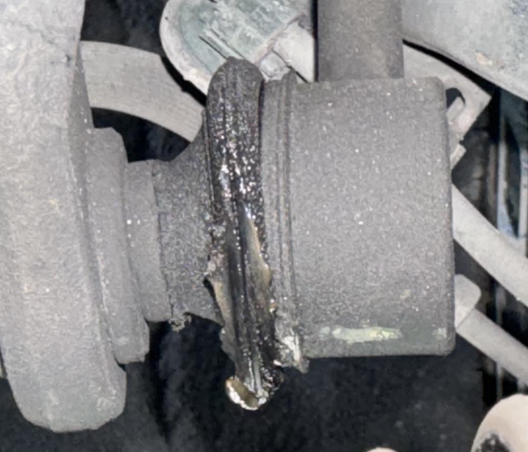

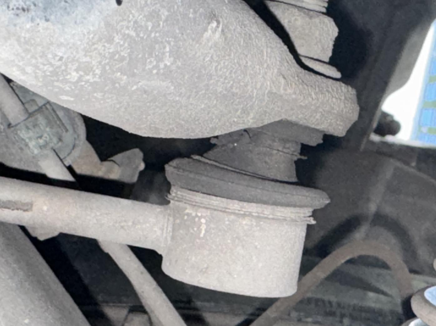

Ok, so I went and looked at my sway bar end links and did not feel any play in them but took a photo of each side and you can see the drivers side appears to have a torn rubber boot with grease coming out. I was not able to lift the truck so not sure if play could only be felt when lifted and not under load.

The suspension needs unloaded to check for any play in their little "ball joints". Because of the unsprung weight of the parts involved I suspect results will be inconclusive.
Wear and tear on sway bar links is probably affected by its lifetime road conditions. What condition were the sway bar bushings that I think you replaced? Did you stick with soft rubber or the harder "poly".
Just ideas that I hope will help.

Ok, finally got the drivers side end link image to load.

Update, replaced both sway bar end links over the weekend and the issue still persist. Still a noticeable clunk on front drivers side.
