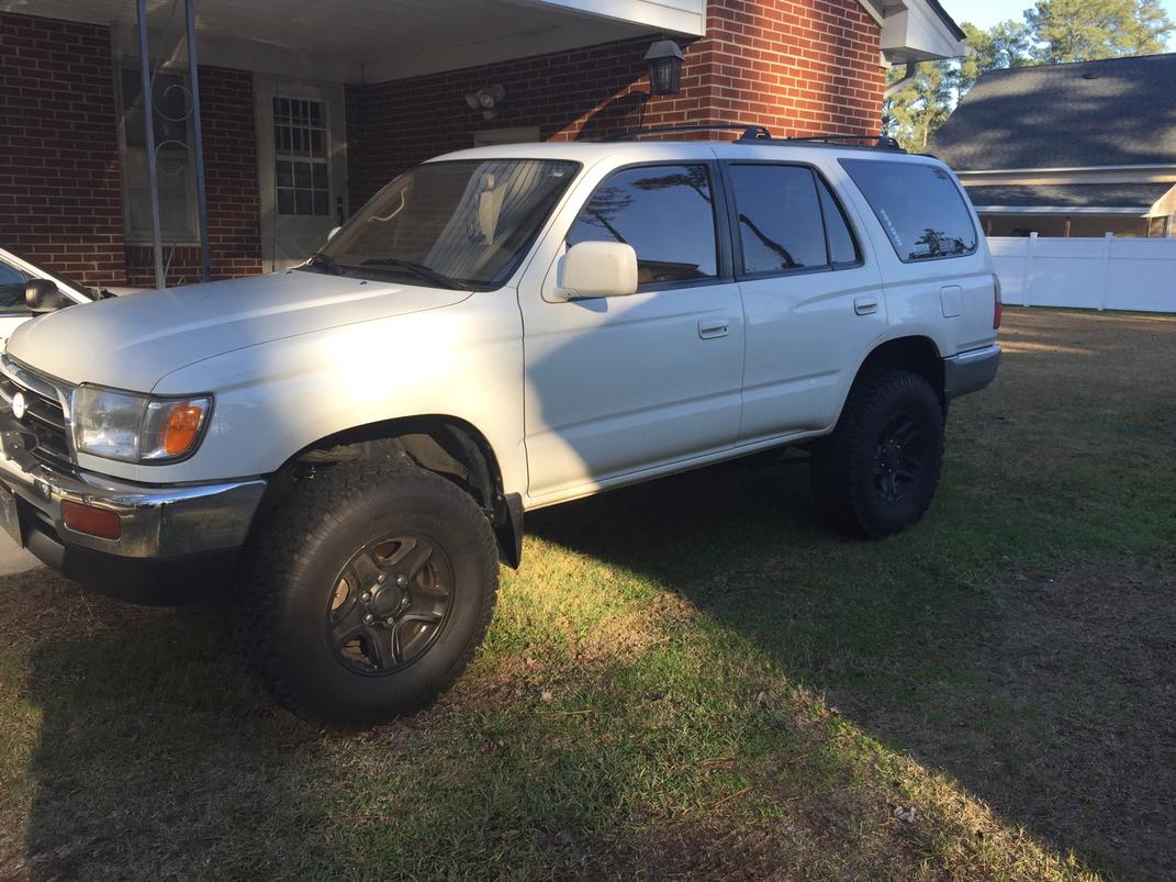

Call Wheelers and speak with Dan, [MENTION=87036]YotaDan[/MENTION]. I wanted a similar setup as what you seem to want and he suggested 881's and 891's with Bilstein 5100's but Tacomas up front. I had wheelers assemble them for me, I would suggest using the second perch on the Tacoma 5100's. I couldn't be happier with the ride or the stance
