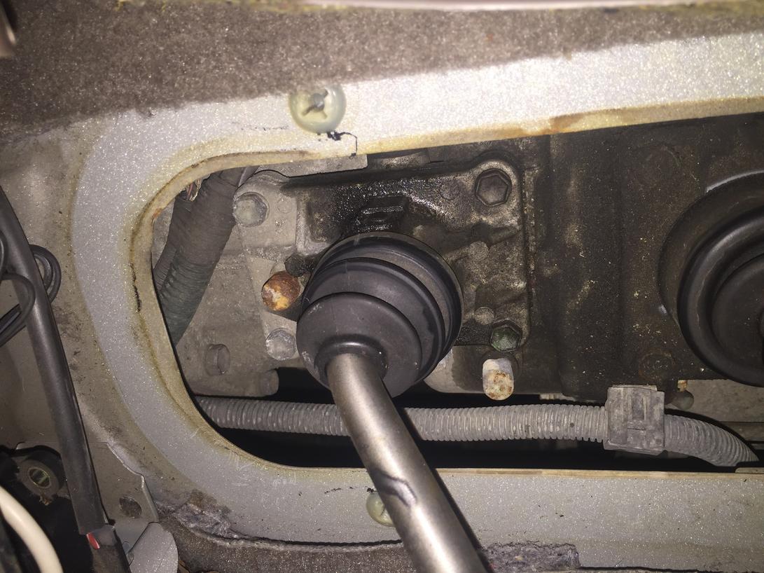

Not sure how to replace these two rusted breathers (see attached photo)
Can't appear to unscrew them, they look cast in.
Basically what made me find this was when I drove uphill for extended periods, i would smell a rubber like smell in the cabin. Couple days later found the oil leaking out of the shifter area.

You should be able to unbolt the 4 on the sides not sure how you want to go about it but I would just throw some RVT on it and put it back together. (Looks to be leaking from the right side of the photo)
