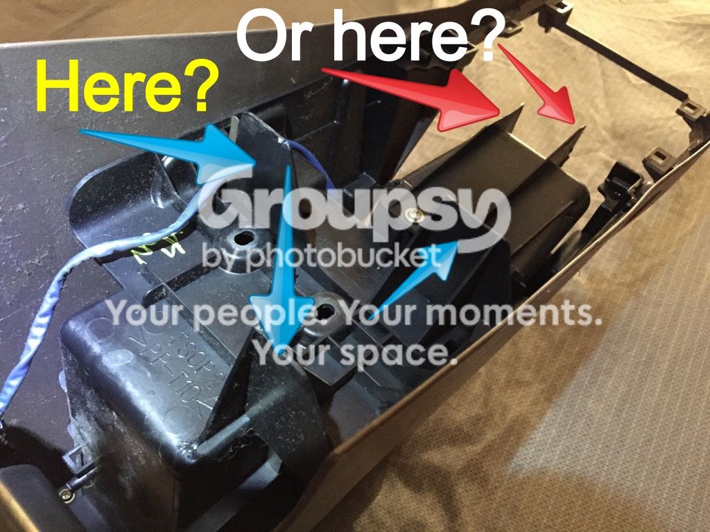

Lastly, for anyone else who has done the console swap, specifically what black plastic pieces need to be cut down on the bottom? And how far do they need to be trimmed?

You also have to swap the parking brake lever, and the mount under the console.
...I'm just reusing my bracket. Not swapping it out. It's my understanding that a few small modifications is all that's needed to make the original sit at the correct angle.
I owned a rusted out 2000 that was my donor vehicle - I could take whatever was needed. Also had to move the rear window, ect switch and RS3000 glass break sensor to the cowl by my left knee.
That's even better.
Looks like you have to cut a piece out of the floor and move the whole e-brake assembly a couple inches to the right? yes?
I'll be re-routing the wiring for the ECT, rear window and alarm to the open slots left of the wheel as well.
I almost grabbed the whole parking break lever and bracket from the junkyard (I actually disassembled it) but then decided I didn't want to pay the junkyard for it when I could mod the existing one, so I left it there.
If I recall, you just unbolt the bracket, then move/bend the bracket to the right and mark the spot where the new hole needs to be — then drill it and use a self threading screw to hold it there.
