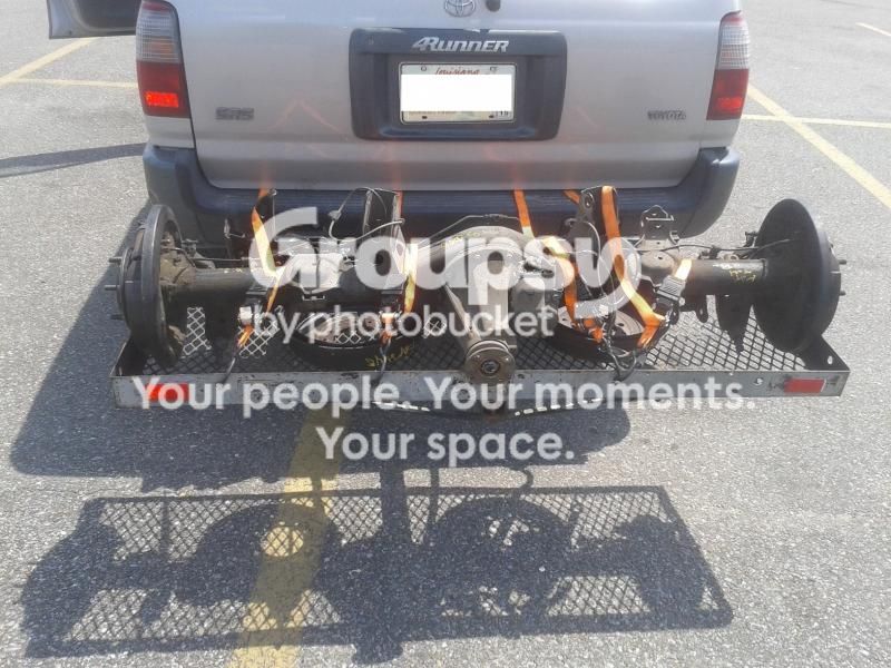

Sound advice right there. I have never pulled a differential before or ever even worked on one. Last week I pulled a front and rear differential out from under a 4runner alone. If you can turn wrenches, you can do this yourself. Hell, I didn't think about it then, but you could drop by your local Lowes and pick up a hired helper for a couple of bucks an hour to help with the lifting. A few fellas always hangout in our Lowes parking lot looking for work. Also, if you get the diff out, the yard should help you move it with a forklift once you drag it to an accessible place. Here is the gem I found last week:
No joke. Me + some wrenches + a few hours. You could easily do the same. You could even just pull the third member.
As others have said though - check the u-joints first. I had one go out and it would make a killer noise at highway speeds.
